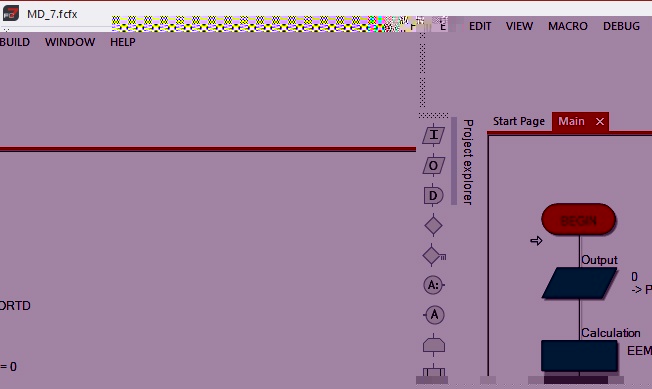

sometimes disappearing panel
or both.
Regards Slava.
or both.
Regards Slava.
- Sav.jpg (35.12 KiB) Viewed 32407 times

I too have the problem you describe
FC7 Build 7.0.0.4
Windows 10 Pro - Ver: 1511
OS Build - 10586.494
Think the problem is FC7 not our computers. We only use what you made available.

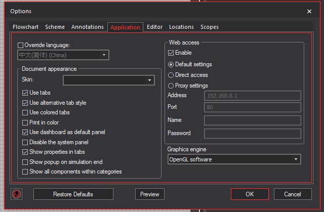

I think I have a solution for the icon's going missing upon saving. I have solved the problem on my PC with the following:
- Open Global options
- Select the menu 'Application'
- Change OpenGL from 'Hardware', to 'Software' as shown below:
Works for me. Hope it helps others.
Dave
Dave

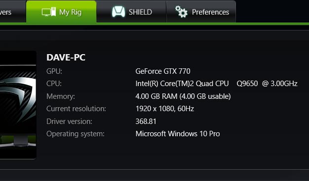

I don't believe it. Everything was working fine. So, I started a new project to test my set up as I had finished the previous project and could not replicate your problem. However, with a new project started, your right, the left-hand side menu keeps disappearing upon doing a save. This is very strange indeed and I am beginning to thing it is an OpenGL driver problem. This is my hardware details:
I have tried to make further changes to my graphic drivers setting without success. Would be interested to know if you are using similar to mine.
Dave

For others curiosity, im having same things happening as Osta/johnsondav and keep sometimes losing all the toolbar icons from the GUI, and i use Nvidia GTX970. What GPU does Steve have?

Thanks for sharing your Graphics hardware details. It has help to suggest my concern that the problem may be to do with the drivers. We'll only know when other give details of their hardware/drivers that does not produce this problem.
