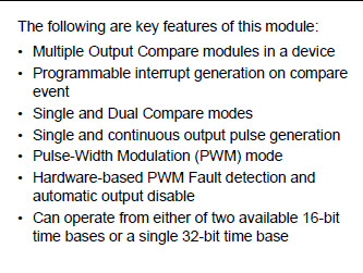

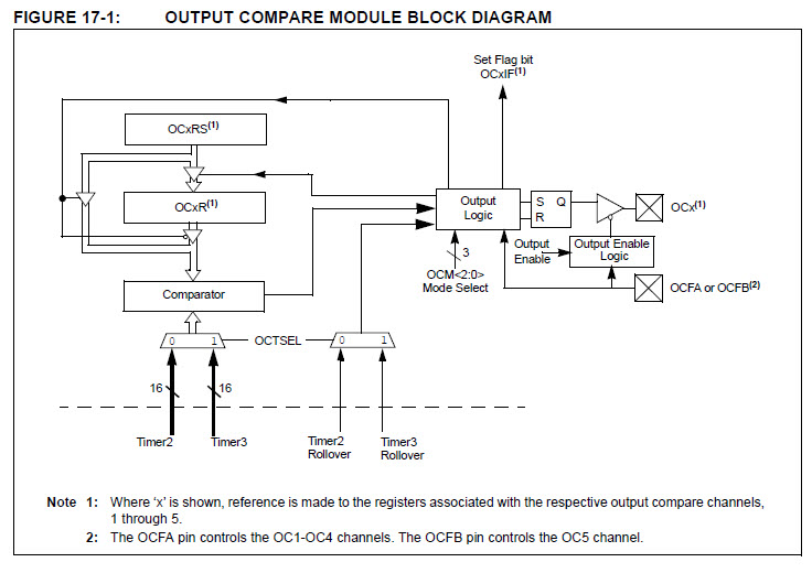

This you will see in the Chip Data sheet and Reference manual for Output Compare module there is no FC component for OC Module you need to use a C icon and do it yourself as the FC Component only support PWM modeWhat is the chip configuration for a stable clock pulse?

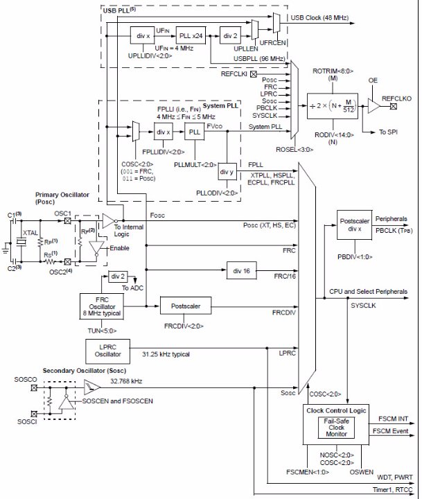

This is hard top answer with out knowing your project as the minimum you can use will depend on the way the OSC is configured and handled in chip HW and what your end Frequency needs to be as you will see in the OSC module print attached there s a few things to calculate]what is the minimum frequency of external crystal
