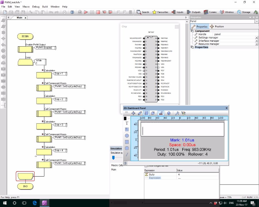

flowcode 6, pic161937
For simplicity and to understand duty cycle behaviour I have created very simple code.
In my code I have set max duty 4. The code works for 1,2,3 but not for max duty 4.
can't understand why and how to get max duty cycle working.
PWM_test.fcfx
(5.41 KiB) Downloaded 420 times
Posts: 9521
Has thanked: 2585 times
Been thanked: 3815 times
Re: PWM max duty not working
Hi wahid,
If you're referring to the simulation, then it's just a bug with the graphics!
Look at the duty value, it shows 100% when set with 4.
If you're interested, you can select
SetDutyCycle10Bit
then you can have x4 resolution.
So 16 = 100% duty
I have move your posts to the V6 Bugs section.
