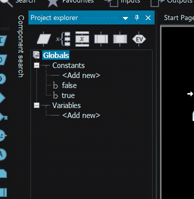

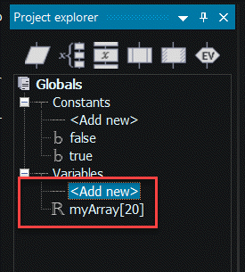

To create an array select the project explorer and select "add new"
The create your variable -Array including the array size etc.
If you select Ok then the Array will show in your project explorer under variable/Globals
Now use you can use a Calculation Icon to initialize the Array to your values you want to place in the Array elements
