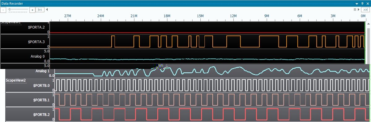

I have done the following steps to run Ghost (ICT) with the example project.
1 ) Opened the project with Flowcode 8 or 7
2 ) Click the compile to chip button on the top toolbar.
This should compile and program, you should end up with this in the compiler messages window.
4 ) Click the third ghost icon that is a Ghost with a * underneath
5 ) Click OK
6 ) Click the second ghost icon that is a Ghost with ICT underneath - The ICT LED on the board should light
7 ) Open the data recorder window using the menu View -> Data Recorder
8 ) Analogue and digital data should be filling the data recorder window from the hardware, there should be no significant delay from e.g. turning the pot and seeing the analogue value change on screen.
If analogue values are not working then check that the combo board is connected to Ports A and B and that the DIG/ANA switch is in the ANA position.
Control the zoom using the +/- buttons and slider at the top left of the window.

Re: Gohst with BL0080, BL0114-2
Please could you further explain the issue you are seeing.
Can you give us details about your PC, processor, RAM, USB type etc. Ideally you need to be using at least a USB 2 compliant port.
Is there a significant delay in the time it takes for the event to happen on the H/W to showing on the scope window?the response is too slow and the data is not visible in real time in Scope view. I want to know if I made the wrong settings, or if it is originally slow and monitoring is not real time.
