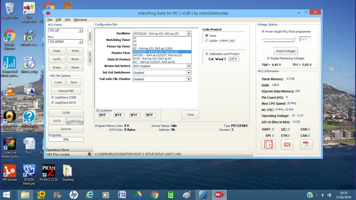

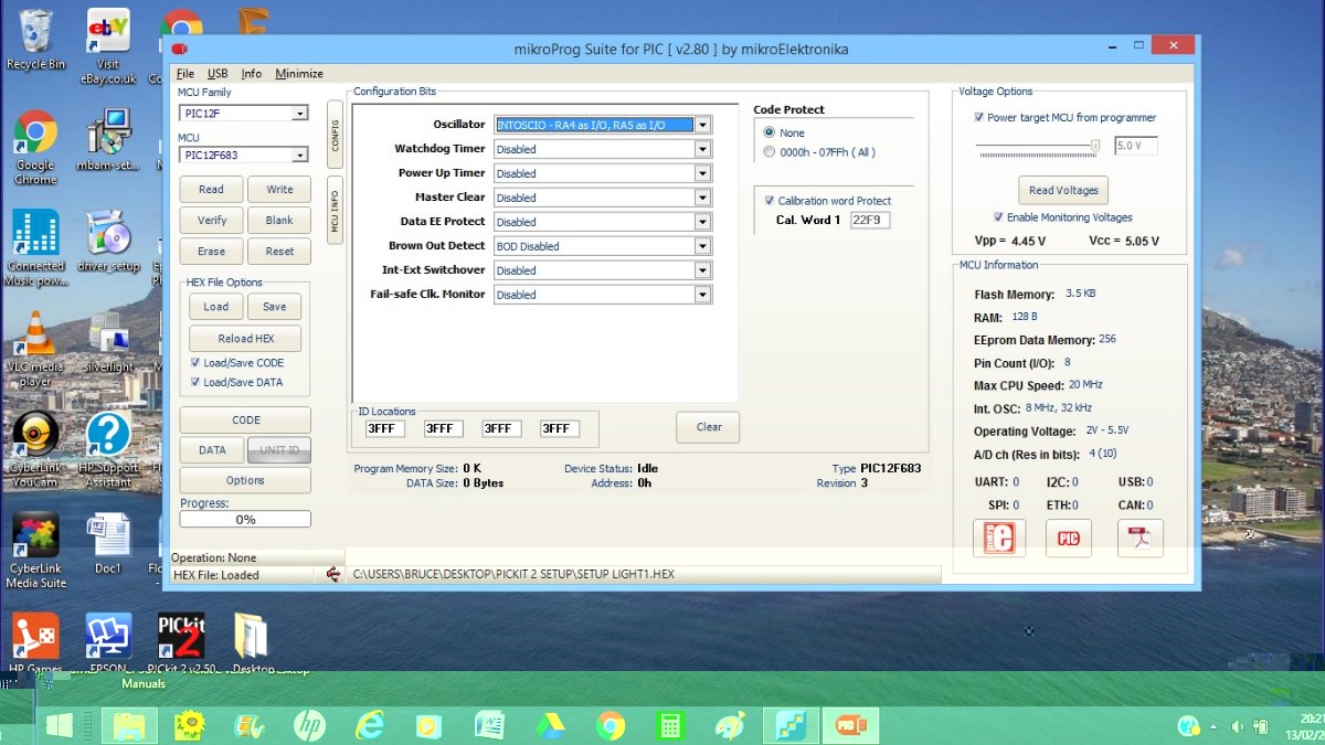

Ok, got mikroprog connected.Would you be kind enough to have a look at the settings for me and point out where i went wrong please.I have not made any changes to the program itself.
Thanks for your help again. John

Hi John,
You do not have to change the configuration settings withing mikroProg Suite.
They will automatically transfer from Flowcode.
The only thing your fcf file will show me is the osc speed and configuration settings.
It will not show your compiler setting as that is personal to your setup and is stored within the registry.
To get you going for now, looking at PIC12F683 datasheet the default internal osc speed is 4MHz.
So change the 20000000 to 4000000.
