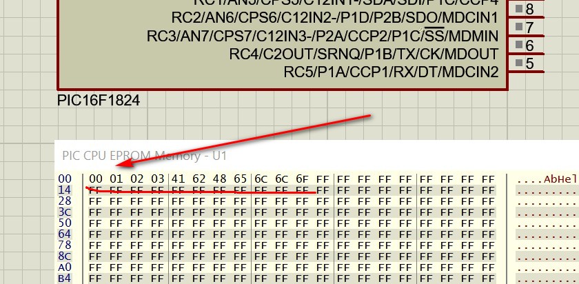

I use PIC16F1824 controller.
I can't write the initial values in EEPROM !!!

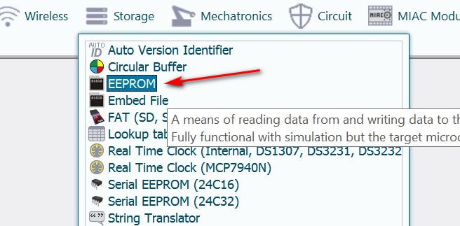

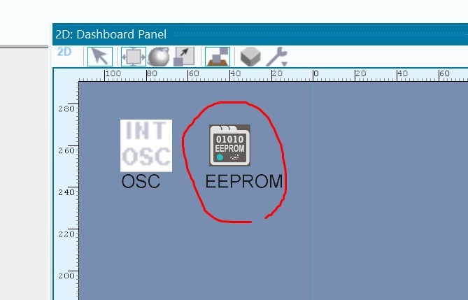

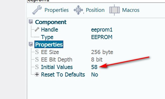

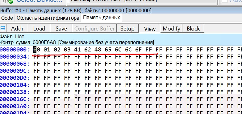

The compiler has the same error

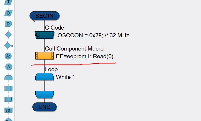

Program
Flowcode 8......
Flowcode 8......
Re: EEPROM problems !!!
Many thanks for letting us know. I believe I have now solved the issues and the latest fixed component should now be available via the update system.

Thank you !
I will try.

It's working !
Thank you !!!!
