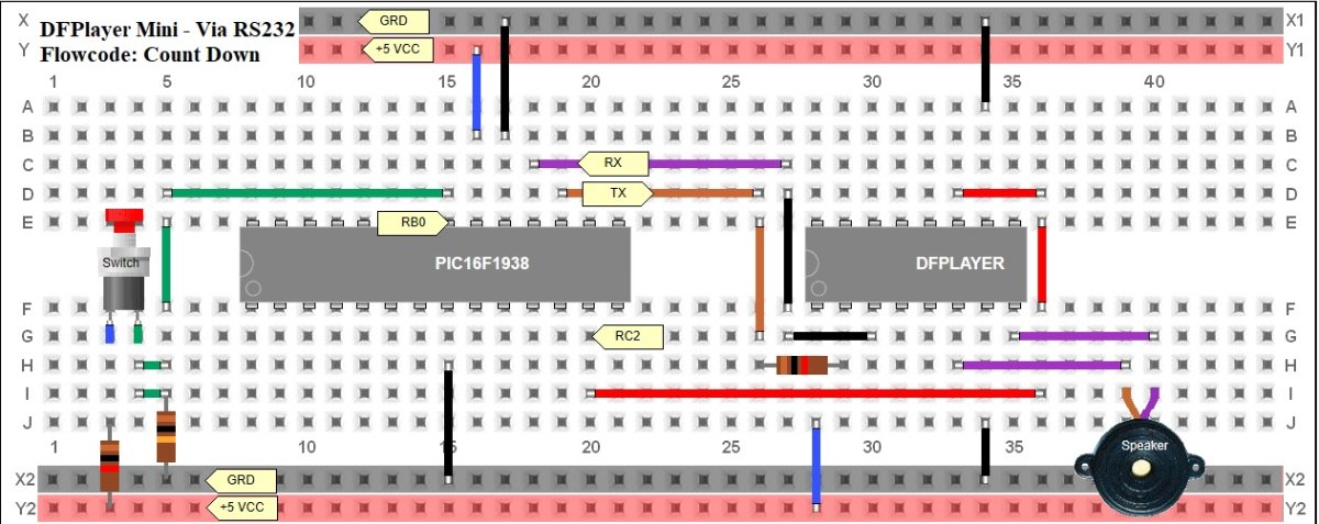

I did the IO_2 via RC3 and it works. I do see something on my digital scope being sent to the DFplayer on TX pins but the Dfplayer does not respond.
On the LCD I see the Version as 255 but the "Count" does not appear. I see the count on the Flowcode Demo.
I'm trying to follow the TX code but I can't find the code the DFplayer needs. Google does not help ??
I found a couple of commands?
0x07E = Stop Command
0x0FF = Version Information
0x0EF = End command
And I think the Low and High Byte is the MP3 file.
I have the MP3 files in the Folder Labeled MP3
When I trigger the IO_2 from RB2 it counts. So the DFplayer and MP3 files work.
I found a program to help show my connections.
My goal is to have the Push Button on RB0 to activate different DFplayer MP3. I cant even get the Busy light to come on. And play just 1 MP3
Thoughts, John

Hi John,
If you look a the DFPlayer datasheet, it will state that all commands start by sending 0x7E.
If you look at your flowchart, within SendBytes macro the send 0x7E has been changed to Receive and 0x7E you supposed to be sending is being used as the Timeout.
You need to change it back!
Same with Versioninfo and the rest that are wrong.
I have mentioned before about doing a 1-sec flash test
If you did you will see the timings will be out as the clock is set to 19660800 Hz (which means URART timings will be way out, stopping DFPlayer from working).
It should be set to the speed of the internal osc i.e 8000000 (8MHz)
The volume command (0x06) is set to 03 which is a low volume level.
Try 15 or higher.
If you correct as many errors as you can.
If still not working if you post updated flowchart, I will take another look.

With hours searching on Google I found a link that got it going.
Looks like my CheckSum was wrong.
This Hex made it work ( 7E,FF,06,03,00,00,01,FE,F7,EF ) it plays digit 1 over and over
This Hex also works ( 7E,FF,06,01,00,00,00,FE,FA,EF ) It goes from 1 - 12 count and then back to 1-12
// 7E FF 06 0F 00 01 01 xx xx EF
// 0 -> 7E is start code
// 1 -> FF is version
// 2 -> 06 is length
// 3 -> 0F is command
// 4 -> 00 is no receive
// 5~6 -> 01 01 is argument
// 7~8 -> checksum = 0 - ( FF+06+0F+00+01+01 )
// 9 -> EF is end code
Now I just have to learn the Checksum formula ( Version + Length + Command + No Receive + Par 1 + Par 2 )

The program I posted automatically calculates the correct checksum for every command.
Is that where you are learning the checksum formula from?

For the check sum I found a link on Google for DFplayer for Arduino an they had the steps but not a clean explanation on how to get the High and low settings.
I downloaded your program and will give it a go.

Hi John,
The high and low number is just a 16bit integer number that has been spilt into two bytes!
If the track you are interested in is track 4 just use:
You don't have to use hex.
If the track you are interested in is track 280 just use:
You can see how the HighByte & LowByte is calculated from this post.
Track number (integer) HighByte LowByte
1 0 1
2 0 2
3 0 3
255 0 255
256 1 0
257 1 1
Commands = 0x12
CommandFeedback = 0x00
Parameter1HighByte = 0//Track number HB
Parameter2LowByte = 4 //Track number LB
Commands = 0x12
Parameter1HighByte = 1//Track number HB
Parameter2LowByte = 24 //Track number LB
