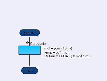

As it is known that the math function fround(x,y) doesn't work for the PIC family, I was wondering if anyone has a recommended workaround for it?
What I do is convert the float to string, then look at a specific character to see if it is above 5 or not, and if so, add the round to the original number.
But it somehow feels awkward this way, there must be a smarter and more elegant method!

How about something like:
Where x is a float argument, y number of digits reqd after the point and temp is an unsigned 32 bit int.
Which will work for float values of limited range (up to a 32 bit integer value when shifted left by the required number of decimal places - which may or may not be helpful?)
Note that this also highlights the fact that floats aren't necessarily exact - try 1.234 to 1 or 2 digits!

Martin, I tried the attached, which should be equivalent to your example, but it does not give what I expected. With an initial value of 1.006 I expect a rounding to 1.01 but I am getting 1.00 . What am I missing?
Jan
