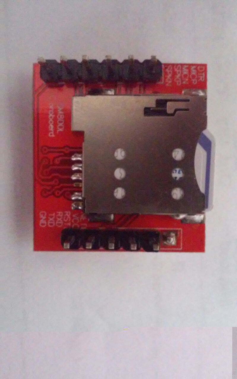

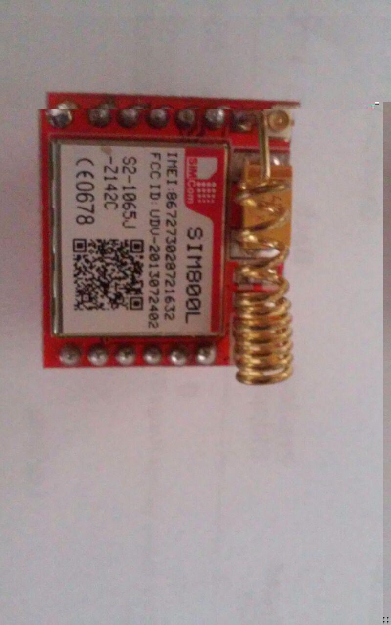

Hello Stuart, I thought it best to open a new topic
http://www.matrixtsl.com/mmforums/viewt ... =50#p77029
Can you please help me with the component SIM800L, as I see you did work; probe with examples published in The Matrix and you posted in the forum but I can not make it work; I'm feeding the PIC and SIM800 with 3.3v, the TX pin SIM800 is connected to C7 and RX pin SIM800 is connected to C6; I am posting a simple example, just that the connection is achieved.
I appreciate if someone could help :?:
Thanks :D
Enrique
SIM800_HOLA_.fcfx
Flowchart
(7.1 KiB) Downloaded 630 times
sim800
(84.19 KiB) Downloaded 2348 times
sim800
(82.21 KiB) Downloaded 2348 times
