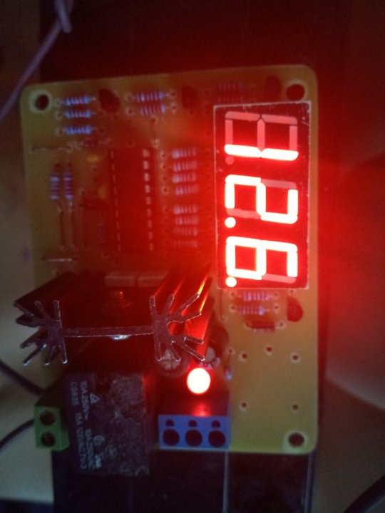

Test5b also displays a decimal point on seg3 which it shouldn't be but anyways I can go with Test5a but my question is coz I have to make another pcb with a bigger chip like the 16F886 for all my code to fit in there question is will have to do the same in 16F886 or there is something to change?

Re: Dc voltmeter 0-55v
Derrihj wrote:Test5b also displays a decimal point on seg3 which it shouldn't be
The decimal point is a nice easy fix.
In the same interrupt macro, you place an output 0>B7 (Clear single bit B7) in the top switch branch (2) for
MPXState
(11.64 KiB) Downloaded 649 times
Derrihj wrote:coz I have to make another pcb with a bigger chip like the 16F886
Why don't you used a 16F1847?
Should be a direct replacement to the 16F88 and it has the same amount of memory as 16F886.
Saves making another PCB!
Derrihj wrote: another thing there is no seg3 in TmrMultiplex macro yet the code works even for seg3 how did u do this?
Yes there is, it's in the same branch as the image.
All 5b is doing is setting the output pins on the ports to be high or low, to make each LED of segments light up at the correct time.
This was only created in case the 7seg components did not work.
Prior to you testing, was all just theory in my head.

Am going to go with Test5a tho Test5B works best it has no half lit LEDs and the decimaal on leg3 is now gone after your changes to clear B7 but it's complicated LEDs are lit very well but for Test5a if you look at seg1 and seg2 for example when it is displaying 12.2v there some LEDs that are slightly lit not so much but doesn't make the display look cool for a low sight person and even the dicimal point on seg3 is half way lit which shouldn't at-all all seg3 LEDs are lit very well with no half way lit LEDs that shouldn't be lit at that time only it's decimal is half way lit.when you display 1 on seg1 only LEDs C and B should be lit but you find that LEDs A , D , E and G are half way lit too which is the same case for seg2 when displaying nunber2 only LEDs A , B , D , E and G should be lit but also led C is half way lit.Am talking about Test5a.and should I do for the decimal on seg3 this time for the Test5a case.Thank you

If the decimal point is lit in seg 3, then place the 0>B7 in the same place as you need to if it was 5b
as for the dim LED's could be 2 reasons.
1 reflection of light from other LED's
2 still looks alight due to persistence of vision.
Have a play with the timer 0 interrupt time and see if that improves things?
I will see if I can improve on 5a, so it might even work in simulation as well.
