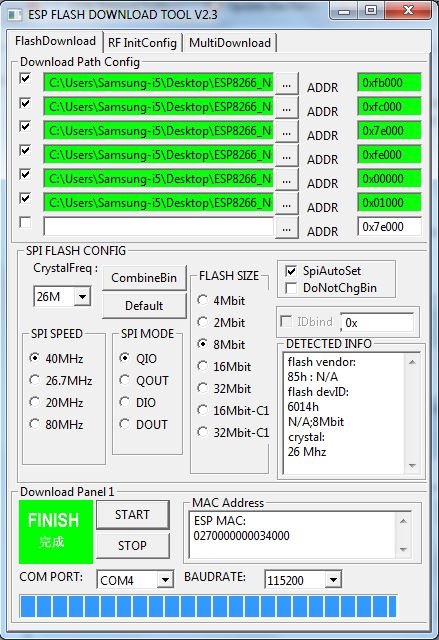

You will need the Flash Download Tool
https://bbs.espressif.com/viewtopic.php?f=57&t=433
and the latest SDK
https://bbs.espressif.com/viewtopic.php?f=46&t=2451
You will also need to create a test circuit that enables you to put the ESP8266 into programming mode, and details are in this little guide to updating.
Update ESP8266 Firmware.pdf
(76.14 KiB) Downloaded 15670 times
Have fun......:)

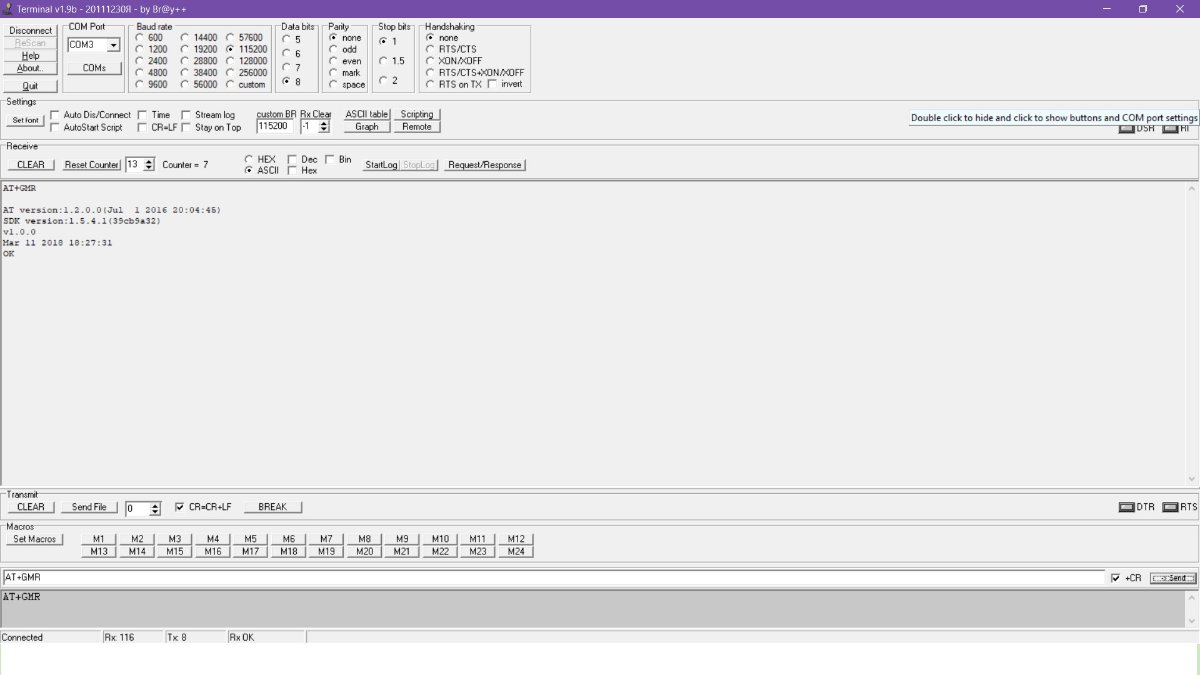

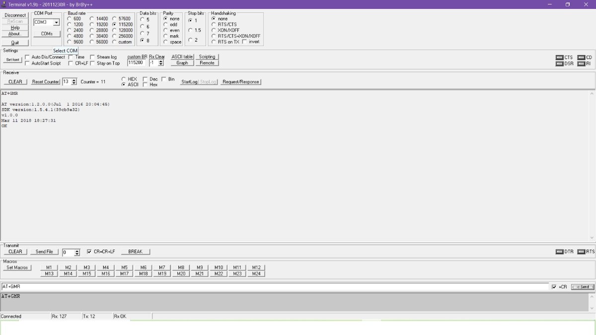

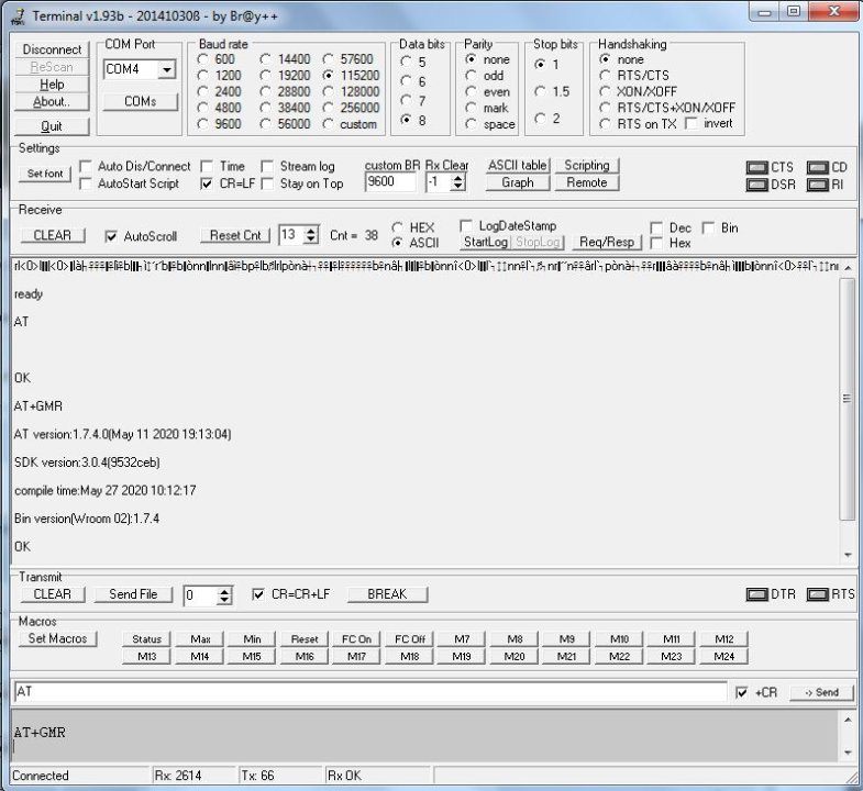

Good evening! So far, I have only checked the firmware version on both modules, it turned out to be the same. I'm working on it.
firmware version of 2 module.jpg (68.33 KiB) Viewed 43095 times
firmware version of 1 module.jpg (67.42 KiB) Viewed 43095 times

I think your firmware is an older version as the latest is
AT = 1.7.4.0
SDK = 3.0.4
Not sure what the differences will be though.

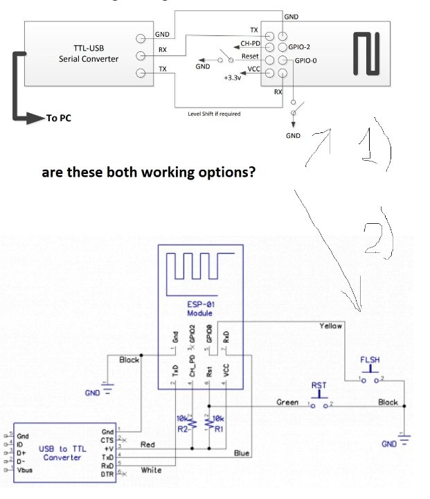

As for the connections, my diagram was as you say just to illustrate what needs to be connected, and is essentially the same as your other diagram. However your board will most likely have the weak-pull ups already in place (the resistors) so you won't need them.
Good to hear you are interacting with the modules without any trouble. They aren't really too scary :)

Good afternoon! Thanks for the information. I will do it according to your scheme.

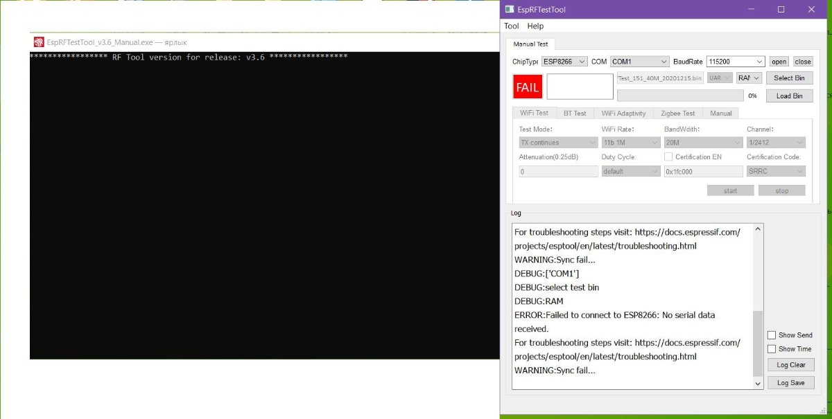

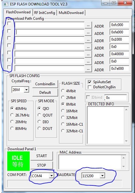

Good evening! I apologize for the significant delay in testing the programs and the response-the work schedule has changed, the time has become less. I soldered and connected the wires on one esp8266 module. I tried to check the passage of the AT command, it stopped responding. Maybe this is normal for this scheme, I do not know. Since there were no instructions other than those links that you gave me, I began to try the method of scientific poking. Then I turned on the flash_download_tool_3.96 program -I tried to press the buttons, the answer was not very diverse: no log file output... I am sending screenshots from the screen, then I tried to run the Esp_RF_TestTool_v3.6 program.There was already a little description, as I understood from the beginning, we set the speed, then select the file for test sending at different speeds and send it. But I have not found anywhere information on deleting the current program and writing a more recent version. Maybe you have the opportunity to explain how to work with programs there.
Maybe these programs are only additional, and the firmware should be changed in another program? What kind of firmware change technology is there at all-just write a new one in place of the old one, or erase the old one from the beginning by writing an empty large file there?(I read it on some forum, but there was a sect of arduinschikov), then the firmware itself. It is unclear when to press which buttons on the real circuit.
If anything, I will be able to read your message on Sunday after 4 p.m.
screenshot from the screen when working with the flash_downloader_tool program.JPG
screenshot from the screen when working with the flash_downloader_tool program.JPG (74.99 KiB) Viewed 42986 times
screenshot from the screen when working with the Esp_RF_TestTool_v3.6 program.JPG
screenshot from the screen when working with the Esp_RF_TestTool_v3.6 program.JPG (70.26 KiB) Viewed 42986 times

The links and the "update" guide should get you going.
I see in your screenshot of the Flash Download Tool you haven't set the paths for the files. It will look for four files as per guide and once you set these, the paths will turn green. Only then can you use it.
Also, you have Com Fail which usually means you haven't set the correct com port that connects to your Serial Adapter.
No idea about the RF Test Tool as I've never used it.

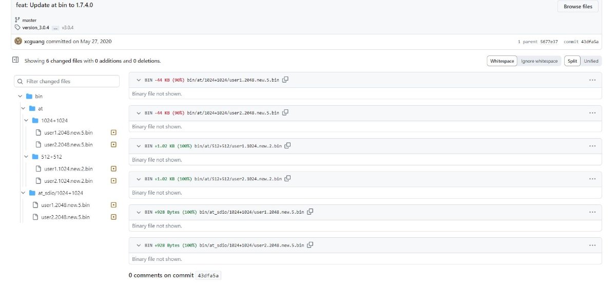

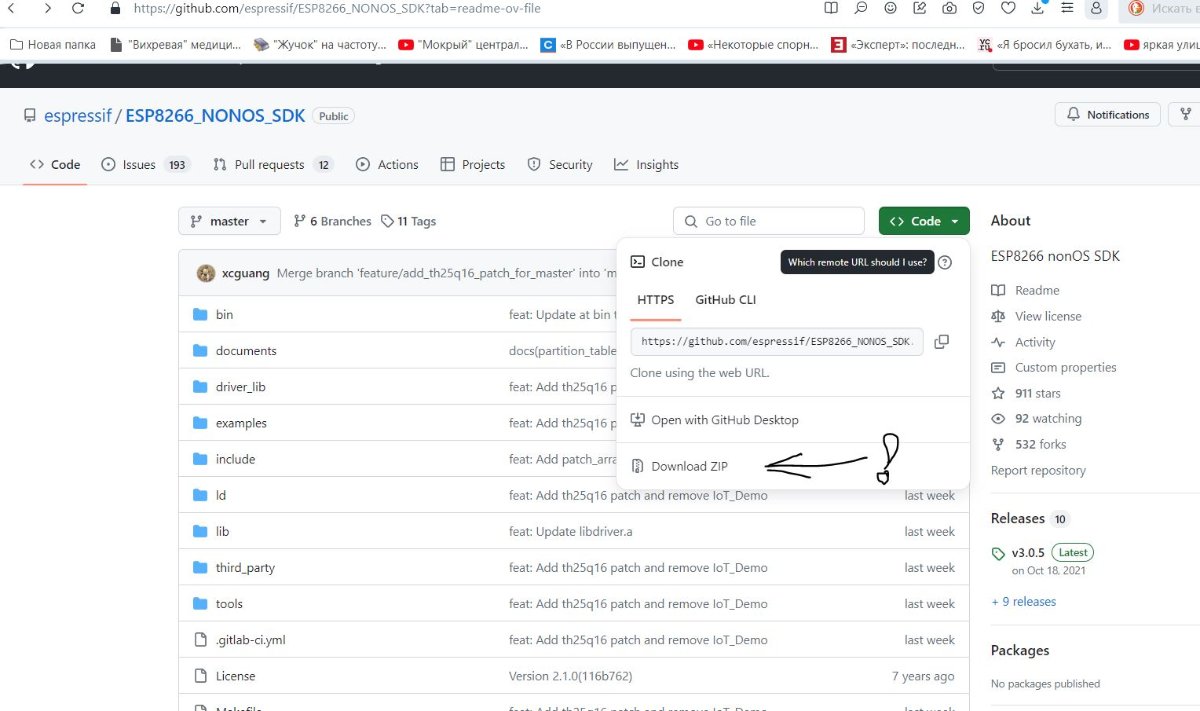

Good evening! Thanks for the instructions and the link. I understand that this esp8266 module and the like have factory firmware, and the newer firmware is made by private professionals. After clicking on the links to the documents and the description of the version fixes, I got to where I can download the update. But there was a link to the ESP8266_NONOS_SDK_V2.0.0_16_08_10 version and there is an update version to "Update at bin to 1.7.4.0", there are still two firmware versions: 1)ESP8266 NonOS SDK and 2)ESP8266_RTOS_SDK. I understand that the 2nd version of the firmware is also suitable for other devices like esp32?
And there is also a link to an even later version of the "Updated SDK version to 3.0.5". But after your post, I did not understand at what point in the programming of the esp 8266 module should I press the button on the output "GPIO-0" to connect with minus earth? Please explain how to act there.
esp8266_nonos_sdk _ZIP.JPG (102.17 KiB) Viewed 42937 times
update at bin to 1.7.4.0.JPG (64.28 KiB) Viewed 42937 times

I'm unsure of your screenshots above and can only comment on what I used.
A few posts above I posted a link to download the SDK. If you follow that you are taken to an espressif page and near the bottom you will see a box marked attachments and a link to download the zipped SDK.
Download this then unzip to a folder on your drive. When running the flash tool you need to follow the instructions and point the respective paths to the SDK folder and files you just downloaded.

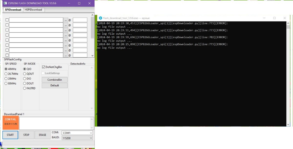

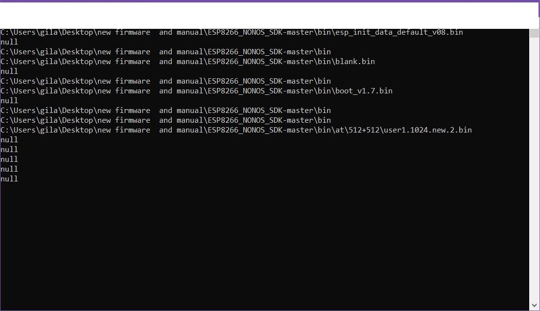

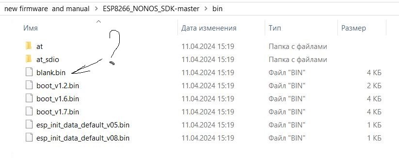

Good afternoon! I downloaded it according to the instructions, but I did not find the original in the forum of our topic, where you explained which files to download and when to press which buttons. I did these manipulations, but I'm not sure that I chose the second file correctly, if as you said(?) leave this place empty, it will not be marked green and will be red. But in any case, something went wrong. After pressing the start button, nothing happened, only there was such a screen as I am sending you in the attached files. If you have the opportunity, could you explain what I was doing wrong there (or correctly?). I won't be able to read your answer until Wednesday after 4 p.m.
after pressing the start button, nothing happened.jpg (79.84 KiB) Viewed 42908 times

I'm not at a machine with the esp stuff on it but will check when I can
Did you remember to enable the esp first by connecting as per the circuit earlier, and pressing the rest/gpio-0 buttons? Only after that can you then press Start in the Flash tool.

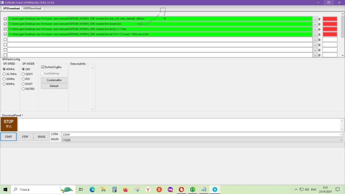

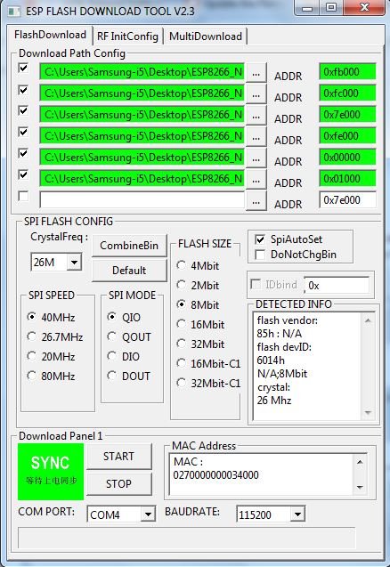

Good afternoon! Before pressing the start button in the program, I had the circuit connected as you sent me, I selected the files and performed the following manipulations:
-Press and hold the reset button
-Press and hold the GPIO-0 button
Wait a few seconds
-Release the reset button
-Release the GPIO-0 button
I tried these manipulations twice, once when there were the following downloads: 1 = esp_init_data_default_v08
2 = empty
3 = boot_v1.7
4 = user1.1024.new.2
and another time when the blank.bin file was selected in step 2.

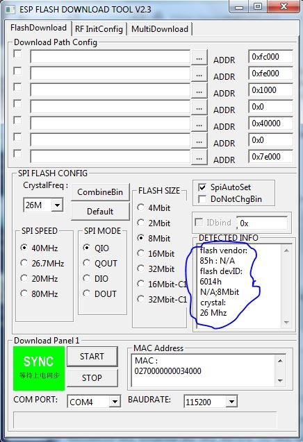

Good evening! Today I decided to look in more detail at how to program, the instructions have a screenshot of earlier versions of the program "flash_download_tool_3.9.6", there is a menu for selecting the size of the downloaded file and there is an instruction that says that if the version of the old firmware is from m ESP8266_NONOS_SDK_V1.5.0, AT_V0.51, then the firmware is 8 MB and more (though this moment referred to the program "EspRFTestTool_v3.6"But there is a menu for choosing the file size, but in reality there are only the names of the files and in what order to download.

My ESP8266 doesn't do anything, possibly the duff one from an earlier post.
I'll grab another, hopefully tomorrow.

Before we move on I forgot to mention that generally speaking you get two types of esp8266, built on blue and black PCBs. There is a difference as the blue indicates it has 512KB of memory whilst the black has 1MB of memory which is important when we flash. Note I use capitals. KB and MB to indicate Bytes which as we all know are 8-bits in length. The tool asks for flash size so you need to tell it the correct value. 512KB = 4Mb in the tool whilst 1MB = 8Mb in the tool (b = bit).
The flash tool looks like this. The important things to note and ensure are circled. Correct Com Port for your PC and Baud rate (115200). Also ensure no check boxes have been ticked.
With your esp8266 connected, press and hold the reset button, then press and hold the flash button (GPIO-0). Release reset, wait a second or two then release flash.
Press the Start button on the flash tool and after a few seconds you should get info in the detected info box. Important things to note are size (in this case) of 8Mb and crystal of 26MHz. I did have to do this reset esp and press flash etc a couple of time which I'm putting down to being on breadboard.
As my flash tool was already setup for 8Mb and 26MHz I don't need to change anything but you will need to check / change yours to suit. Also ensure QIO is checked and also SpiAutoSet.
When you open the SDK folder you will find many files. The ones of interest are in the bin folder (first five) and at (at > 512+512) folder. We are going to point the flash tool to the required files and also set the Hex address of where it needs to go. As the picture won't show you the full path including file name they are here in order:-
File / Hex Address
blank / 0xfb000
esp_init_data_default_v08 / 0xfc000
blank / 0x7e000
blank / 0xfe000
boot_v1.7 / 0x00000
user1.1024.new.2 / 0x01000
As you select the files by clicking on the three dots beside box and selecting the files, the boxes will turn green. Double Check Everything......! Now click on the check boxes to the left of the files you have selected and the Hex boxes will turn green
On the esp8266 module, press and hold the reset button, then press and hold the flash button (GPIO-0). Release reset, wait a second or two then release flash.
Now press Start in the Flash tool
A blue bar should start to crawl across the tool indicating the download has started. After a minute or so it will finish.
Now press reset on the esp8266 and release after a few seconds. Next power down the esp8266. You can either exit the flash tool or set the com port to the wrong location as we will need the port for our Terminal program.
Open your terminal program set at 115200 8/1/N, choose the correct port and connect. Power up the esp8266 and you should see a string of nonsense then "Ready". Sending "AT" should return "OK". Sending "AT+GMR" will return the details of the firmware.
Hope the above helps.

Good afternoon! I sincerely thank you for such a detailed description of the installation of the new firmware and for the older version of the download program. I have already downloaded it, now I will try to repeat your instruction. I just wanted to clarify, you have "
File / Hex Address" in your file list
blank / 0xfb000
blank / 0x7e000
blank / 0xfe000
boot_v1.7 / 0x00000
user1.1024.new.2 / 0x01000"
the "blank" file with a different hex is repeated several times-is it the same file or different? why am I asking if I have only one such "blank" in my downloaded files?
