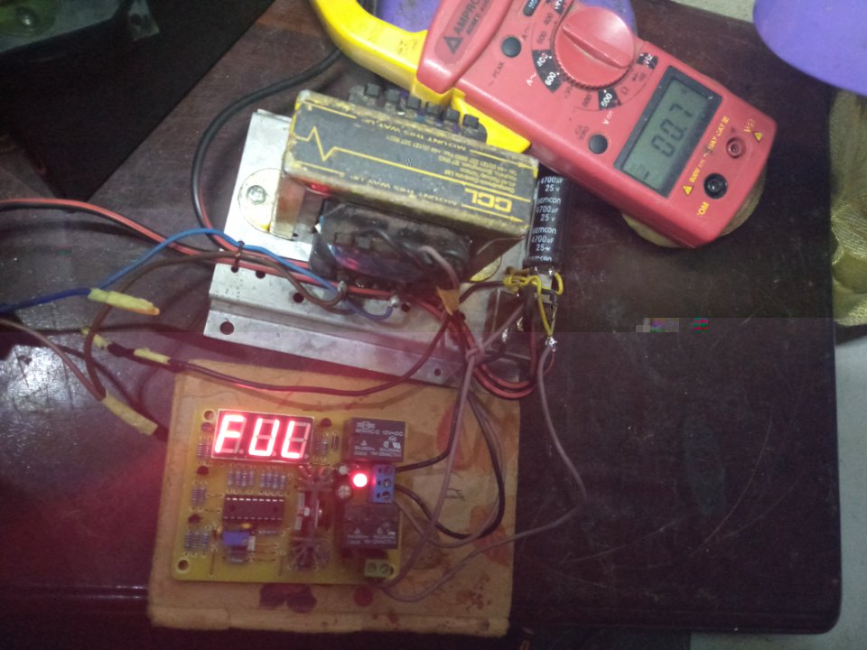

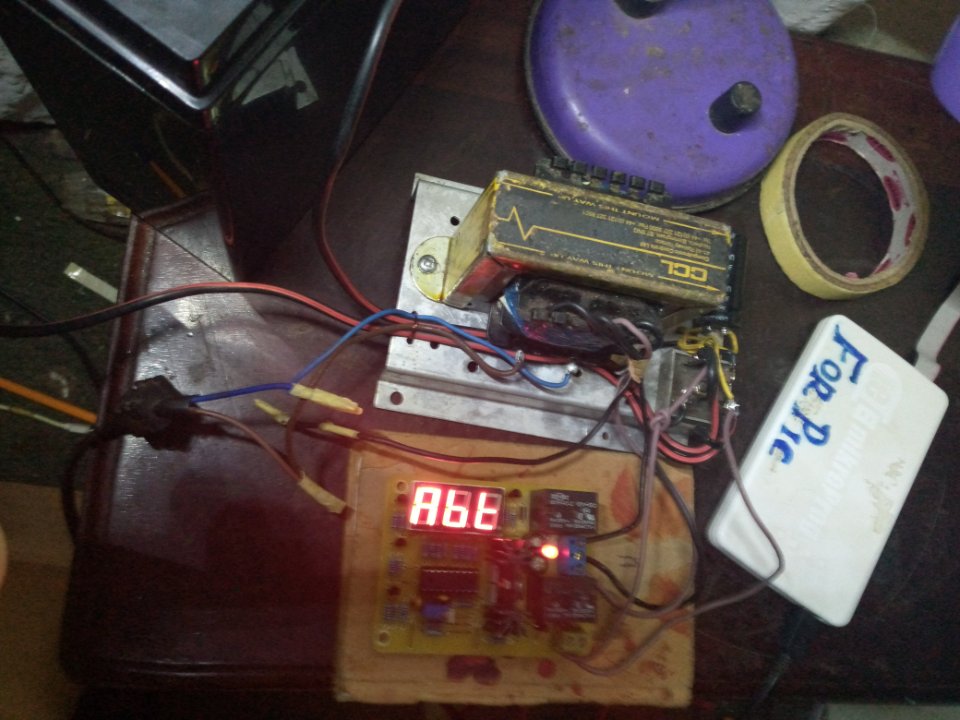

Re: Dc voltmeter 0-55v
This is the finished charger I did some trick on the secondary ac voltage to get Bulk charge,to last for 80% of recharge and the remaining 20% for absorption then Float i also put your word FUL for full but am going to re do the PCB with 4 relays 3 for the 3 changing states and one for fan with a temperature sensor like the LM35 coz the transformer worms up a little but the trick I did on the secondary ac really worked the battery is kept at 13.5v when FUL for that I used a smaller wire for reduced amps and much voltage when fully charged.that means I have 3 secondary wire terminals thru relay that is one for higher charge bulk 80% of charge and one for absorption at reduced amps 20% and float very low amps like 0.3amps and high voltage to keep my battery arround 13.5v it's a small 18ah battery for which require a maximum of around 20% of it's Ah value or less for the first stage
Martin's it's working really well am also supprised with only the transformer trick for stages of amps and voltage I really have to make new pcb coz I had only two relays I had to shift wires in order to test the stages have to make new pcb with temperature control for both battery and transformer and also have another small 7seg to indicate amps or just have one 7 seg to display all may be also flash amps for given seconds it will be a complex project but I have to do it for my battery.Atleast it's better than not having a charger at-all.
