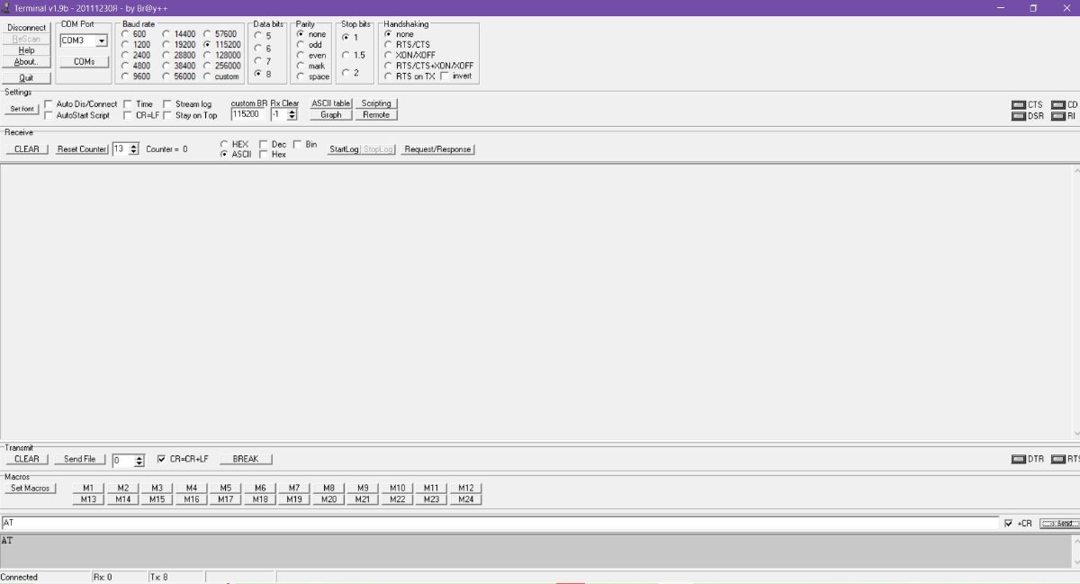

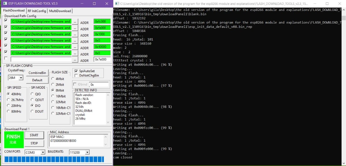

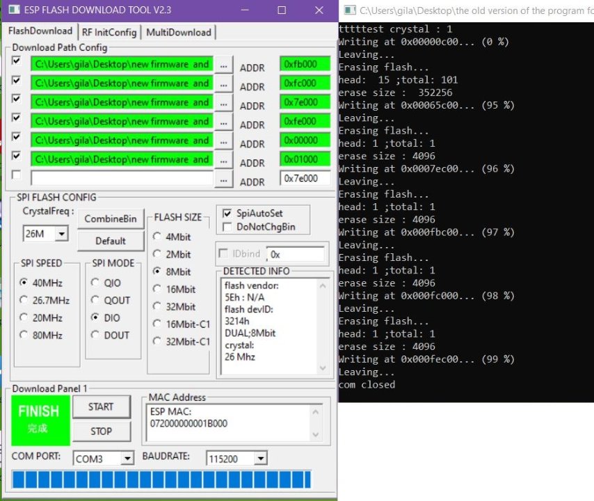

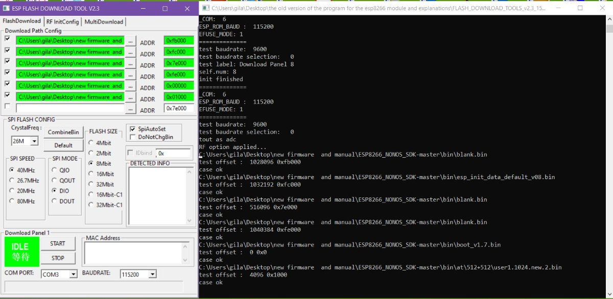

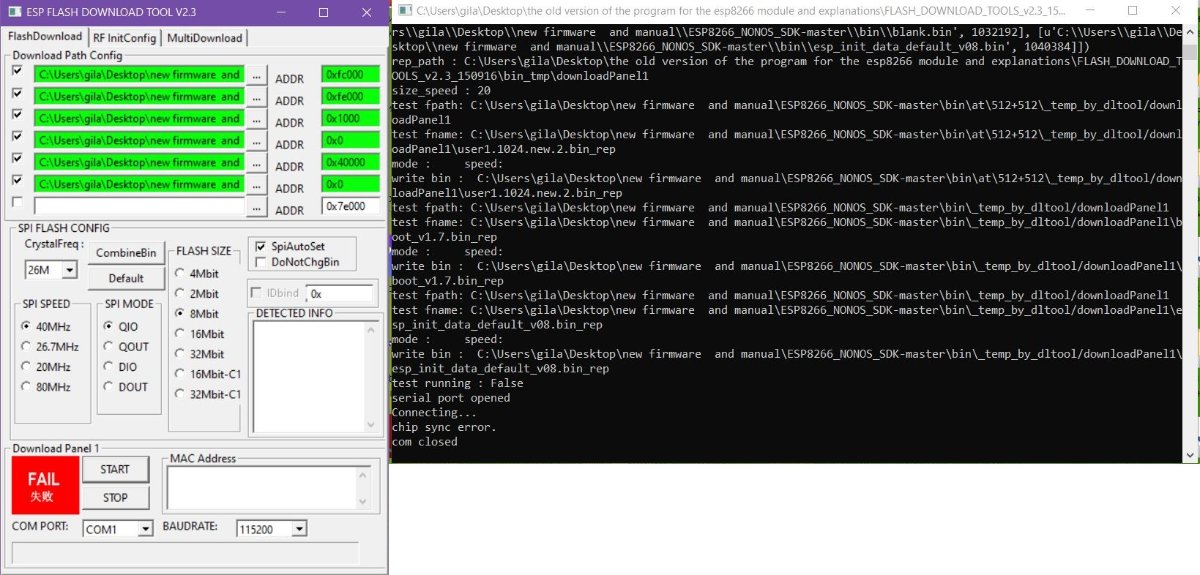

Good evening! Today I tried to upload the files that you indicated to me in that order to the new program and to the old one. Nothing worked out everywhere. In the old one, I also changed the connection ports and speeds, the same did not help. I noticed that you have inscriptions in the program window "MAC Address" and "DETECTED INFO" -I did not have such inscriptions and that you have on different screenshots, where the file location is indicated, then a selection button (with three dots) and a hex address-so in different screenshots, different addresses. If you delete them, new ones do not appear, that is, when you turn on the program, they are already there. Is it unclear where the files will be written to? I attached the screenshots of the logs, maybe something is more visible to you there than to me, I just saw that there was no synchronization and the port was closed.
- log2.jpg (71.97 KiB) Viewed 21606 times
- log1.jpg (56.47 KiB) Viewed 21606 times
- 1.JPG (154.97 KiB) Viewed 21606 times

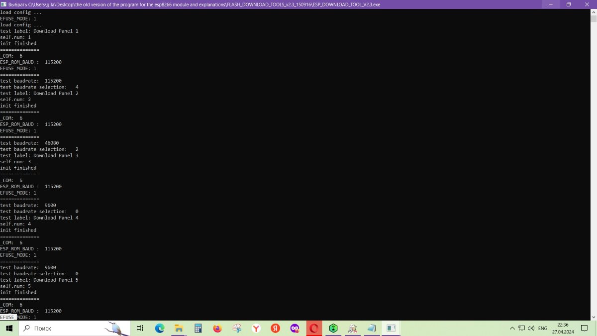

Good evening! Another additional log. Maybe, as an option, try the connection scheme as on the website, with resistors and capacitors.
- log3.jpg (119.05 KiB) Viewed 21606 times

From your screenshots you are not connecting to the esp8266.
1) Have you set the correct comm port? Nothing else can be using it at the same time. Close Terminal or anything else that may be using it.
2) Did you press and hold reset, then flash, then release reset, then release flash before pressing Start? It will not go into programming mode unless you do this and therefore will not communicate with the flash tool.
3) You have not entered the required Hex addresses. These values need to be entered as documented (but only later)
Please don't just send a post saying it does not work, instead follow my guide from the beginning. If at any stage it doesn't work as described, stop, take a screenshot and document exactly what you did up to that point. That is more helpful.
If you follow my post, you will see that in the first two pictures we connect to the chip and the flash tool obtains settings from the chip which are populated in Detected Info and MAC Address. If you are not getting that far then nothing else will work. Only after that we set file paths and hex addresses.
I didn't need the resistors and capacitors but as mentioned in my post I had to try putting it into "flash mode" a couple of times until the module returned "Detected Info" after pressing Start, which could have been my breadboard connections.
115200 will be the speed it communicates at when in "flash mode". Even a "bricked" module will still run at that speed.
Follow my post, step by step and if something doesn't work stop and document.

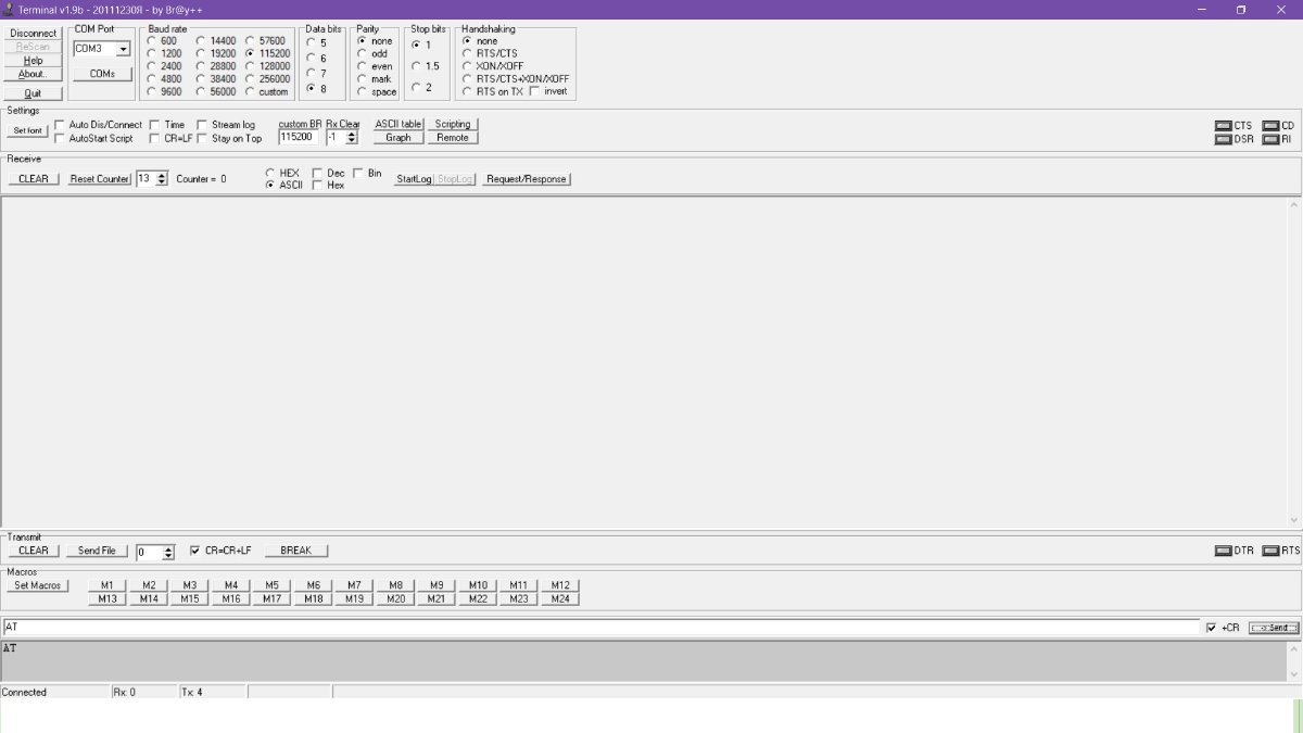

Good evening! It was possible to find the reason why it was not possible to program or receive answers in the terminal program-it connected the RX and TX pins incorrectly. It was possible to reprogram, but it writes in the log that 99% was completed, not 100%. But after connecting to the terminal program, it is not possible to receive any response. I have done programming 2 times, but there is no result.
- the module does not respond to commands after programming.jpg (62.84 KiB) Viewed 21494 times
- The programming process.JPG (120.17 KiB) Viewed 21494 times
- The programming seems to have gone well.JPG (126.48 KiB) Viewed 21494 times

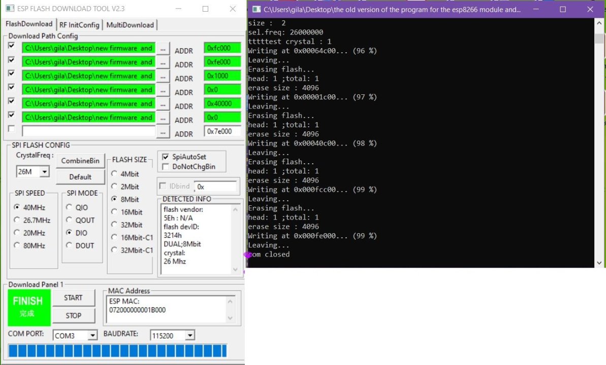

That's good you are getting the responses documented in your post. You are almost there.
You forgot however to enter the correct Hex values in the Address boxes
File / Hex Address
blank / 0xfb000
esp_init_data_default_v08 / 0xfc000
blank / 0x7e000
blank / 0xfe000
boot_v1.7 / 0x00000
user1.1024.new.2 / 0x01000
If the files are not in the correct addresses then it won't work..
If you enter the files and addresses as shown you should be good.

Good afternoon! Unfortunately, the module is still silent and does not respond to commands after it has been reprogrammed.(changed addresses). The results are in the screenshots.
- nothing has changed, the module is not responding.JPG (65.78 KiB) Viewed 21443 times
- new_address.JPG (120.69 KiB) Viewed 21443 times

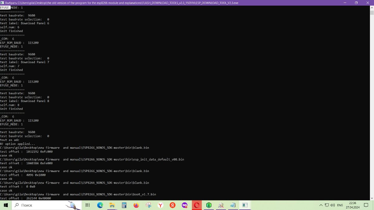

Good afternoon! I also forgot to attach a screenshot of the program logs, where you can see which files I selected and to which address I was going to send.
- log_new_address.JPG (124.85 KiB) Viewed 21436 times

Unfortunately a screenshot of a partial log isn't of much help here.
Can you copy the log and paste into a text / word documents and send that?

Good afternoon! I did as you asked. View the log file in the attached text document. But I want to note that the situation with the QIO regime has repeated itself. After pressing the start button, it jumps to DIO itself. And I immediately rearrange it manually in QIO.

If it is jumping to DIO by itself then it is overiding the setting of QIO as SpiAutoSet is checked. Not sure why it is choosing DIO over QIO. Maybe try it without SpiAutoSet checked?
Stupid question time (as in your earlier post it did look as though you loaded) but did you remember to reset or reboot the ESP module afterwards and also to disconnect the Flash tool (as the tool would still be in command of the comm port)?

No real need to unplug the adapter but you do need to close the flash tool and also reset the esp.
There is a slight chance that when you unplugged the adapter and then reinserted it assigned a different port (unlikely) but if you hadn't reset (or removed power then repowered) the esp it would still be in program mode and unresponsive.

Good evening! I have now checked your version about the uncheck SpiAutoSet setting-it worked, stopped jumping from QIO to DIO at the beginning of programming. But when passing commands through the terminal program, nothing has changed. There is no response to the "AT" command. The attached files contain the program log.
- log_NO_SpiAutoSET.pdf
- (48.88 KiB) Downloaded 6967 times
- log_NO_SpiAutoSET.txt
- (7.42 KiB) Downloaded 6969 times

Re: Download the program for the device via the Internet.
Again, stupid question. Did you reset the esp and close Flash?
