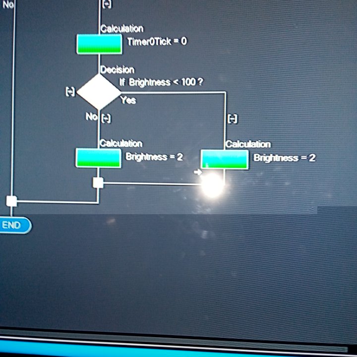

Is that with 16F88 hardware & you have modified flowchart yourself?
If so can you post it.
Can you change it so brightness is fixed at 2 and let me know if flickers?
If the interrupt is fast enough and display is disabled within No branch of If( DisplayEnable) then should not flicker.
Or do you have new hardware for 18F442 and using flowchart I posted without modifying it?

I fixed Brightness and it still flickers.

Re: Dc voltmeter 0-55v
The problem is with 16F88, it's an old microcontroller, so maximum internal clock speed may not be fast enough.
The higher the internal clock speed, the higher the timer interrupt can go without hogging all the resources.
As a very rough guide.
If timer interrupt is set as 4KHz, you will get severe flickering.
At 8KHz you will get slight shimmering .
At 13KHz+ you should be ok.
That's not an issue with internal clock at 32MHz.
I have set the attached flowchart at 13.3KHz for you to try.
Full BAT Test 6bb.fcfx
