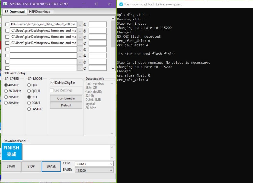

Good evening! Unfortunately, there are no changes for the better, but it turned out to erase the old device IDs (those inscriptions in the windows) and get new ones, it was possible to program again. But when checking the terminal program, nothing happened. I did it 2 times, once exactly according to your instructions, and the second time before point 8, I pressed the reset and flash buttons again in the prescribed manner -it did not help. I am sending screenshots and a log file.

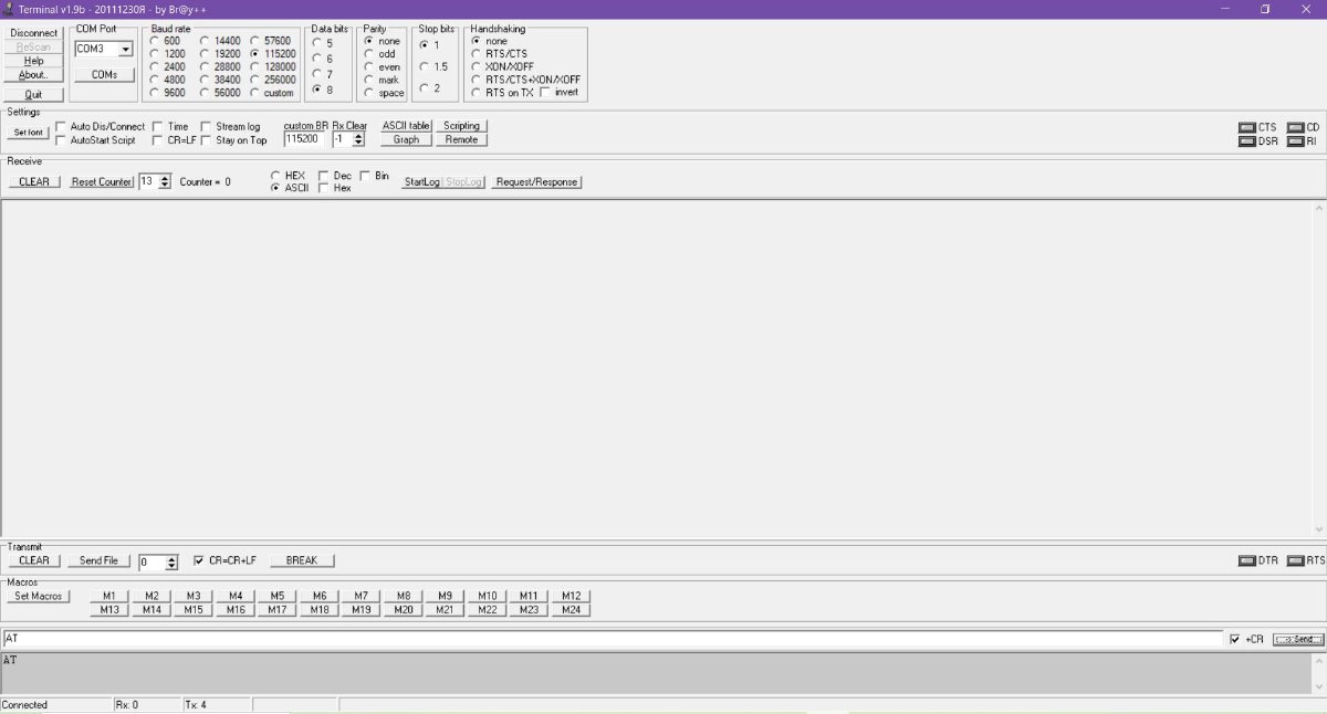

- screen terminal.JPG (64.81 KiB) Viewed 28772 times
- The program log after clicking the erase button..JPG (81.32 KiB) Viewed 28772 times

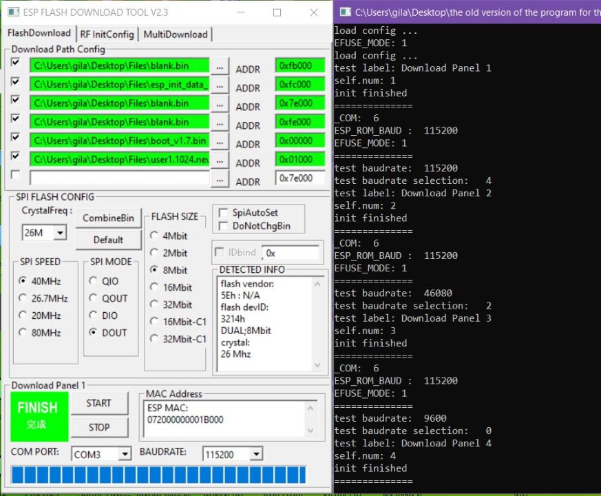

- screen flash download tool_v2.3.JPG (121.46 KiB) Viewed 28770 times

Just to be clear, after you erased you then flashed using flash tool 2.3 as before?
- Posts: 786
- Has thanked: 187 times
- Been thanked: 205 times
Re: Download the program for the device via the Internet.
I ask as the check boxes on the left aren't checked on v2.3
gilanetugila
- Posts: 268
- Joined: Thu Jul 30, 2020 2:01 pm
- Has thanked: 7 times
- Been thanked: 1 time
Good evening! Yes, of course, in the older version.

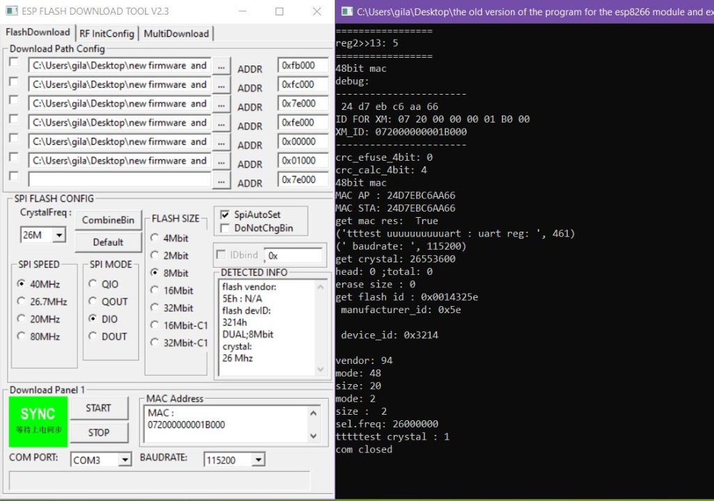

Good evening! I did that screenshot with the old version of the program after paragraph 5 of your instructions.

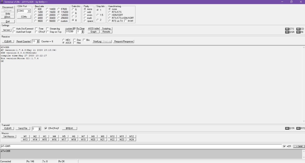

Good afternoon Happy holiday! Today everything worked out on the first try. It is necessary for the programmers of the flovcode program to write more detailed instructions for these manipulations with the ESP 8266 module, otherwise without a glass or two you will not understand this witchcraft. The attached files have a screenshot and a log. If anything I can get in touch on Monday after 16:00. By then I hope to have reprogrammed the second module.
- new firmware version.JPG (67.95 KiB) Viewed 28680 times
- log DOUT.txt
- (6.56 KiB) Downloaded 9658 times
- 04.05.2024 screen flash download tool_v2.3.JPG (128.54 KiB) Viewed 28680 times

I am so very glad to hear that and it is indeed now becoming a happy holiday. Well done in getting it working
The issue seems to be that they license out manufacture which means anyone with a license is then responsible for all documentation as it is essentially now their product. To compound matters, each manufacturer appears to do things differently and may not be around next month to answer questions. Then add in the cloned versions and soon you have a quagmire of information (or missinformation).
I think this thread will be quite informative for anyone else facing difficulties with an ESP8266.
Anyway, now you have it responding again to "AT" you are good to try connecting to the world
The Flowcode component "talks" to the esp8266 using the "AT" commands, and I strongly recommend you familiarise yourself with some of the basic ones. If you download the "AT" manual you will see the commands are broken into sections for ease of reading. The commands also give examples of usage.
Your USB adapter and Terminal will become your best friends
Using Terminal you can issue commands and see any response. You can send configuration strings, then connect to "wherever" and see the results, all from your PC.
I frequently do this to check things are working as expected and once I'm happy I then use Flowcode to issue the commands.
I really like the ESP8266 as it is quite compact and capable, and provides connectivity to pretty much anything.

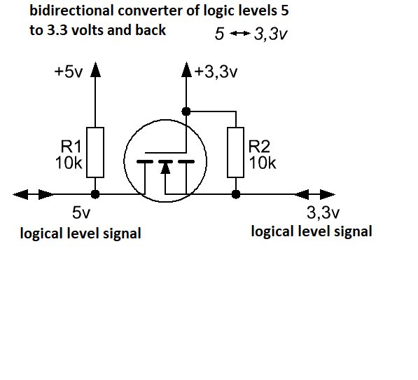

Good evening! I found a small circuit on the network-a bidirectional logic level converter, but I did not use it, I will try it in the simulator, but the voltage divider looks simpler and more accessible...
And as for connecting several controllers via uart, I was interested because there was somehow a creative idea to make an alarm, well, as if I did it for myself, ADC pins are used there, I had 5 sensors and enough space. But let's say some kind of object has 12-15 rooms, we already need 3 controllers that receive data from sensors and transmit information to the fourth, and the fourth processes it. Then the question arises about connecting several controllers via uart.
- bidirectional logic level converter.jpg (30.41 KiB) Viewed 28568 times
- Posts: 786
Now I understand a bit better.
If so, what you want is the ability to have:
Multiple sensors throughout building
Each sensor is "managed" by a microcontroller (each microcontroller may have multiple sensors)
Each microcontroller will gather data and send to a "receiver" microcontroller
This receiver will process the data and respond accordingly.
Is this correct?
As for level shifting that is a typical circuit used everywhere for bi-directional level shifting. If you only wish unidirectional you can just use two resistors as a simple voltage divider.
