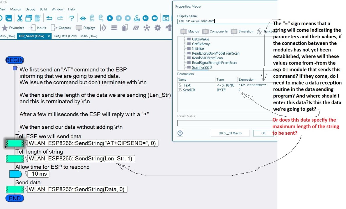

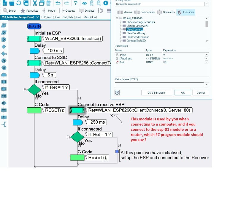

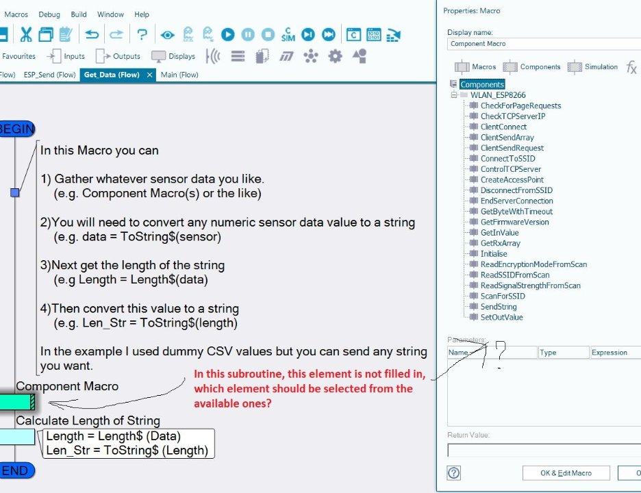

Good evening! Thanks for the link, I'll look at the examples tomorrow. I wanted to ask you about the lesson "ESP-ESP_Send" from March 15 , 2023. The questions are written in the screenshots of the program.
- Get_Data.JPG (114.43 KiB) Viewed 27096 times
- ESP_Send.JPG (152.09 KiB) Viewed 27096 times
- ESP_Initialise_Setup.JPG (85.65 KiB) Viewed 27096 times

You posted three screenshots.
One
The "empty" macro you refer to is just an example. You would instead add whatever macros you need to gather whatever data you desire.
Two
We are using AT commands to control the esp8266.
If you refer to the AT Commands and look at CIPSEND you will find out how it is used. Also check up on how servers communicate.
Briefly, when we send information out to a server we need to tell it we are about to send something, its length, then the actual thing we are sending.
The charts you refer to are simplistic in an attempt to illustrate the process. We need to construct a string that contains the command and then the length of the data the server is to receive.
The first send string sends out part of the complete string we need, however we do not terminate it with \r\n.
The second send string sends the actual length of what we are about to send.
The server accepts this and responds with ">"
We wait a short delay for the server to respond with the ">" then we send the actual data.
Three
This branch attempts to connect to the esp8266 that is acting as the receiver (in this particular application), or target if you prefer. If it does not successfully connect then we do a RESET and start the chart from the beginning.
One
Two
Three

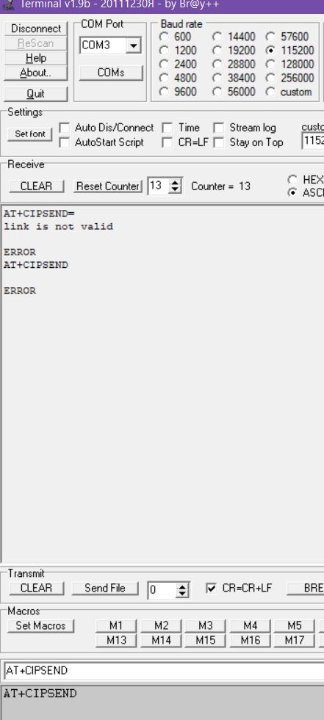

Good morning! Thanks for the clarification, but the answers are not to the point of the questions asked. I have now tried the command "AT+CIPSEND=" (as in your program), send it from the esp-01 module connected to a USB-TTL adapter, using terminal programs, I thought it would give me the length parameters, but writes that the format is incorrect.
- AT+CIPSEND=.JPG (36.06 KiB) Viewed 27076 times

If you reread my answer (# Two) you will see that I inform of what a server expects and what we need to do to achieve this.
Only sending part of the required string is very unlikely to achieve results and hitting the enter key before you have sent the entire command will cause the esp to attempt to process what you have already typed.........
If you are (which is a good way to learn) using AT from a Terminal you will need to do some manual calculations first.
If you wish to send Hello you may think this is five characters in length, but not to a server. You need to include everything being sent in the string such as termination characters ( \r\n ) which adds another four to the length.
If you look in the chart, especially the calculations, you will see how the strings are constructed, then you will see once constructed we calculate the length.
For example sending Hello\r\n is nine characters
Using Terminal, you would issue the AT+CIPSEND=9 then enter. After a few milliseconds the esp will reply with a ">"
You can now type in Hello and press enter (which will add \r\n)
If you don't first tell the esp how many characters to expect, or send the incorrect value you are unlikely to have much success.
