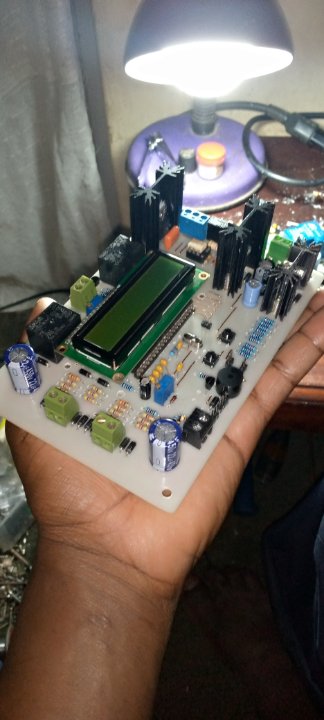

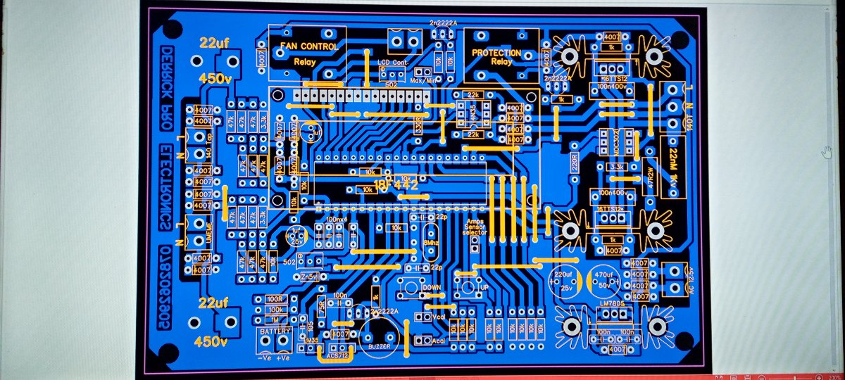

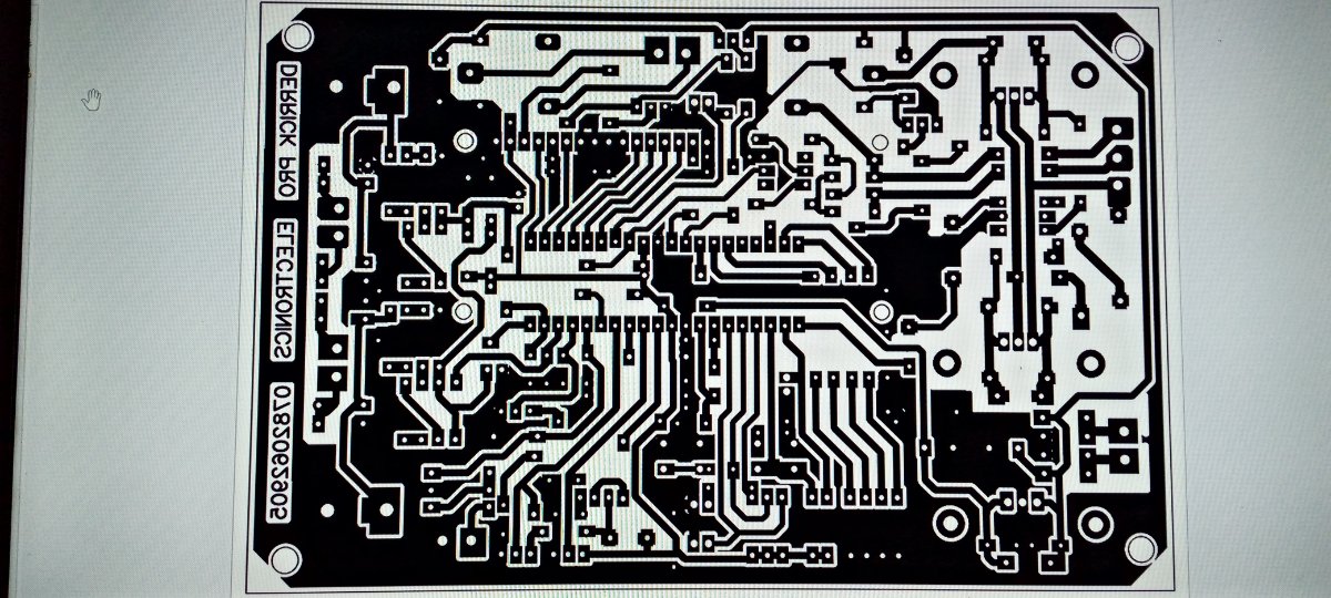

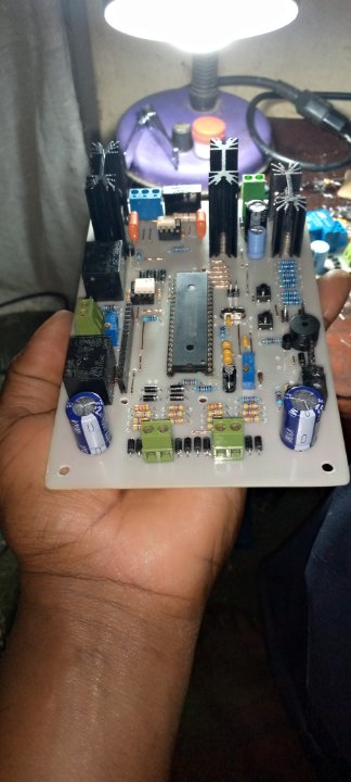

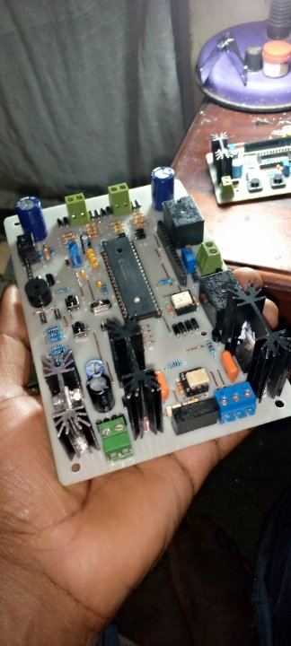

But i can say this has been so interesting am going to study it more as i get the pcb up and running thanks Martin for the hard work helping me may God bless you.Just finished it's transformer
- IMG_20200508_094449_287.jpg (126.21 KiB) Viewed 11094 times
- IMG_20200508_094021_448.jpg (125.55 KiB) Viewed 11094 times
- IMG_20200508_081451_739.jpg (124.37 KiB) Viewed 11094 times

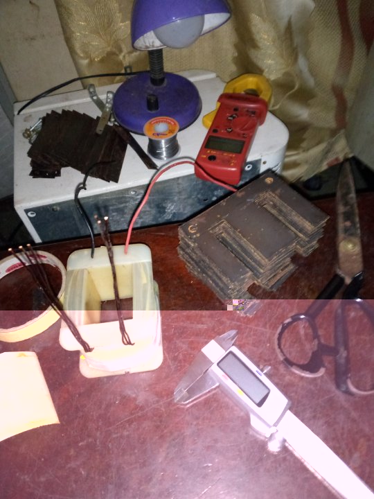

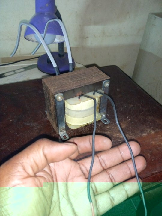

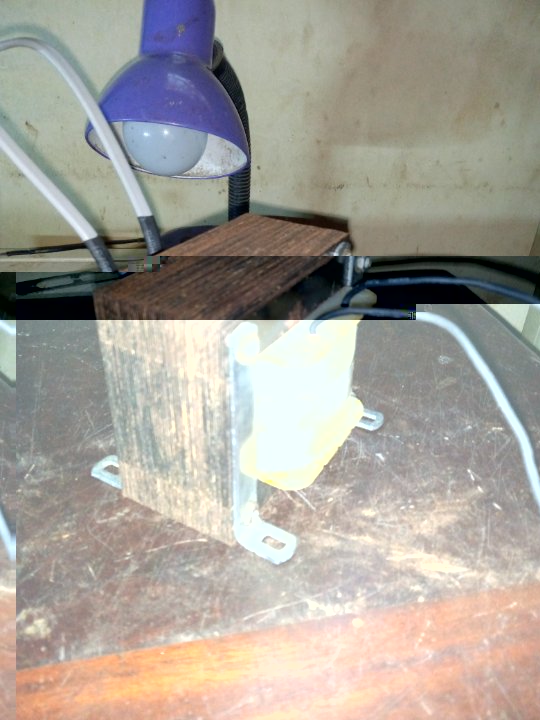

Re: Dc voltmeter 0-55v

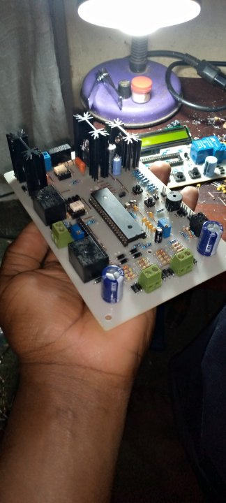

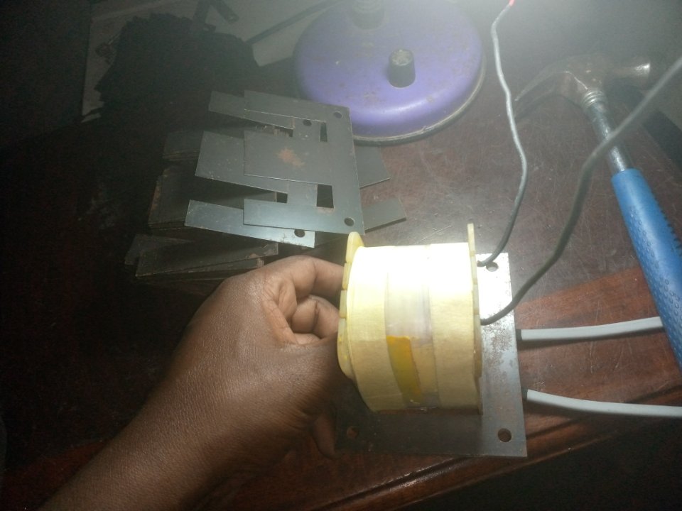

More
- IMG_20200508_103940_315.jpg (114.04 KiB) Viewed 11093 times
- IMG_20200508_103909_525.jpg (111.53 KiB) Viewed 11093 times
- IMG_20200508_100452_625.jpg (164.87 KiB) Viewed 11093 times

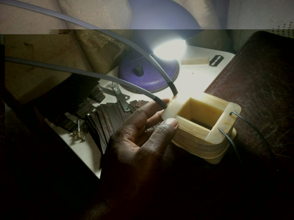

transformer looks quite good, if you make another one you need to remove the surface rust from the laminates.

Ok this is what I've managed to come up with guys have to say the covid 19 has really delayed my testings coz even shipping costs are high from China can't afford them now making the all components expensive, just finished designing this and i will test my code with it if i get all the required components the likes of ACS712-30a module.ok this fits well under the zero crossing post tho it also has a voltage read option don't know what you guys say i think i have to talk to Medelec35 and see what he has to say if we can move all this part of about zero crossing into the zero crossing post or we leave it here what do you have to say Martin?
- IMG_20200917_011046_862.jpg (225.45 KiB) Viewed 9960 times
- IMG_20200917_010833_230.jpg (252.81 KiB) Viewed 9960 times

Ok am almost finishing this one but also needs the 18f47k40 because it will have a bunch of setups as i need it to be used from 12v to 48v,so with multi function two buttons i think i will be able to achieve that, may be provide a little pass code before you jump into the settings for battery to be charged setup min and Max amps (low and high) setups like that.That is if the project is successful (if the code works as required) coz i got the formula from some website so i had to do some math to come up with this thanks to Medelec35 with the interrupt calcs so hope this works that makes me happy. Am only still having trouble with the snuber circuit got a video about it but there is some little thing i don't click, need to understand this as i hate guess work i think i will have to post the link of the video so that you guys have a look and help me were my little brain has jammed.
- IMG_20200921_002036_615.jpg (85.03 KiB) Viewed 9924 times
- IMG_20200921_002047_164.jpg (85.55 KiB) Viewed 9924 times
- IMG_20200921_002157_897.jpg (84.81 KiB) Viewed 9924 times

Here is the link to the RC snubber circuit design. Here am interested in the LR (load resistance) is it for the transformer or the battery to be charged? https://m.youtube.com/watch?v=eZwJgPd7_p4&t=479s
