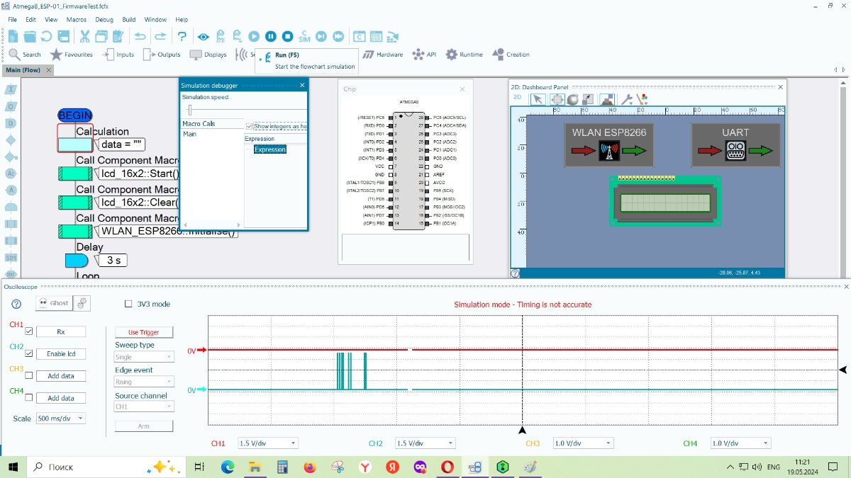

Good afternoon! I decided to check with an oscilloscope in the FC program what happens on the legs of the controller when the esp-01 module sends data about its firmware, there are no signals on the Rx leg, this means the esp-01 module sends firmware data via wi-fi or this module is visually present in the FC program, but in reality it is not it works (as in the case of spi). How else can I check the functionality? or should I use an oscilloscope to try to check what is happening on the antenna of the esp-01 module? There is the first version of the program in the screenshot of the signals on the oscilloscope, but the results are the same in both cases.
- 2.from esp-01 to Rx pin of the controller, synchronization is based on the enable signal from lcd1602.jpg (137.52 KiB) Viewed 33753 times
- esp-01 send firmware test .JPG (40.21 KiB) Viewed 33753 times
- Atmega8_ESP-01_FirmwareTest.fcfx
- (16.1 KiB) Downloaded 10581 times

Get rid of the UART component (as per my previous post). There is no need whatsover to include it in your chart at all.
I'd be wary of any simulation.

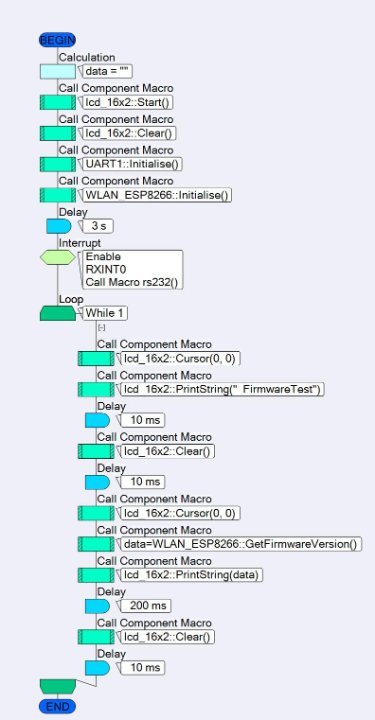

Good evening! I hope this is how you describe it, if it were so it would get rid of many confusing situations. I made the program, it's in the attached file. I uploaded it to the controller, but no miracle happened, only the inscription "FirmwareTest" appeared. Perhaps the module sent the firmware data somewhere, as it warmed up a little while working. But where is not clear.
- (12.72 KiB) Downloaded 10564 times

First, double check your connections and settings. I assume this is all hardware and not simulation?

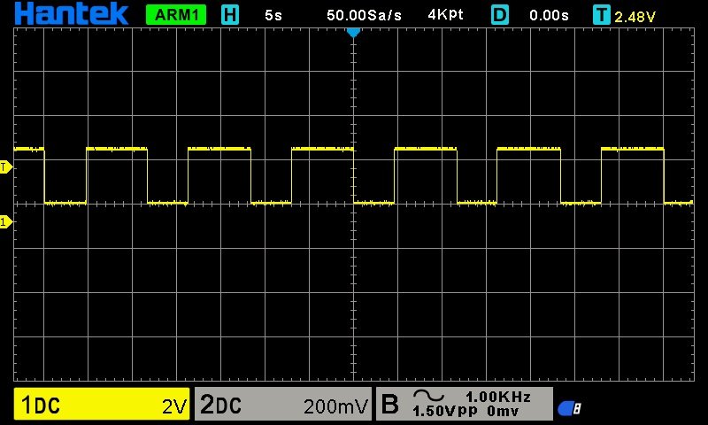

Good evening! I have now checked the signal with an oscilloscope. A meander type signal is visible. The commands could not be decrypted. I also noticed an unpleasant feature in the power supply from 3.3 volts, I put the LF33CV chip, according to the specification it outputs a current of 0.5 amperes, but now it is very hot. I decided to check the current that comes from the chip - it outputs about 0.07 A, switched to a range of 600 mA, the tester goes into protection mode. I decided to check the current with a simpler tester, it shows about 0.06 A. When the esb-01 module was removed from the adapter on my board, the power supply chip stopped warming, the current consumption was 0.0 mA.But this meander is visible when the program is running to get the firmware version.
- dso_01_01_00_53_43.jpg (55.08 KiB) Viewed 33631 times

Sorry I'm confused.
Are you saying you still had the ESP8266 adapter board still in-circuit? The one that allows you to connect to a PC? If so that will be the cause of your problems, or very likely to be.
The uC should be connecting directly to the Tx / Rx pins of the ESP8266 (possibly reset too if you wish HW over SW reset). You cannot have the adapter board that allows you to connect to a PC as part of the circuit.
You will need to create, possibly using breadboard, a circuit that provides the necessary connections and power to the esp8266 with the Tx/Rx going to the uC.
Sorry I'm confused.

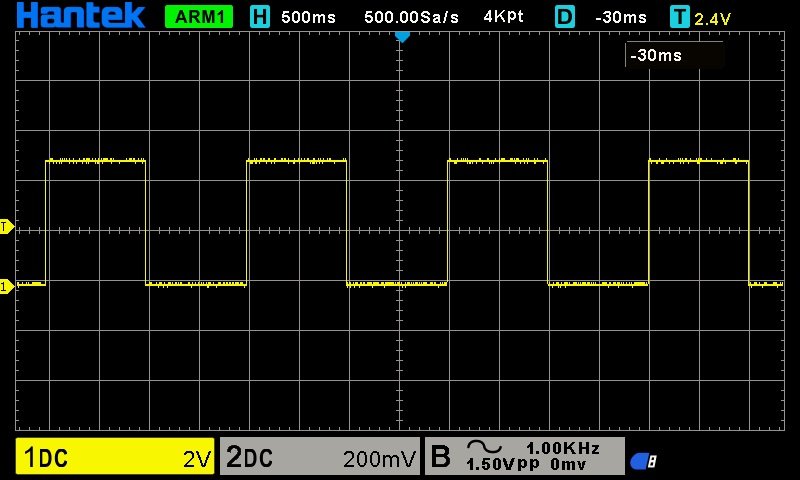

Good evening! And in the attached picture, sending the letter "U", a delay of 1 second, then clearing the screen and again a delay of 1 second. And the controller stopped being defined in the programmer, put another one. No, when I measured the current, I disconnected the usb-ttl adapter from the computer and from my board. At first I also thought he was to blame. Then I read in the summary that this power supply chip can heat up to +145 degrees Celsius.
- Atmega8_ESP-01_SendString_U.fcfx
- (12.21 KiB) Downloaded 10587 times
- dso_01_01_00_03_08.jpg (54.77 KiB) Viewed 33616 times

Just remembered you don't have a USB-TTL adapter as such, rather a plug in "piggy back" that takes your esp.
With that in mind my previous suggestion of using the adapter to monitor is a non-starter.
Disconnect the esp and adapter from your microcontroller and then try the one-second flash test.

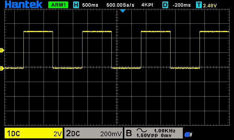

The LCD doesn't care what speed your controller is running at, it will work regardless of clock speed.
Your FC file should be outputting the letter "U" every two seconds as you have two one second delays in the loop, and the letter "U" should have 10-bits in each "burst". Your scope doesn't suggest that which is why I am trying to establish where the issue lies. In addition it looks like the trace is stretching with each high increasing in length.
If you create a chart as per the link I sent and connect your scope to the output, you should get a clearly defined square wave with a period of one-second. If not we need to establish why.
The one-second flash is probably the most useful troubleshooting technique available and is the best first step to take, especially if using comms.
Incidentally when you used the SendString I see you had SendString("U",8). The number after the "U" and in this case 8, is only to tell FC whether or not to include a Carraige Return when sending the value. 0 means no with any value above 0 being yes. I usually have 0 and include any required termination characters in my string.

Good afternoon! Thanks for another lesson about the number 8, as I understand it, there should be either a "0" or a "1", but in this particular case there should be a "0". And for comparing the test on lcd and on led. As for the flash test with the LED flashing, it also flashed in the attached file screen from the oscilloscope.
- dso_01_01_00_06_33.jpg (55.57 KiB) Viewed 33519 times

Re: Download the program for the device via the Internet.
I'm not at my PC so can only give brief comment.
That looks like a good square wave so we now know that your clock and connections are good. It is always, always worth checking these at the beginning. You cannot over emphasise how valuable this check is.
Next, we will prove the port. In your flash test chart, change the output pin to whatever you will use for Tx (D0 or D1 I think).
Make sure you get a clean square wave on the pin. If not find out why.
- Posts: 786
- Has thanked: 187 times
- Been thanked: 205 times
Back at a PC.
As mentioned that's a good square wave.
Next we "prove" the port we will transmit on.
Using your flasher chart as above, change the output to be D1 as this is the port that will eventually transmit to the ESP. You should get another nice clean square wave.
Once you have that we can move on to the next step, proving everything as we progress to getting the ESP's talking to each other.
Back at a PC.

Good evening! I checked how the LED on the Rx and Tx pins would flash (the signal turned out to be smaller on this pin, since there is a voltage divider), it flashed on both pins without incident. Maybe in this example from "help" it is necessary to send the command "AT+GMR\r" or "AT+GMR\r\n" from the controller from the beginning? I will be able to continue on Friday, after 4 p.m.
- (Tx)PD1-the signal passes through the voltage divider.jpg (53.04 KiB) Viewed 33474 times
- (Rx)PD0.jpg (57.75 KiB) Viewed 33474 times
