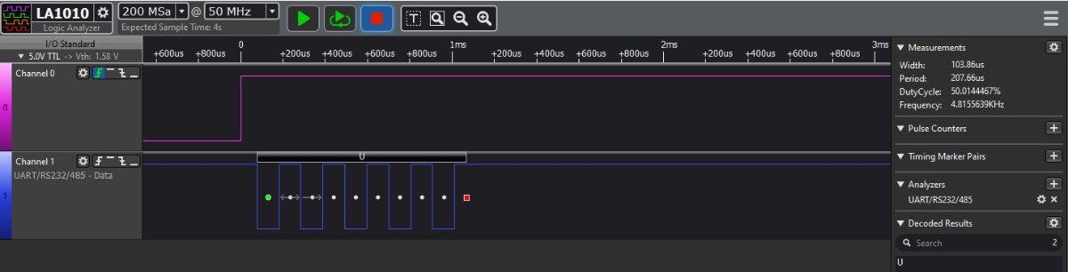

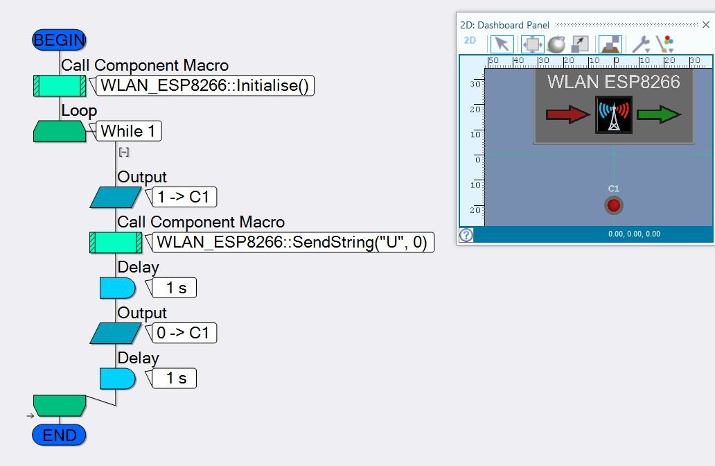

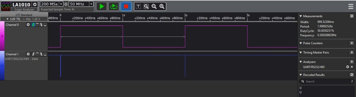

Now we will verify component functionality. Change the flash output to a pin not being used by the ESP8266 Tx / Rx (example change to C1)
Add in the ESP8266 component and in properties set it for 9600 baud with Tx on D1 (or whatever your Tx output pin is)
In your flash chart, at the beginning initialise the component.
In the main loop, just after you set the Flash output pin high (C1), add in the following ESP8266 command
SendString("U",0)
Connect your scope to trigger on Ch1 and connect Ch1 to flash output pin (C1)
Connect Ch2 of your scope to D1 (or whatever the Tx output pin is)
Now when you run your chart the scope will trigger with the one-second flash and also capture what is being sent out on the Tx. You should see on Ch1 your square wave as before with a little "blip" on Ch2 each time Ch1 triggers.
If you then zoom in on Ch2 you should see a pulse going low, then a square wave returning high at the end.
Great, all pins / connections / settings work as expected.
SendString("U",0)

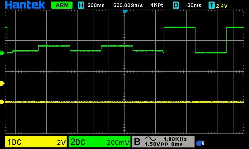

Good evening! In the tests according to your methodology, something went wrong, it probably immediately becomes clear to you... The LED has stopped flashing. In the screenshots from the screen, the signal from the Tx controller is yellow, and the green is the signal from the LED (output C1 of the controller).
- dso_01_01_00_08_29.jpg (63.44 KiB) Viewed 49964 times
- dso_01_01_00_09_21.jpg (66.08 KiB) Viewed 49964 times
- dso_01_01_00_07_11.jpg (63.8 KiB) Viewed 49964 times

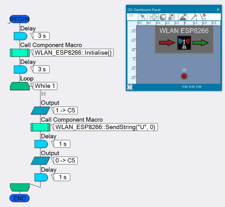

Good evening! and here is the program itself.
- flash_led_test.fcfx
- (11.33 KiB) Downloaded 17865 times

I think I see the issue.
Lets make the settings / connections as follows
Flowcode ESP8266 Settings
Tx = D1
Rx = Don't Care / Unconnected
Reset Mode = Software
ESP SendString macro
Text = "U"
SendCR = 0
LED
Any unused pin you want e.g. C0
Ensure your clock speed matches your crystal. In your chart it was 1MHz but you usually have it at 16MHz (possibly a typing mistake).
Connect your scope ch1 to LED pin (C0)
Connect scope ch2 to Tx Pin (D1)
Set your scope to trigger on ch1 (pin C0) on a rising edge with a time base of 500mS. This should give a nice clean square wave on ch1 with "blips" on ch2.
Once you capture the above, zoom in on ch2 and you should see pulses.

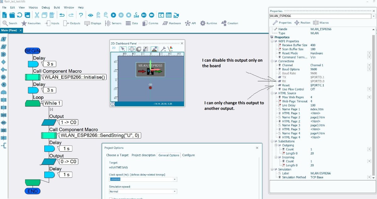

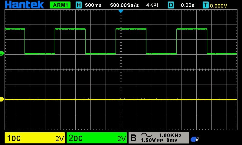

Goodnight! I've just done what you recommended. The green graph shows the signal from the Tx output of the controller, and the yellow one from the LED. The Rx pin is disconnected from the controller.
- dso_01_01_00_05_50.jpg (61.46 KiB) Viewed 49919 times
- program and element settings esp8266.JPG (116.33 KiB) Viewed 49919 times
- (11.32 KiB) Downloaded 17800 times

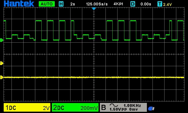

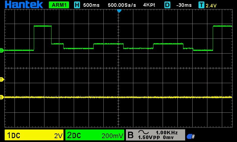

Goodnight! additional screenshots of the signals.
- dso_01_01_00_06_49.jpg (63.85 KiB) Viewed 49915 times
- dso_01_01_00_05_40.jpg (61.4 KiB) Viewed 49915 times

I'm not familiar with your scope. Are you sure you are set to trigger on ch1 (yellow trace)?
Irrespective of such, your Tx pin trace doesn't look correct.
Can you confirm nothing other than your scope is connected to your Tx (D1) pin?

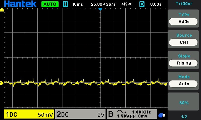

Good afternoon! My results are bad. I did it step by step, as you have written.
In 1 case, I don't have any signals at all, just a straight yellow line. For some reason, the LED does not blink in this program and there are no signals on the C0 pin.
In the 2nd case, there are small pulses on the Tx pin at the same settings as on channel 1. The ESP-01 module was removed from the adapter board in these experiments. In the 2nd case, I used the "ground" pins of the oscilloscope channels as you requested.
- dso_01_01_00_16_49.jpg (58.48 KiB) Viewed 49863 times

In the screenshots your time base seems to be 200mS per division which means five divisions per second. Looking at your green trace you can see that each high / low change is one second in length suggesting that it is your "led" pin (C0). However I don't understand why the level of a "high" is only roughly about 0.4v.
What are your scope settings? Are your probes set to 1x or 10x?
Can you try the following?
On your scope only enable ch1, ch2 will remain disconnected and not used.
Connect ch1 to C0 and press "autoset" and capture.
Connect ch1 to D1 and press "autoset" and capture.

This is what I'm expecting to see when you "scope" the pins.
Triggering on rising edge of "LED" pin (C0).
You can see the one-second flash on the first trace and each time it rises you can see the "blip" on the second trace. In the screenshot you can see two "blips" and I have set up to analyse the trace. On the right of the screenshot you will see I decoded 2 x "U" characters.
In this next screenshot I have zoomed in on the "blip" and you can see the train of pulses that make up a "U".
You can clearly see the start bit, data bits and stop bit that makes up the transmission. Importantly you will see that this output idles in a high condition, going low at the start then returning to high at the end. I did not see this in your traces which is why I'm asking you to take things a step at a time to find out why.

Good afternoon! Unfortunately, the miracle did not happen. Pin C0 is still empty-it looks like a line at 500ms and 2 volts and looks like a saw at 50ms and 50 millivolts... when I connect another pin to Tx, there is still a rectangular signal. I tried to connect the output of the oscilloscope CH1 to the output C0-it showed nothing there and to the output Tx -there is a rectangular signal. For some reason, everything is bad with C0 when the esp-01 module is running in the program...I am sure that without this module, the LED will flash and the signal will be normal. Why did you decide to connect the LED to pin C0 where it does not work, but left pin C1 or C5 where the LED worked? Maybe it's some kind of glitch in this controller, maybe try it on the same other one? Another point: on your graph, the sending of the letter "U" signal goes over the UART or RS232 bus, and my program uses the esp-01 module ... in other words, perhaps if I sent the letter "U" using the rs232 controller, I would have the same graph on the Tx output ...?
- dso_01_01_00_17_05.jpg (62.76 KiB) Viewed 49769 times
- dso_01_01_00_21_53.jpg (59.01 KiB) Viewed 49769 times

Re: Download the program for the device via the Internet.
Unless you clearly identify each trace I won't know what it refers to.
If you reread my posts above I asked for nothing to be connected to your chip pins other than scope probes (and essential life support such as crystal etc). Is this the case or is the esp8266 module still connected? If so please disconnect so nothing at all is connected to the pins except the scope probes. Nothing on pins D1 (Tx), C1 (Hardware Reset) or C0 (LED flash pin).
You are free to choose any free pin for the "LED flash" you want, I simply chose C0 as it isn't used by the esp8266 component.
We have established that your clock is correct and you can "flash" certain pins. We can't really test further unless the pins in question are not connected to the esp8266 or anything else. I am at a loss to suggest why you are getting these traces so we need to test.
Please ensure nothing is connected to D1 (Tx), nothing is connected to the pin you choose for LED flash, and your FC chart is set up to flash the correct pin.
I have no reason yet to suspect any issue with the component and these tests will help point to where the issue lies. I suspect you may still have left the esp8266 connected as instead of 5v it looks like 3.3 via your divider.

Good evening! Now I tried to rearrange the LED to pin C5 and the Tx pin turned out to have a signal similar to yours. In the figure, yellow is the signal from the C5 output, and green is from the Tx output. It's up to your new letter!
- dso_01_01_00_08_45.jpg (61.53 KiB) Viewed 49690 times
Good evening! My program is the same as you described. Now I'll try to move the LED to other points and see what kind of signal it will be.
- my programm.JPG (62 KiB) Viewed 49681 times
- (11.33 KiB) Downloaded 17991 times
Some progress but you need to check your settings.
Can you share a trace showing the one-second square wave AND the Tx pin? I want to see the square wave and the "blip" like in my first trace.
The character captured is not a capital u (U). Is your clock correct and what is your baud?

Good evening! Now in the program I connected the LED to pin C1, the signals on the Tx pin are the same as yours, and for some reason there is a pulse on pin C1 of a very long duration, but the LED is already on, but not for 1 second, but for a long time. The transfer rate is 9600.Unfortunately, it is not possible to take a good picture on the output of C1 and Tx. It turns out well either there or there. Now I will try to connect the LED to C0.I set up the trigger when the program was already running. It's just that there are different pulse durations and everything does not fit together.
- dso_01_01_00_07_39.jpg (60.26 KiB) Viewed 49660 times
- dso_01_01_00_06_41.jpg (58.39 KiB) Viewed 49660 times
- my new programm.JPG (69.13 KiB) Viewed 49660 times
I think you have settings wrong somewhere.
If you were set to trigger on the LED going high you would capture something like I shared and the time base would show the period as one-second, not the 10mS in your display.
Can you send me the FC file?
