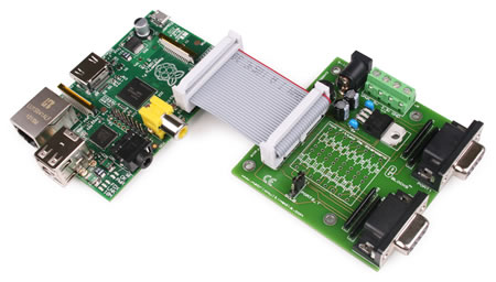

We have a Raspberry Pi GPIO to E-blocks adapter board about to be released. This gives you two full 8-bit E-blocks ports from the Raspberry Pi allowing direct compatibility with most of the E-block range :D
We do need some basic examples writing to do simple I/O if your interested John.
Flowcode for Rasp Pi has crossed our minds :wink:
