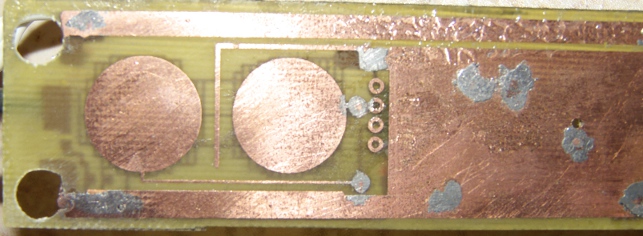

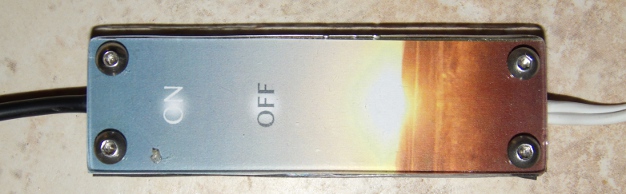

Benj wrote:Here is a picture of the prototype E-block.
Hi I am following this thread with great interest.
I almost gave up on Capacitive touch.
How does this module work?
Is it just a Ground plane at the bottom of the board, and some copper areas on the top of the board?
I am thinking of making such a button for my next camping light. How would you use the board. What cover so that it will still work?
Just a Label or paint?
An interesting thing that I read on the Microchip website is that you can even use a metal cover.
That sounds very cool how would one do this? Could you simply stick a thin peace of metal on an aluminium front panel with epoxy glue, connect the front panel to GND and connect the plate you stick on the back to the Capacitive sense channel?

As I can see from the Application not a Metal over cap sensor is not an easy to make at home since you need to find the right thikness of metal, and also the right spacer.
But the normal Capacitive touch sensor described on the first link looks quite easy. And it can look good too. If you print a nice Paper label and put it between the pcboard and the perspex.
However it would not be too good for a camping equipment, what if the paper gets some moisture? It will not look good anymore.
Could a plastic label also work?
Best Regards:

Now that I figured out how to make a capacitive switch I want to start playing around with it.
Question can I still use the other ADC channels for reading voltages?

I decided to use the original code and modified it a bit to suit my hardware.
Actually I made a pad with only two buttons.
I use the following pins
AN0 for pad one
AN1 for pad two
AN2 is where i put the pull up resistor from vss. Is this a problem? I see this pin is also for vref+
Also I see that the ADC channel is set to FOSC/2 is that not a bit fast? Or does it not matter for capacitive touch?
I am using Flowcode 5.5
I added one line to see the return value and the state value at the same time.
It alsways gives state 0 and return is alsways 255
Is the problem I have due to a bug in Flowcode 5.5 or is there something wrong wit connecting the 1K pull up resistor to AN2

Re: No capactive sensing (CPS) module in FC 5
Hi Uli,
I think this should work fine as long as the +VREF is not enabled. All you should have to do is change the ADC component connection to AN2.
This really needs to be based on your clock frequency. Using the RC conversion method was a bit too slow on my hardware and Fosc/2 was generating good results. Have a play around and see what setting provides you with the accuracy your after.
There is a specific bug for doing this in v5.5, as I say making the DSP stuff more optimized has broken my cap touch demo file.
To fix the bug have a look at the generated C code file and near the top it will tell you which ADC type your chip is using.
Go into the CAL and open the CAL_ADC file. You may have to copy the file out of the program files folder first to be able to edit it.
Find the ADC section for your device - has the same type number and then look for this line of code at the end of the Enable ADC function.
Should look something like this.
adcon0 = adcon0 | 0x04;									//begin next conversion
Cut the line of code out so that the last line is the delay_us function.
Then paste the line of code into the Sample_ADC function just above the while line of code.
Post by Creative25 »
Hi Benj
Thanks for your reply.
I got it all working now. :lol: :lol:
My Pic 16F1939 is running at 16MHZ and I get good results wit fosc / 8 to fosc / 64
With a paper on the pad I get quite big differences in return value in the region of hundreds when pressing it.
With a peace of perspex on top of it I only get a difference of two when pressing, is that still a good result?
Are there other things I can play around with to improve sensitivity when having a peace of perspex over it?
Does this bug in Flowcode 5.5 only affect Capacitive touch, or does it also affect Normal ADC reading.
If I want to read a normal ADC in addition to capacitive touch sensing do I first have to disable The ADC channel that is connected to the 1K resistor?
Best Regards:

The Ground plane is in a grid form, would it help to make the touch pad in a grid form as well.
The question I actually had on my mind is this could one change the macro to read ADC as Int?
The circuit is quite stable but with a difference value of only 2 could you get interference when temperature changes?
Or will the basic capacitance without a person touching always be the same?
Hi Uli,
This doc seems to have some good info on pad design.
http://cache.freescale.com/files/sensor ... AN3863.pdf
To answer your question.
Do not use filled ground planes underneath electrodes area — In case a ground plane is needed, make sure it is not filled. If the plane underneath the electrode is completely (100%) filled, the total capacitive coupling from the ground plane is much higher than the one created by a finger, adding a large offset to the capacitive measurement. It makes the detection of a valid finger touch more difficult.
Yes you can change the ADC read type to int this should still work well.

I think the Issue with the 5mm perspex is stray capacitances or something like that introduced through the thick perspex.
Just after connecting it to a power source it does all kinds of funny things. But after 5 Minutes or so it works perfectly.
I wonder if it will help to make a bigger time difference between measuring the two pads.
The other thing I thought of doing is to make the distance of the pads a bit bigger.
Any thoughts on this will be appreciated.
It would be nice if I can get it to work with any thickness of perspex.
(It looks like 2mm perspex is not easy to find in our area.)
I decided to post some pictures of my Capacitive Dim switch.
I like it so much I think I will use capacitive switches in most of my future Projects.
For the hobbyist it is just the easiest way to go, to make a nice finish.
(79.33 KiB) Downloaded 8292 times
