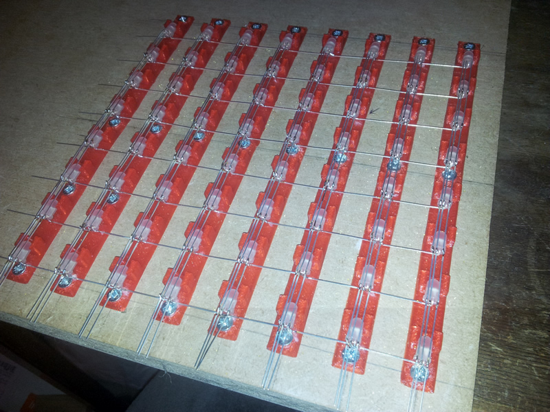

Few updates over the holidays, the cube is now built and tested but not yet wired up to my controller circuit. Maybe a job for tonight.
(366.68 KiB) Downloaded 4498 times
As soon as I have the cube up and running I will publish blog 2 detailing the build and test stage.

i will be watching this project too ,
what is the red jig made from ?
steve

Looking at the structure of the red jig my bet is that it has been (3D) printed :)
― C.S. Lewis
Re: LED Cube
Yep I designed and 3D printed the jig using sketch up but there is a different approach using pieces of wood and bluetac here if anyone wants to do this but doesn't have access to a printer.

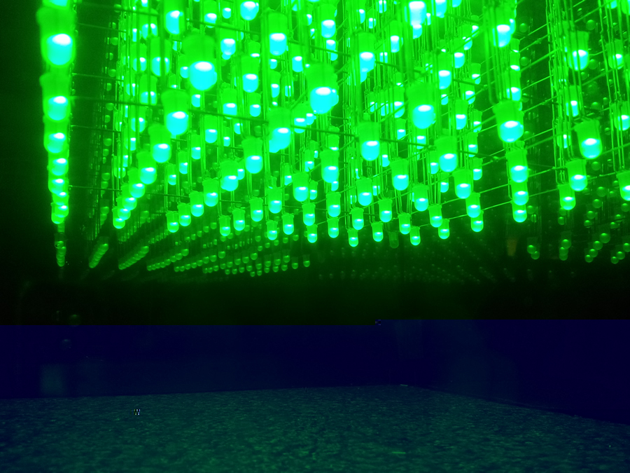

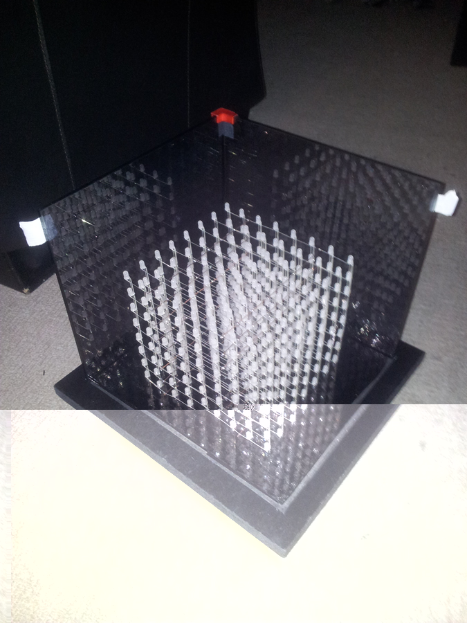

Some more pics, currently using an ECIO40 for testing but likely to move to a new dsPIC EP microcontroller target to do the fancy animations for blog no 3.
Overview of the Cube (upside down) all LEDs white
(454.97 KiB) Downloaded 4449 times
Photo of the neatened up wiring boxed off under the cube
Photo showing some of the reflections generated by adding the mirrored tint to the glass casing
