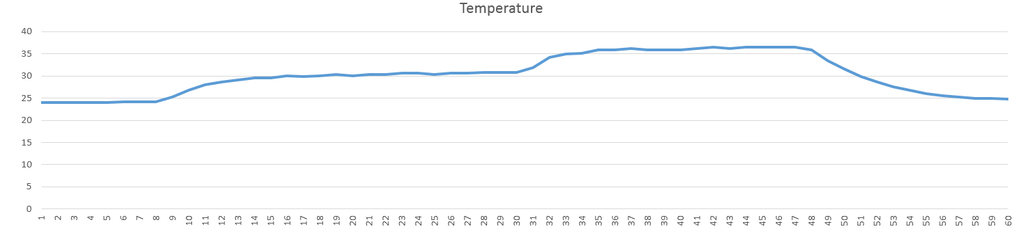

Here is just an example of a graph I did yesterday when I tried this log function with my NIST compensated K-type thermocouple project.
I was lazy and just put a 1 second delay between log updates (will use an INT later) so the X axis is seconds and Y axis temperature
(72.26 KiB) Downloaded 4672 times
Jordy101091
Posts: 519
Joined: Sat Jan 08, 2011 4:02 pm
Location: The Netherlands
Has thanked: 25 times
Been thanked: 188 times
Re: Vinculum 1 USB Host Controller - Component
Post by Jordy101091 »
Well this is awesome.
Thanks for letting us (me) know the progress you made.
Im also happy that the component is working for you.
Regards Jordy
