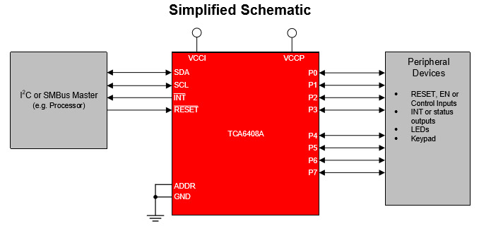

Hi Igor
I am curious as to how you are connecting your device to the MCU. Looking at the data sheet, it shows these connections - four: . On the MCU side, there are four required connection for this device (TCA6408A).
Therefore, I would design my component to have just three connections:
- SDA
- SCL
- Reset

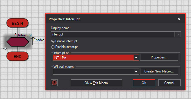

As shown above, the reset pin would be missing from the standard FC7 I2C component. This would need to be included in the design of the new component for the TCA6408A to allow power-up function to work correctly. This would leave only the interrupt connection to by added be the user of the component in their project. The standard FC7 I2C component does not have a reset connection available. Therefore, during the building of your component, a 'Digital I/O pin would be added to handle the reset function for the component. When the component is placed into a project, FC7 will allow the user to select an available pin to perform this 'Reset' function, following the functionality designed into the component.
The interrupt I would leave this off your component design and allow the user to connect the interrupt directly using one of the available interrupt pins on the MCU. The user of your component, when writing their code will place an interrupt icon to allow the MCU to begin dealing with the connected device (An interrupt handling routine), as shown here: Designing a FC7 component for the above device in this way may not suit everyone, but will give you an opportunity to review its performance before getting bogged down in detail. Therefore, get communication to work first, then review.
If I understand the devices start-up function correctly, all port pins of the TCA6408A are set as 'Inputs', may be wrong on that, its how I have read it. Once power-up is complete, programing of the device can begin to set which are input and which are output. From this, the component will have an 'Initialisation' macro which allows the power up function to be performed in a timely manner, then the user can program the I/P's accordingly afterwards by calling further macro calls to the component you will have added during the design of the component.
Hope this helps.
Dave

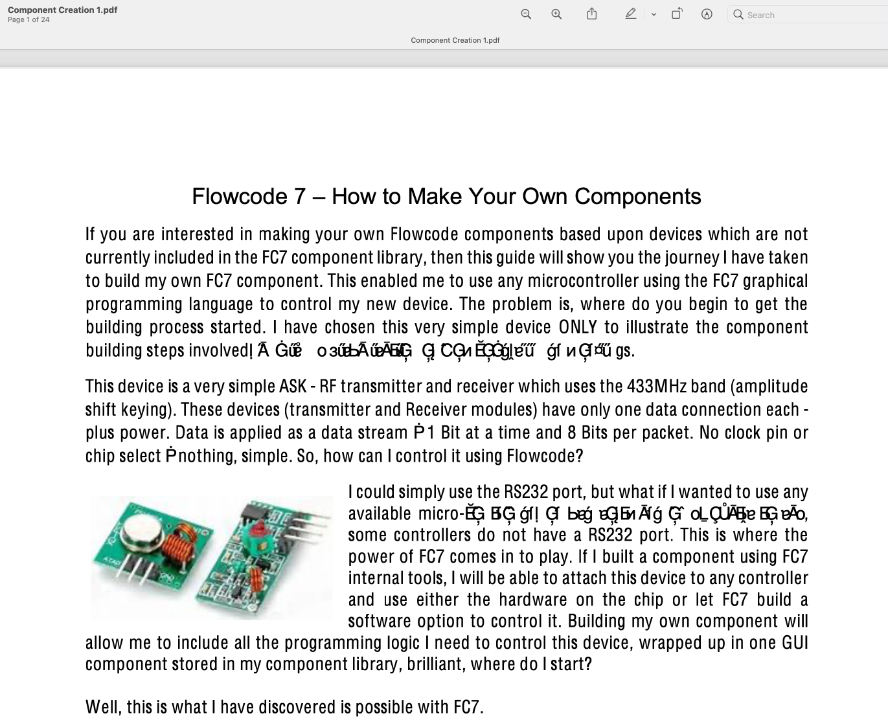

Hi Dave,
I am user of Flowcode 9 and I wonder if anyone has built an up-to-date guide for this version of software.
Also, within your guide they are some strange characters, as I have shown in the attached picture. Is it possible to generate again the .pdf or to share the .doc or .docx instead?
Thank you,
Andreas

Re: Building Components - Step by Step Guide
Hi Andeug
Please find copy of document as requested.
Best Regards
Dave
Best Regards
Dave

Hi Dave
Thanks for posting the document again.
The original, and subsequent ones never opened properly for me due to fonts and what not. Couldn't open in Acrobat or Foxit or anything. Large chunks would be missing.
This opens perfectly and I can now see why it was praised so highly. A good job well done.
Thanks again for posting.
