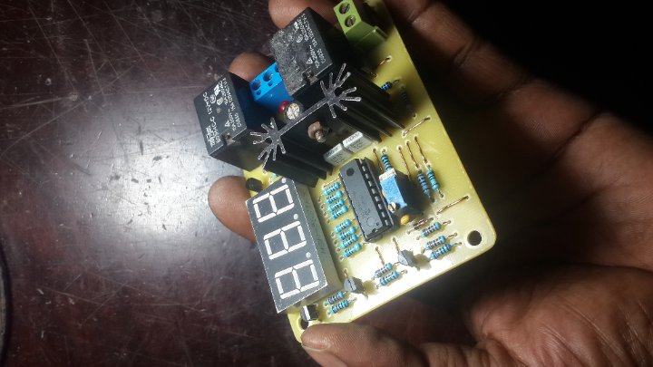

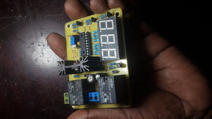

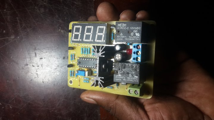

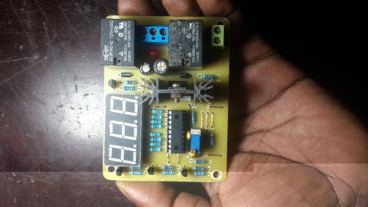

Re: Dc voltmeter 0-55v
Yes mr Benj you must be right i also get such messages some time and some time i reduce on the code then after that am good to go but as you see am in a poor country and getting a number of MCUs to play around with is really had and i really want to see your code work coz am going to study it really slow and get to learn new tricks from it.Thanks allot Mr Benj let me see what i can do to reduce the code may be remove some i will get back to you after in a mean time, below is my PCB design for this small project please look and advise me were i place components wrongly i really love to learn.
Hi Derrihj,
Looks like a nice project, looking at the title of your flowcode project name. "Battery Charge Cut Out"
Are you cutting off the DC charge current ? or using to offer "deep Discharge protection" of your batteries ?
I must admit that i have not opened your project to look so see what is going on and what you are doing with it.
One thing to be aware of and dose catch people out - look at the contact ratings of the relay especially at "Breaking DC" part
looking at the relay in the pictures (by your fingers) it says 10 Amps @250 Vac . I am assuming the relay under this is the same i cannot see the markings on the case.
When breaking a DC load this contact will more than likely be mA when the relay opens the contacts draw an arc then eventually burn away. Fitting suppression doesn't help much as the contacts are trying to break current under load and unlike when switching AC the arc lasts longer until the contact gap is sufficient to extinguish the arc.
With AC the arc self extinguishes as the waveform passes through zero volts.
Have a look at "Automotive relays" they are more suited to braking DC loads but again look at the Breaking current capacity you may find that this is shown in a graph form plotted against voltage follow the de-rating curves.
Looking at the attached data sheet first impressions the relay is rated at 75 VDC and will make 100 A break 60 Amps
if you look at page 2 this tells a whole different story.
@75 VDC the switching current is approx. 750mA
@60 VDC the switching current is approx. 1A
@24 VDC the switching current is approx. 25A
I have personally destroyed the contacts of this relay on a set of fully charged 48 V batteries switching off a 5 Amp restive load performing a battery load test.
If you want to go one step further have a look at MBO relays (Magnetic Blow Out) these have magnets fitted internally and are designed for breaking DC loads the magnets extinguish the arc that is drawn - These are expensive though and follow the orientation show in the data sheet one contact will have a " + " marked on it somewhere.
You don't have to remake your PCB you can simply use the relay on the PCB to power another higher power relay.
Steve
Thanks Steve001 for all the details about the relays, but as you see am not going to switch DC through those relays but rather AC.I designed that circuit to control charging for my 17AH battery and i will not control the DC part no i will control AC power to the transformer tapings,Yes i will have two tapings of a transformer one for High charge and another for low charge to help me do the absorption part before i move on to float in bits to keep the battery between 13v and 13.5v when its fully charged.
