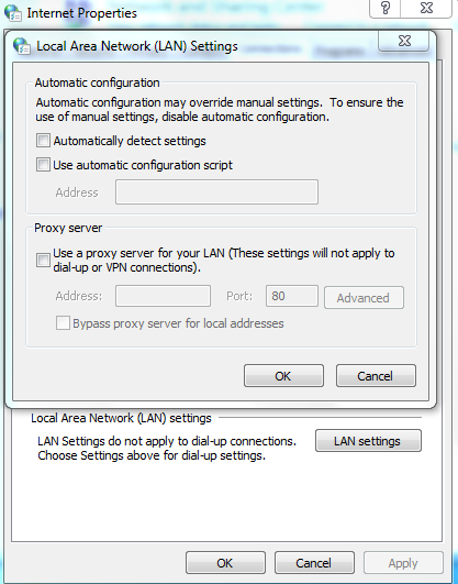

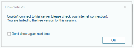

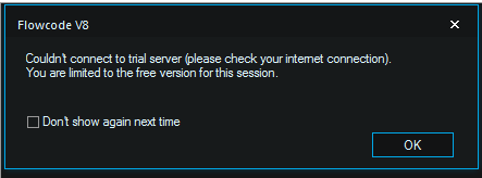

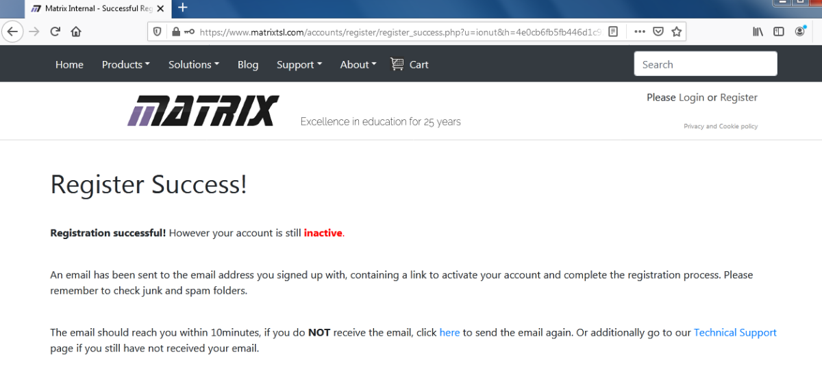

Hello everybody,
Unfortunately, the story repeats itself, the internet connection is ok, otherwise we do not create the account on Matrixtsl. The rest will be understood from the pictures. I think this way of authentication and activation of Flowcode 8.2.2. it is too restrictive. If you missed an internet connection to activate Flowcode you have to create another account, another account involves a different email address and a different phone number, well how many phones to buy ?
All the best !

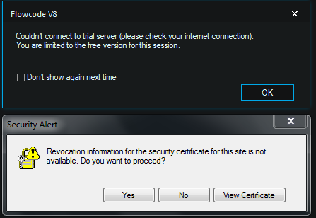

Re: send string
Flowcode not connected to server..png (6.98 KiB) Viewed 18700 times
Comes under
medelec35 wrote: ↑
Wed Aug 05, 2020 4:15 pm
  • Flowcode not got access to internet.
More importantly the Marix TSL servers.
That is the issue
Your browser can connected to the internet but Flowcode can't
For some reason a firewall or antivirus is preventing this from happening?
For that reason I can't help you any further.
DavidA is the Matrix IT expert, maybe he can also help?

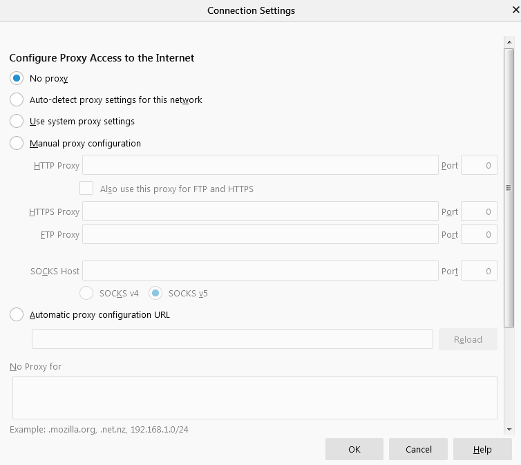

I'm still trying, but I need to create another email address. In the Firewall I looked when I had problems and it seems ok, I will look carefully this time. I will have to create another account and another email address. Thank you very much for your help.

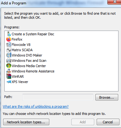

Hello everybody,
Firewall seems to be ok and still the connection problem persists. I don't have antivirus installed. I prepared the new e-mail address but I did not create an account on Matrixtsl because I receive the message that it is not connected and to check the internet connection. The internet connection is ok, I can enter Matrixtsl and any other site.

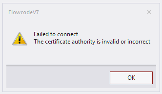

The fourth picture.

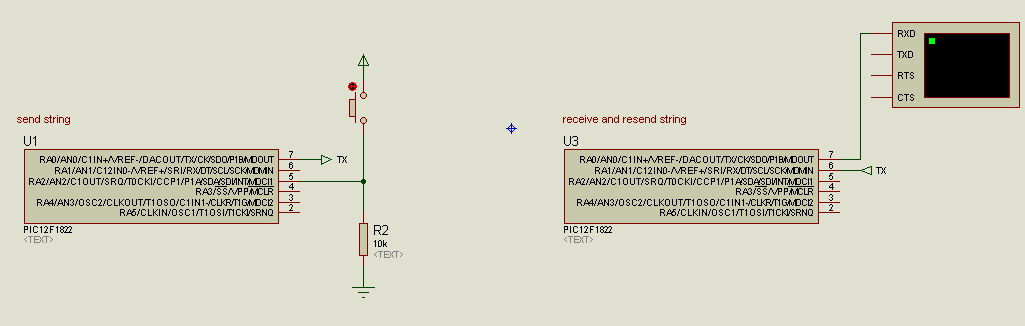

Hi all,
I saw the suggested link, but it's more complex for what I want. I ask for a simpler example, according to the attached diagram, a 12F1822 sends a string and another 12F1822 receives the string and resends it, using UART components. I want hex files compiled with Flowcode 8.2.2.
string send resend.png (16.22 KiB) Viewed 18595 times

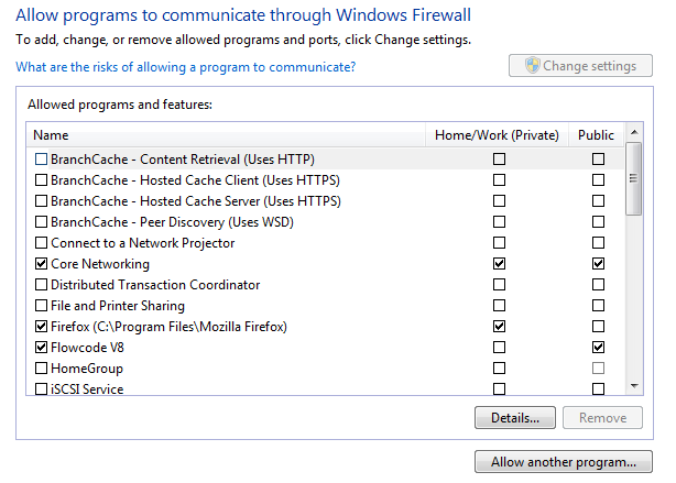

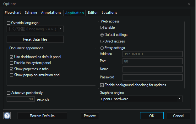

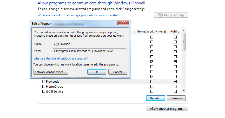

Just a thought.
Within Allowed programs and features, What about Selecting Home/Work (Private) as well?
Also within Flowcode.
Select View, Global Options...
Then select the Applications tab
Make sure both Enables and Default Settings are selected.
0101
Posts: 50
Joined: Thu Dec 12, 2019 3:36 pm
Been thanked: 1 time
Re: send string
Post by 0101 »
Hi Mr. Martin,
I made sure it was ok, see below.
con set.png (34.89 KiB) Viewed 18547 times
web access.png (29.16 KiB) Viewed 18547 times

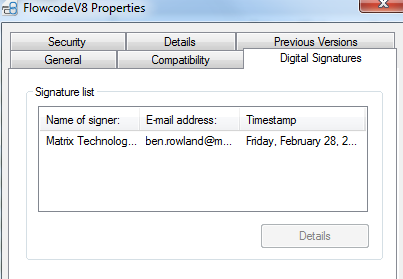

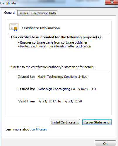

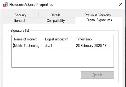

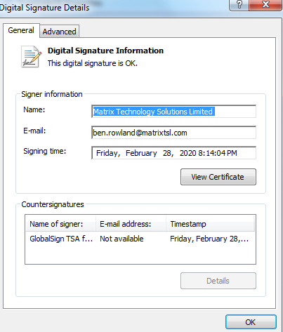

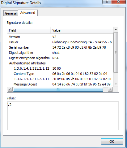

Re: send string
I notice that the main thing that could be at fault is this.
I downloaded version 8.2.2.15 from here: https://softdeluxe.com/Flowcode-144164/download/
Please can you uninstall this version and download the version direct from our website from the link below. I wonder if the version you have installed has somehow been tampered with?
https://www.flowcode.co.uk/flowcode/download/
Normally it just works without having to mess with any settings so this is the only thing I can think of.
It would be interesting to see if the flowcodev8.exe file still bears our digital signature.
0101
Posts: 50
Re: send string
Post by 0101 »
Hi Mr. Ben,
I uninstalled version 8.2.2.15 earlier and installed version 8.2.2. from your website. Look below.
signature 2.png (33.59 KiB) Viewed 18536 times

Post by 0101 »
Another picture.
certificate 2.png (37.97 KiB) Viewed 18536 times
Re: send string
Aha ok so your using the official version now but that is still having problems. Very strange? Hopefully David is back in today. I'll ask him to have a look for you.
