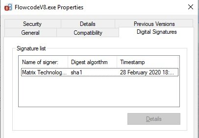

Re: send string
Posted: Thu Aug 13, 2020 4:57 pm
by Benj
I notice that the main thing that could be at fault is this.
I downloaded version 8.2.2.15 from here: https://softdeluxe.com/Flowcode-144164/download/
Please can you uninstall this version and download the version direct from our website from the link below. I wonder if the version you have installed has somehow been tampered with?
https://www.flowcode.co.uk/flowcode/download/
Normally it just works without having to mess with any settings so this is the only thing I can think of.
It would be interesting to see if the flowcodev8.exe file still bears our digital signature.
Re: send string
Posted: Thu Aug 13, 2020 6:20 pm
by 0101
Hi Mr. Ben,
I uninstalled version 8.2.2.15 earlier and installed version 8.2.2. from your website. Look below.
Re: send string
Posted: Thu Aug 13, 2020 6:21 pm
by 0101
Another picture.
