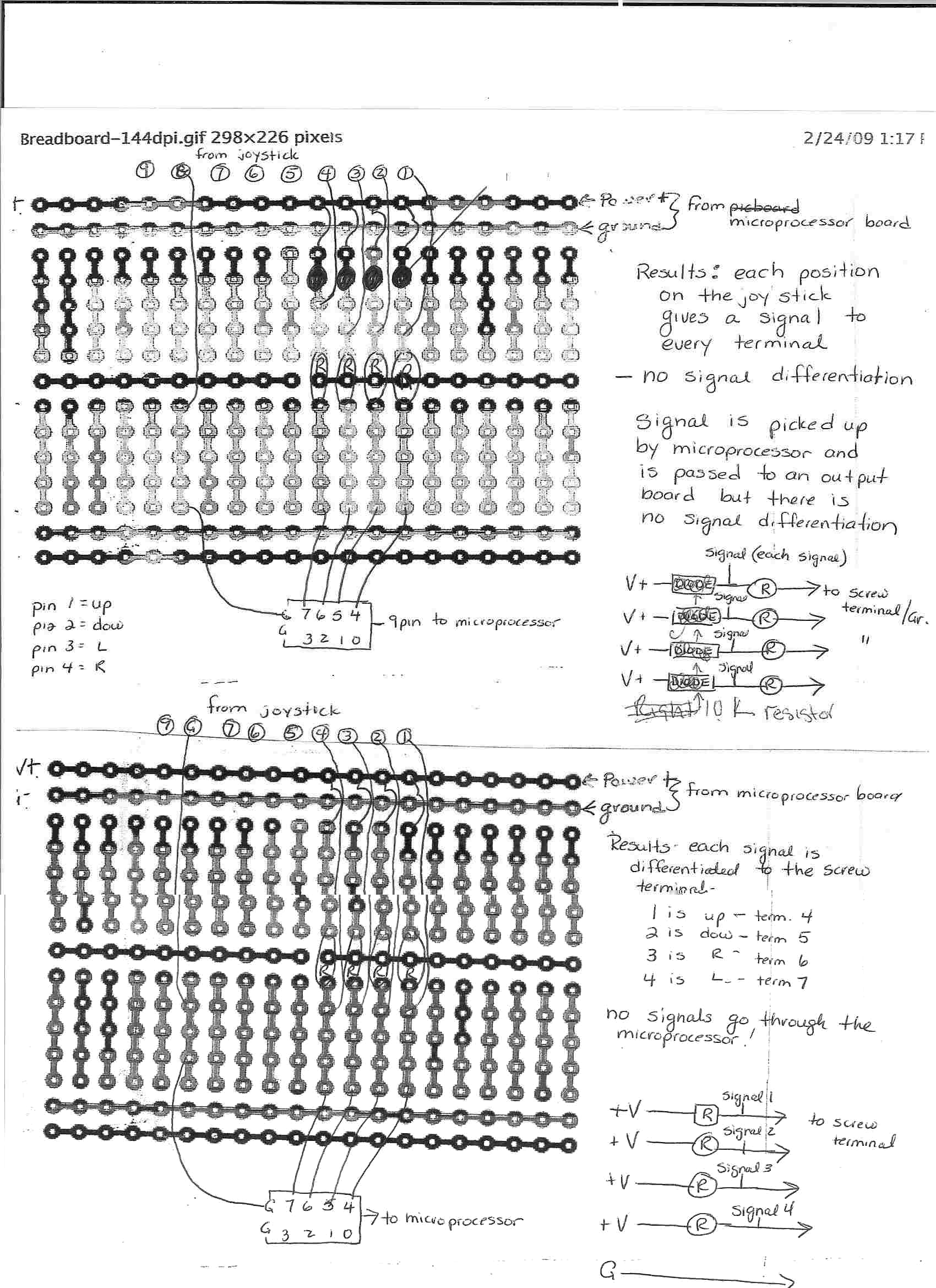

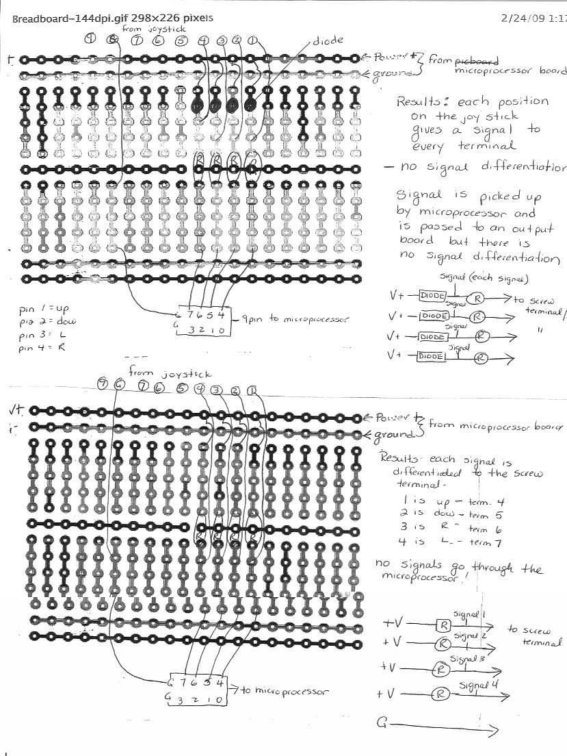

Could someone please review this wiring diagram and tell me why it doesn't work.
Problem 1 On the encoder side of the optocupler power goes to terminal but does not pass through to the ground when a signal is present. No signal is picked up and sent to the encoder.
Problem 2 On the signal/ joystick side of the optocoupler any signal from the joystick (up, down left,right) will send a signal to the optocoupler at all the positions. We can't differentiate between signals. Is this a grounding issue? All grounds from the optocoupler are going back to the ground wire from the joystick and the ground from the multiprogrammer board.
- Optocoupler output circuit
- opt%003F_2.gif (93.21 KiB) Viewed 10103 times

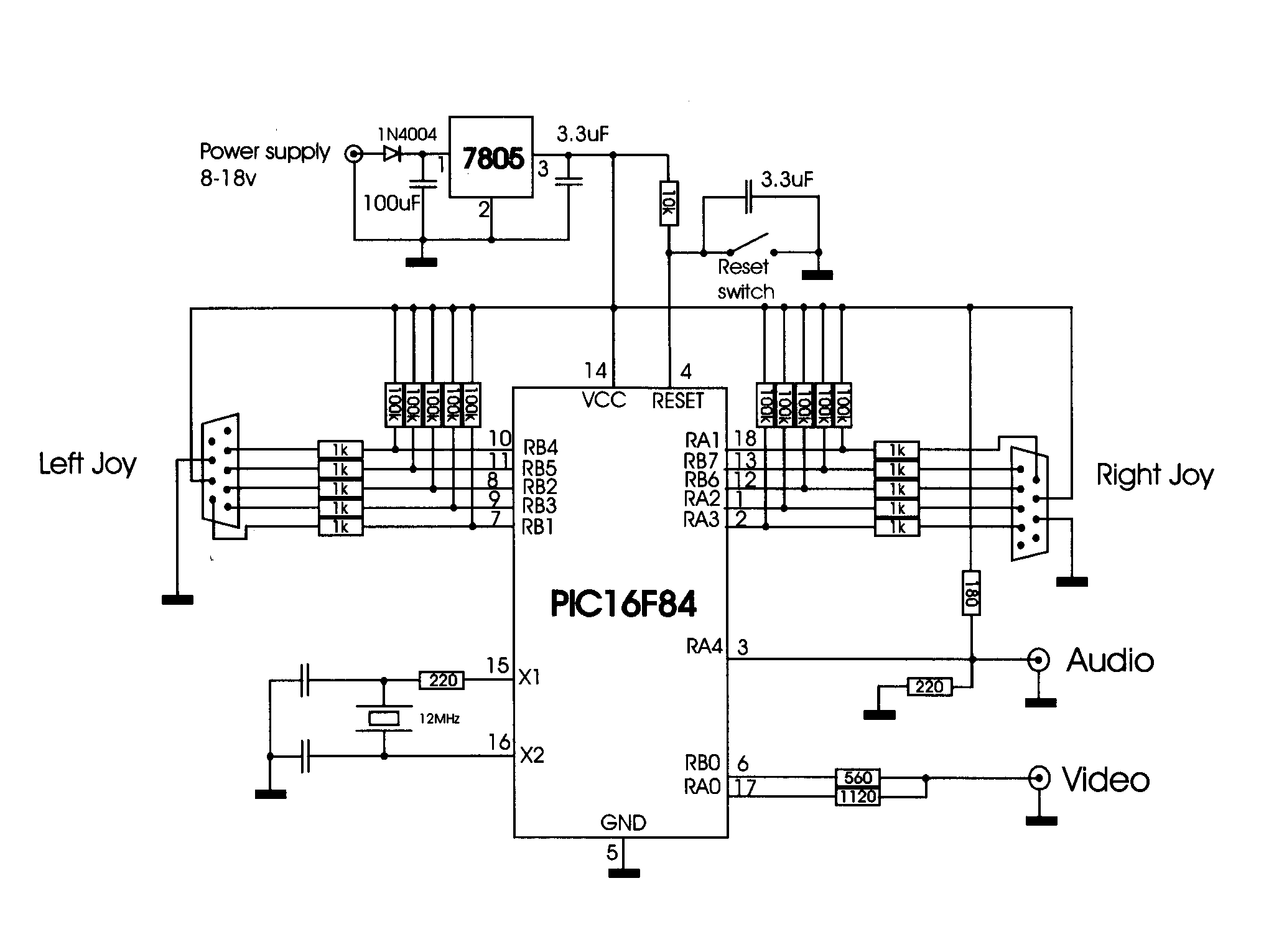

Re: Using Flowcode to pgm an atari style joystick
Hello
It is a little hard to work out what could be going wrong here as we only see a small portion of the schematic.
Here is a schematic showing a PIC and a PS2 controller
http://www.curiousinventor.com/guides/ps2
And here is another good looking guide.
http://www.gamesx.com/controldata/psxcont/psxcont.htm
Neither seem to be using opto isolators, diodes or resistors between the controller and the chip in their design.
Hello
The PIC can detect two kinds of signals. Digital and Analogue.
Digital signals can be represented as a voltage. On a standard 5V PIC a voltage over around 2.5V represents a logic 1. Anything below this should be represented by a logic 0 but there is a bit of a no mans area in the middle that should be avoided.
Analogue signals require the PIC to have an onboard A to D converted and then have special analogue capable pins. The analogue pins are read by performing a routine to sample the data (eg in Flowcode you would use the ADC component to do this). The voltage is converted into a 8-bit or 10-bit signal depending on your device and the routines you call in Flowcode. An 8-bit number would have 0 representing 0V and 255 representing 5V.
This should help you to get to the bottom of why the voltages are changing but not the signals going into the PIC device.
Also note that the screw terminal board has 220R resistors on each input therefore your 1K resistors may not be needed.
As a final suggestion if you are using breadboard to prototype your circuit then please be aware that often the power lines have a break in them half way which will need to be linked across. This may be stating the obvious but it has cought me out before.

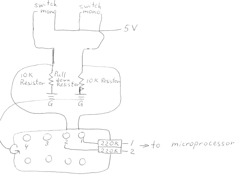

I tried setting up the switches going into the screw terminal with 10k pull-down resistors.(monotoscrew.jpg) I get separate signals, but they don't appear to be going into the PIC. Is 10k too much resistance for the screw terminal?
- monotoscrew.jpg (65.33 KiB) Viewed 9839 times
Hello
I see you have 220K resistors are these the resistors on the screw terminal board? If so then they are 220R resistors. Otherwise of 220K is correct to your design then I suggest you remove them.
The 10K pull down resistors should be fine to give you a logic 0 or 1 when the switch is pressed.
How are you reading the switches? It might be easy if you simply read the entire port connected to the screw terminal E-Block and then output the entire byte to a port connected to a LED E-Block.
