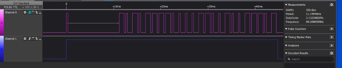

In the Evil Lab today, which is freezing, I knocked up a generator using PIC16F1939 simply because it was in the multiprogrammer and connected to a Comboboard.
Four buttons:-
1) Sends a Preamble (1x h, 31 x l)
2) Sends a "1" (3 x h, 1 x l)
3) Send a "0" (1 x h, 3 x l)
4) Sends a transmission comprising of Preamble, address, data.
Did I mention Elsa wants to store her ice-cream in here? Luckily my collegue turned up with what loosely can be described as a jet-engine. Kerosene powered and attempts to fly off if not secured.... Soon had the place toasty, especially for me up in my Ivory Tower.
I set the address as 1010 1111 0000 1100 1001 with data as 1101.
Code is not complicated, very basic indeed, nothing fancy here. Simple delay for on/off times etc which would need to be tweaked to take into consideration the time taken to process code (you could calculate such but my excuse is that the grease lubricating my slide rule has frozen and I'm sticking to it...
To send the transmission we need to send each bit at a time so we need to check the value and send the appropriate bit. I chose to send MSB first. Again not a fancy piece of code and more functional rather than an example of how to code so please feel free to make it better
To check things are working as I hoped, I added in a couple of calculations to reconstruct the address+data being sent, bit per bit. All good so far when simulating.
I have two pins active C0 and C1. C0 is the transmission output and C1 is a reference. The reference goes high at the beginning of any transmission and low once complete. This gives a handy frame of reference to measure against.
Unfortunately by now we had run out of jet-fuel so temperature was dropping rapidly....

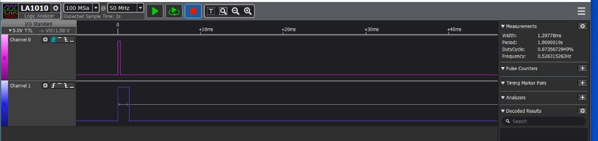

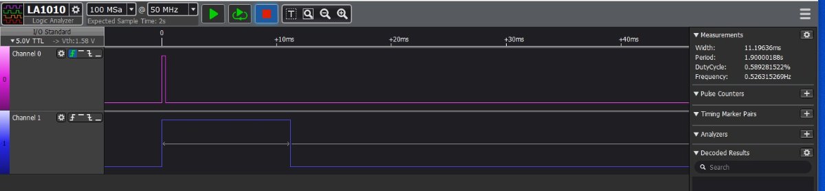

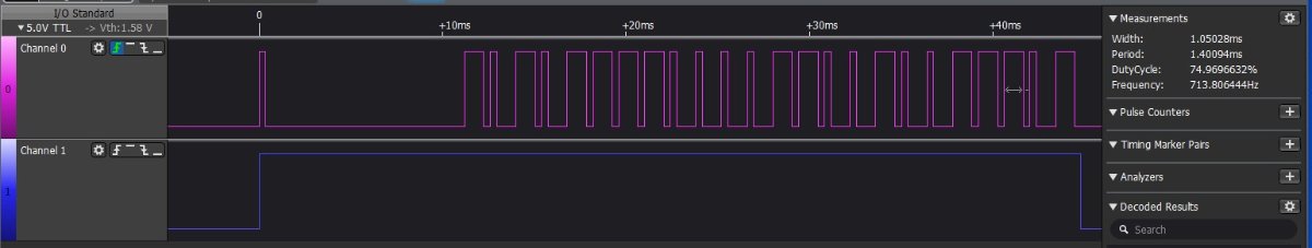

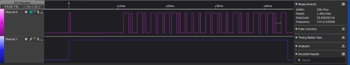

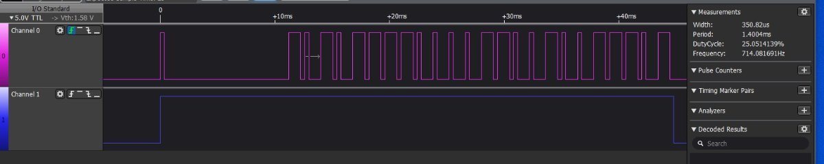

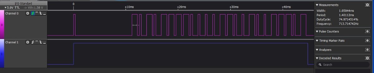

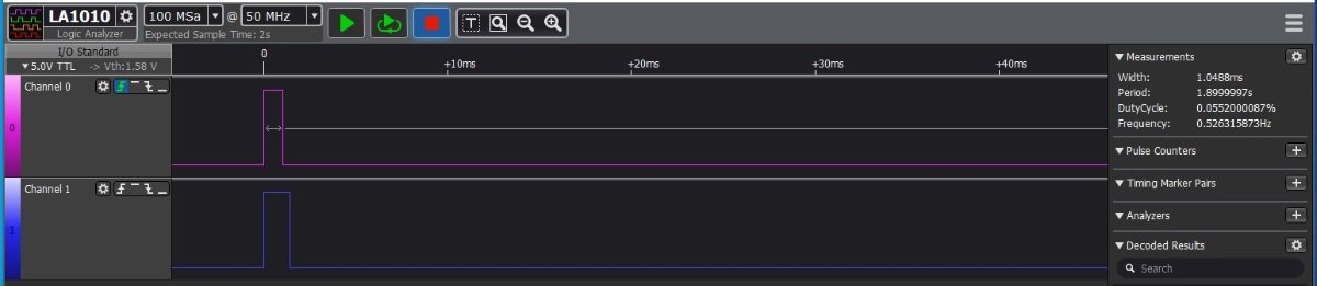

Connecting an analyser to the pins the code worked pretty much as expected, but the expected tweaking of delays was affected by the rapid fluctuation in temprature (degrees per minute). You can see such in the attached traces. The difference in accuracy between working on "preamble" (button 1) to sending the complete transmission is a few microseconds.
Some analyser traces:-
Preamble (button-1).If you look at Ch1 (reference) you can see that instead of 11.2mS we are 3.7uS short. An hour or so earlier it was fractions of a uS out.
"1" (button-2). The high is 1.0488mS but earlier it was 1.050x. Again nothing but drift.
"0" (button-3). The "0" sends a few uS shy of 1.4mS due to temperature changes
Entire transmission of preamble, address and data which took 44.786mS to send which is 14uS short of calculated. Not too bad as I'm also keeping an eye out for polar bears.....
Preamble is 350uS high followed by lows, taking fractions of a uS off of target time for such (11.2mS)
The next two traces show sending a "1" at the beginning of the address and near the end of the transmission, out by fractions of a uS
The next two show "0" again at beginning and near end.
For my needs this is more than accurate enough, and I'll probably modify to repeat the address+data a further two times to further mimic the real transmission. Next I'll try and decode based on the above transmissions.
Four buttons:-

I don't have a Combo-board, however it was interesting to look at the scope diagrams of a different states of Tx transmission.
My interest right now is to find the Preamble during the Tx in the Kerui PIR packet.
If total length of Preamble = 11200uS.
If there will be no noise during Preamble part (from SYN470R chip) I can use Nano to get it.
But right now I cannot.
My testing program (based on mnf program HC12.fcfx) constantly in the error state of 'floating' output of SYN470R chip.
I am working on a new PCB for Nano + schmitt trigger to clean up the noise.

As I don't have my scope I can only guess that the output from SYN470R Rf chip signal looks like the disturbed oval without any square edges. My program doesn't pick it up and cannot measure 350uS between the raising and falling edges.Because of the noisy TTL signal out of SYN470R I constantly see the faulse triggering (mostly when pulse duration < 350uS).

Just had an idea for making this more 'robust' concerning noise.
All the pulses are fairly long (350us+) - so if the pulse is less than a 'threshold' value (say 50us or 10us) then ignore it. This is easily done near the start of pin change with
if pulse < threshold error_count = error_count + 1 else 'handle as before'
The number of errors can be used to give the signal a 'rating'

Re: Did you get the code I posted to return anything?
I have to change pinB5 to pinD2 in your code as D2 is connected to output of SYN470R Rf chip.
I run this code on Nano a few times by using the Tx remote controller with 24-bit code (1527 protocol). No return.
Re: It should be possible to run the code in simulation
Sure. I have to wait for the opportunity to do that.
About the RCSwitch library.
I works well with the noisy ttl signal from SYN470R Rf chip.
That is why I am trying to understand how it works.
Preamble
I think I should stop trying to get the data block and instead concentrate on the Preamble stage.
If I can manage get the Preamble, that would be a success.
Preamble
