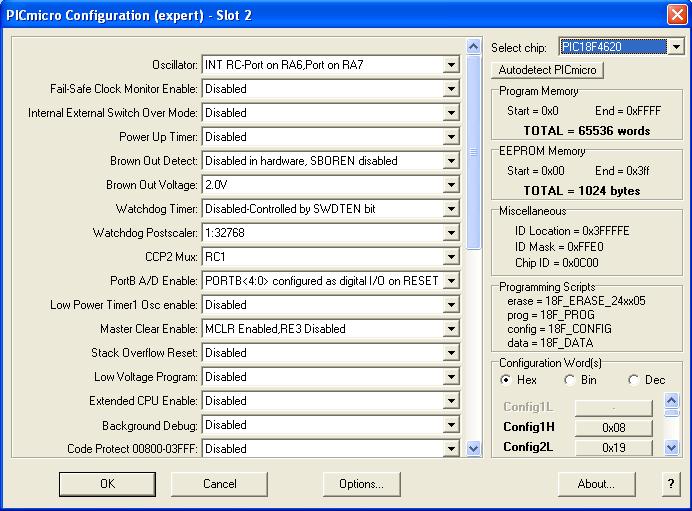

I have modified the servo program to run on a PIC18F2620, using the internal 8MHz oscillator, and configuring the PLL to run at 32MHz.
MultiServo2_Fx620.fcf
(10.49 KiB) Downloaded 1595 times
The program was tested on a PIC18F4620 and has been successfully re-compiled for the 18F2620, but not tested.
I have attached the configuration screen as a jpeg. All the options below the ones shown are set to 'disabled'
I have also implemented two large data arrays using the rom char *var = {...}; command. The arrays are limited to 256 bytes each, but are placed in program memory.One is defined in a Flowcode block, the other is included as a separate header file - curve_data.h.
