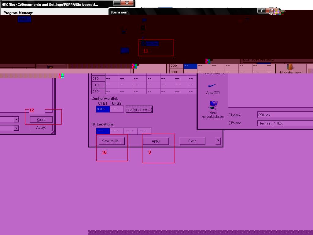

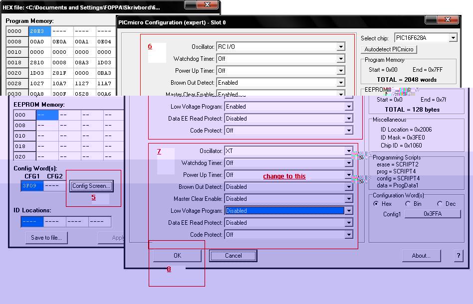

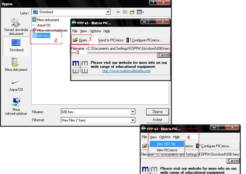

I have had great trouble getting 16F628A to work.
But as I got for me to look a little extra on the PPP and I noticed that my changes did not come down to the chip.
So I tested this and did it well.
When I programerar chip, so I use pickit 2 and not pickit2 by Flow Code.
A bit difficult for me to explain.
So I did some pictures showing how I do to get the chip working.
It seems that flow code not loading my changes I make in the PPP.
Or am I wrong again
Foppa

Hello

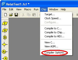

PPP runs in a few different modes. If you run PPP externally from Flowcode then it will not change the PPP used by Flowcode etc. To change the PPP settings from within Flowcode use the Chip -> Configure menu. You can then click the options button from here if you need to edit the programming options from within Flowcode.
It is just so I can not find on the options button "Chip -> Configure menu ->options "

The path to the Flowcode programmer settings should have read 'Chip->Compiler Options...'
The programmer settings are then available on the Compiler Options panel.
