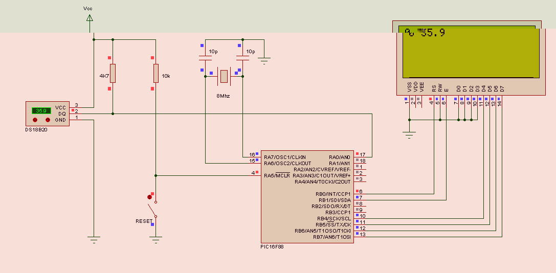

Dear Eric,
I use the EB-006 board with PIC16F88
You said:
>1) Be sure port A is set to digital, not analogue.
I linked the 1-wire to PORTA0. Do I have to do more?
>2) I noticed that the one wire routines in flowcode don't work if the oscillator is below 4 Mhz. Probably due to timing issues. Timings are software generated in flowcode.
I tried the oscillator configuration XTAL (HS) with the result constant 85.0 degrees and I tried internal with osccon= 0x70 (8Mhz) and osccon =0x40 (1Mhz) both with results into bus error message.
>3) Furthermore I noticed that frequent interrupts will disturb the one wire timings. Try to disable interrupts temporarily to find out.
I used just your program with no additional interrupts.
What to check now?

Hello Jan,
Some things are not clear to me:
1) You use C-code: osccon=0x70, meaning oscillator freq is set to 8Mhz, but in the project options you assign the clockspeed to 19660800 Hz. I removed the c-code.
2) For some reason ( I don't know why ) I don't get my lcd to work with the connections you had setup in the lcd properties (PortB0 -> PortB3 for data, PortB4 for RS and PortB5 for Enable) . When I changed the connections to my default (PortB4 ->PortB7 for data, PortB0 for RS and PortB1 for enable) the lcd worked fine. No idea why this is happening.
3) From that moment, I get the readout from the DS18B20
Best regards,
Eric
Best regards,
Eric

Dear Eric,
Thanks for the very nice hardware scheme. The only difference is that you powered the DS18B20 directly with Vcc. I connected the Vcc of the DS18B20 to the GND, meaning that this IC will be powered by means of the DQ line.
I tried your (3-wire) setup, and now it works!!! Still leaving the question why the 2-wire setup does not work (see attechment)? It returns the value 85 C, which is the power-on reset value of the temperature register of the DS18B20
(see datasheet: http://datasheets.maxim-ic.com/en/ds/DS18S20.pdf ).
Remark: I did not installed the MOSFET, which can be the reason of the fault. It is not clear for me how to activate this MOSFET by the PIC.
I found a possible solution: Replace the pull up resistance by 1k8 instead of 4k7 and one do not need the MOSFET.
(ref: http://www.embeddedrelated.com/groups/b ... w/6820.php)
Added later: I'm sorry, but it did not work afterall with my hard- and software. I still get the default temperature reading of 85.0 C.
- DS18S20-2 wire setup.jpg (29.29 KiB) Viewed 16967 times

Hello Jan,
I am glad you have results now.
I never tried the 2-wire setup. After all, I am using standard UTP cable, where I have plenty of wires.
But I think that if you want to use the 2-wire setup, you need an extra Port to generate a hard pull-up via the mosfet during the temperature conversion stage.
A simple resistor pull-up will not do the job, hence your 85° readout.
I am not sure the Flowcode routines are build that way that they provide provision for a hard pull-up.
Maybe Ben can confirm this?

Dallas semiconductor descibes:
"The 1-Wire bus must be switched to the strong pullup within 10μs (max) after a Convert T [44h] or Copy Scratchpad [48h] command is issued, and the bus must be held high by the pullup for the duration of the conversion (tCONV) or data transfer (tWR = 10ms). No other activity can take place on the 1-Wire bus while the pullup is enabled."
That means that in the flowcode an additional output of the PIC must switch in the time frame as given above, to control the MOSFET. I would try it, but I do not have the detailed knowledge of MOSFET's (which to be used and resistors for the gate?)

I would output High on the pin the one wire device is connected to instead of making it float and pulled p by the resistor. I really don't know if this works the same as making it High with the mosfet but it sound to me as working the same. Remember to disable the output on this pin before trying to send new data over the line.

Dear Albert,
It works now with the following hard- and software:
1) Hardware:
The DS18S20 and DS18B20 needs one I/O port for data communication. The 1-wire setup requires both GND and V+ of the DS18X20 to be connected to ground. The 1-wire needs always a pull-up resistance of 4k7 to V+. In this setup a p-MOSFET, like eg. IRF9630 was used with the S(ource) conencted to V+(max 5Volt), the D(rain) conencted to the 1-wire DQ and the G(ate) directly connected to one additional port of the microcontroller (I used port A1, see software). Additionally a 1M resistance between gate and V+ is used to decativate de MOSFET, but perhaps not necessary.
Futher hardware: E-boards EB006 and LCD EB005 with PIC16F88.
2) Software
The software needs the p-MOSFET to be activated for a special time span, between 10 usec and 750 msec (can be shorter only for DS18B20 in special cases, see tCONVERT in datasheet)
2a) Flowcode changes:
Deactivate the MOSFET directly and the beginning of program (PortA1 high)
2b) C-code changes:
Change the C-Code of the component macro 00_tx_byte of the 1-wire into: See attachment
Remark:
a) This works only for port A1 connected to the gate of the p_MOSFET. If you use an other port, you should change this C-code in agreement.
b) In flowcode manage the PortA1 after DS_1820_Start_conversion, does not work, because it is to late, because this macro waits to long ( up to 1 sec), while the MOSFET must be activated within 10 usec, after sending the data byte.
c) It works now up to 2 sensors on the 1-wire bus. With 3 sensors I get for all 3 sensors the default tempearture value of 85 C. I''m still puzzling why. Does someone has an idea? (Now 2 sensors works correctly and the third is still not working=85 C ????)

With some help of the forum of http://www.elektor.com, I found that I used a relative large p-MOSFET *), which can cause additional delay's. With this knowledge, I delete the 5 usec delay in de C-code of de macro oo-tx_byte, to start the p-MOSFET. Now it works fine, even with 4 sensors.
*) Note: I used p-MOSFET IRF9630 (2A) but advised is to use BS250 (250 mA). I will try it and keep you informed.
*) Note added July 7th 2010: It works perfectly with the IRF9630. But I get error messages when using the BS250. I do not know why?
