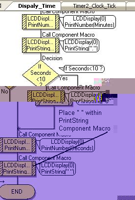

nmindana wrote:The seconds clock displays a thrid digit for eg: 450 after some time has lapsed.
You could add a LCD PrintString component macro, with " "
(two sets of speech marks separated with one space).
Try that and let me know how you get on please.
