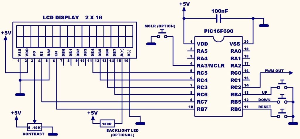

Here is the circuit diagram of project. I hope that will be usefull to you, especially in connections of LCD display.
Thanks for your attention
Fotis

wow thats alot of work, its gonna take me a while to understand everything, i havent progressed to the point of displays yet other than the one you seen of the counter pcb which doesnt count because it logic and 7 segment, its something new and is gonna be fun, how do i make the injection counter part work with the display counter, is that two chips? now this may sound funny but im a newbie--> this is a theoretical question, if there is 18 pins on the chip and you could break that down to 9 inputs and 9 outputs by setting pins up that way, so there would be 9 different programs running at the same time,is that possible? if so i have no clue how it could be done if the flowcode is only written in a vertical line from top to bottom that goes from step 1 to step 2 to step so on, i dont think it can be because there is only one W register, it would have to run everything in a line like written in flowcode, so it would have to do the programs interwieved together as one(yea im confusing myself here since i dont know what im talking about yet) a go to box cant run two pins programs at the same time can it? go to boxes are just ends of desisions where one desion can go to if the situation arises, like a way to make everything neat and small, is the correct

fotus- the way you did the lcd display was confusing, your the man so i know you did it that way for a reason....i hacked it up a bunch and came up with this? can i do it this way? it seems to have no screen flicker, but does have this weird deal where i get extra letters when i make a full rotation?
- can i do it like this.fcf
- (10.5 KiB) Downloaded 282 times
- fotios
- Posts: 458
- Joined: Mon Feb 08, 2010 10:17 am
- Location: Greece
- Has thanked: 109 times
- Been thanked: 117 times
Re: values?
Hi Brandon
You should know that the LCD printing is a seperate task. You should not mess up it with the pulse output task. Otherwise LCD might shows wrong indications. The attached fcf is the corrected version.
Fotis
Fotis
- You can do it like this.fcf
- (17 KiB) Downloaded 337 times
Best Regards FOTIS ANAGNOSTOU

alright its starting to make sense except a couple points... i dont understand the voltage change decision (if voltage above or below OLDvoltage)? next- how can the decision variables be the same (voltage= ) for the pulse section and display section....... next- what is the OLDvoltage calculation, is that there because you cannot have to variables with the same name so you named it old but is referencing the original voltage pid making all the voltage= decisions work off the same voltage=2*voltage/255 calculation?........ and why is the old voltage calculating box after the display that has already run? ..... thank you for putting up with my non sense
