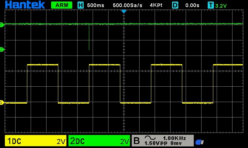

Re: Download the program for the device via the Internet.
Good afternoon! Unfortunately, the version about 8 MHz has not been confirmed. The signals are the same-there is a familiar signal on the Tx pin, but there is nothing on the pin where the LED is connected. But then another creative idea was born, but what if sending the "U" symbol was done outside the LED flashing cycle? I will be able to try this version a little later, now I need to move away.
Sorry, I checked the version before I read your answer....You wrote that there is a connection between the delay with which the LED flashes and the frequency of operation of the controller. This is the first time I've heard about this at all, can I drop a link to this material?
- test_led_PB1_8MGr.jpg (59.55 KiB) Viewed 79189 times

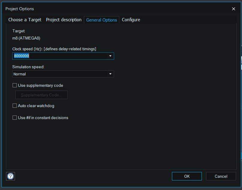

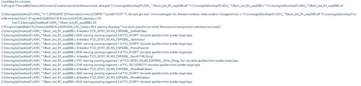

Flowcode Wiki will explain better than I can the setting. FC has no way to know what frequency your chip runs at unless you tell it. If your clock was x-MHz but you tell it y-MHz then all timings including delays and communications will be very, very wrong.
I think when you sent me a correct trace a few days back, you were set at 16MHz (which is I think what most Mega8 run on).
gilanetugila

Good evening! Unfortunately, the quantity has not turned into quality. In all the tried programs, the signal was visible only from the Tx output, from the B1 output where the LED was connected-nothing came. I tried sending the "U" symbol at the end of the program and at the beginning of the LED flashing program, and as in your example, in the middle. At frequencies of 1 MHz, 8 MHz, 1.8432 MHz (external quartz). I even checked the LED flashing separately without the esp8266 software module working-the LED was flashing. Most likely, the problem is in the esp8266 module, but here too, not everything is so clear-the LED does not work in almost all cases (it seems to blink only when connected to pin C1).

Good evening! You wrote about the possibility of the atmega8 controller operating at a frequency of 16 MHz, I have heard about this possibility, but I do not know how to turn it on...I use an online fuse calculator for avr controllers and there is no such feature there either.
I very much doubt if you have a problem with the ESP module.
If you refer back to the posts you made on 22nd of May at 7:50am and 6:50pm you will see that you did at some point have a one-second flash operating correctly. What settings were you using then?

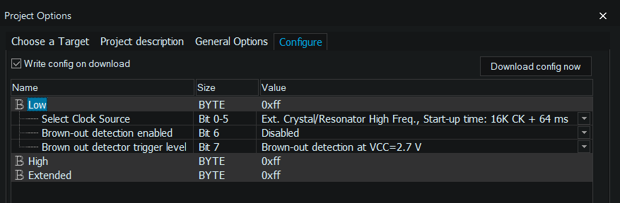

Earlier I didn't have access to my PC, now that I have I see that your chip has as a default a speed of 8MHz.
Build > Project Options is where you will find details
Unless you get this sorted then very little you do will work. There is no point is trying other pins or moving code around as this is a fundamental setting that must be resolved before you can do anything further. Check your crystal is connected correctly and settings.
Until you can get a correct one-second flash operating (on any pin) nothing will work as you hope.
Not used FCv8 for a while, forgot to include this.
Build > Project Options > Configure
Here you can select the clock source from the drop down list.
What crystal are you using? It will usually be marked on the case? Didn't you mention in some post you were using a very low value, around 1.8MHz or the like? Your last chart showed a clock speed of 1MHz but if you are actually using 1.8MHz then as per previous posts you will have issues.
You really need to confirm the value of your crystal and set the clock speed to match.

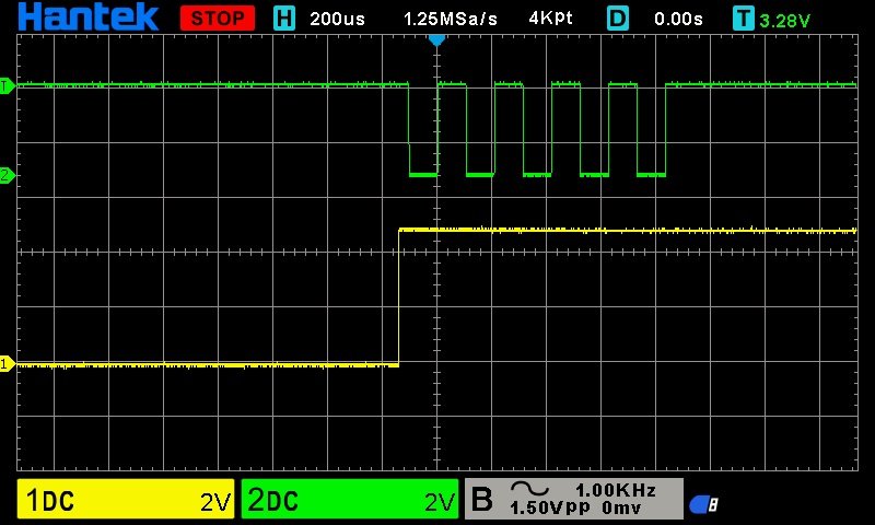

Good evening! In general, if you look from the side of a person who has not used the FC program, but understands a little how the technique works, at the sight of our experiments on sending the letter "U" using the esp-01 module only from the program, but in reality this module is not connected and the controller faithfully sends this letter, this person should have hair on his head to move, and the question in my head is "what's going on here, why the Inquisition doesn't work ...". I decided to conduct an experiment-I replaced the esp8266 module in the program with rs232. They have the same protocol, you say, as if you know...But in reality, sending the letter "U" using rs232 or esp8266 is a different combination of pulses. But! what pleases me is that the LED flashes perfectly when sending the letter "U". I haven't read your letter yet, I'll send mine now and read yours.
- Green graph sending U by ESP8266, yellow graph LED.jpg (60.19 KiB) Viewed 79027 times
- Green graph sending U over RS232, yellow graph LED1.jpg (59.67 KiB) Viewed 79027 times
- Green graph sending U over RS232, yellow graph LED.jpg (61.05 KiB) Viewed 79027 times

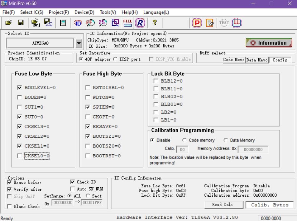

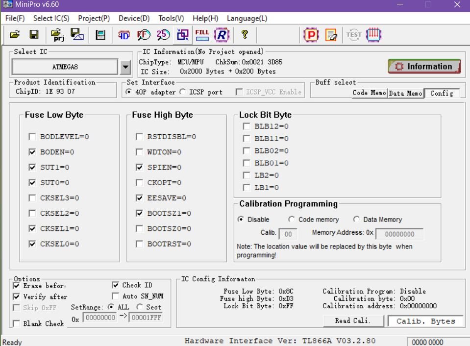

Good evening! Thanks for the hint, but I have never used the FC program settings to program the controller's operation parameters (except for setting the frequency of the crystal in the program), because some kind of special programmer is needed there. And I had TL866CS when I bought it, then I changed it and in theory it now has other letters at the end, but it's not about him. As for the crystal settings, I will now show them in the attached files. Well, in principle, they may differ slightly depending on whether the controller is turned on at low voltage or depends on the start time of the program.
Good evening! As for the configuration of avr controllers, here is one of the few links to online resources to quickly set the desired values and not bother reading the instructions too much.: https://www.engbedded.com/fusecalc/
The screenshot above, with the yellow trace showing a perfect one-second flash with the green blips every second is exactly what you should have and when you zoom in on the blip you are indeed getting a U. This is good as it means your chip is running at the correct clock speed, which is extremely important. I cannot over emphasise enough the importance of correct clock settings and a one-second flash test to verify. If this very simple test fails then you cannot expect anything else to work correctly. It's like running out of petrol in your car and expecting to get it working again by inflating the tyres...
Take note of whatever settings you used to obtain these traces including the associated Flowcode ones as clearly they are correct for your chip with whatever crystal you are using. Can you post your FC chart too, the one that gave you these correct traces?
Flowcode can pretty much do all you need to get things running but as I've said before I'm not an expert on an ATMEGA8 and I have never programmed one other than on a development board such as early arduino. I'm unfamiliar with programming directly.I have never used the FC program settings to program the controller's operation parameters (except for setting the frequency of the crystal in the program), because some kind of special programmer is needed there

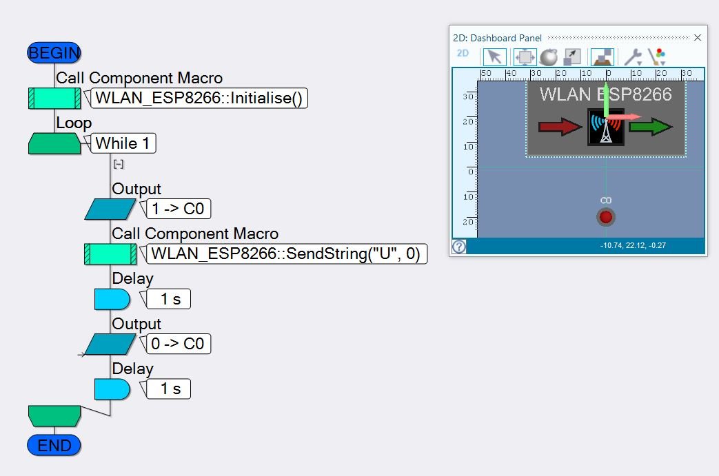

Good evening! I really liked your phrase about tires and gasoline, it's funny, but it often happens in life. I will now attach a program to you where, as you said, the graphs look beautiful, but once again I want to say that there I use the uart module in the program, but I can't get good results with the esp8266 module...
- flash_led_B1_rs232.fcfx

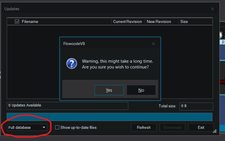

The chart shows exactly what I would expect it to contain, and your crystal is clearly 1.8432MHz.
Can you do the following
Help > Check For Updates and ensure Full Database is checked and then update Flowcode.
This will make sure you are up to date.
Next, using the same "working chart" you just shared, that uses the UART component, can you delete the UART component and replace with the ESP8266 component.
Everything else in your chart should be the same, just replace the UART with ESP.
Once done, can you rerun your test and share the traces and chart?
This will help establish where the issue lies.

Good evening! Unfortunately, there are no changes for the better. There is a signal on the Tx pin, there is no signal on the B1 pin, the LED does not blink. I don't have any new program updates. I tried to change the parameter of the esp8266 module. There is a setting for how commands end, it usually stood \r\n-the signal turned out to be longer than with \r-this can be seen in the attached drawings.
- Properties-Command Terminal-..r..n.jpg (61.7 KiB) Viewed 78931 times
- Properties-Command Terminal-..r.jpg (58.64 KiB) Viewed 78931 times
- flash_led_B1_esp8266.fcfx
- (11.1 KiB) Downloaded 28790 times

Good evening! And here you can see what errors occur during compilation, maybe something is not working correctly?
- error compiler.JPG (86.99 KiB) Viewed 78931 times

When I shared my traces with you I was not using your chip but my chart was pretty much as yours so we can discount the commands. Also I was using FCv10. If I get time I'll try using v8.
As I don't have your chip I cannot test for myself, but from the tests we have done there certainly seems to be a problem. I cannot explain why you are now unable to flash B1 nor why your sendstring is not sending out the correct character. It maybe a "bug" which given that v8 is no longer supported may go uncorrected.
Have you considered upgrading to FCv10? It is free and supported.
You can of course continue to use the UART component instead of the ESP8266 but depending on what you wish to do things can get complicated. Using the UART means you need to send individual "AT" commands and capture and interpret any relevant replies. You will most certainly need a copy of the "AT" commands and have an understanding of how to use them.
Also, to capture incoming data you should look at the RxInt command and the Circular Buffer component and examples as you will most likely need to use these too.
What components do you intend to use in your chart (e.g. UART / 16 x 2 LCD / pushbutton etc)?
