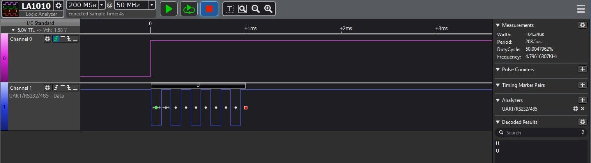

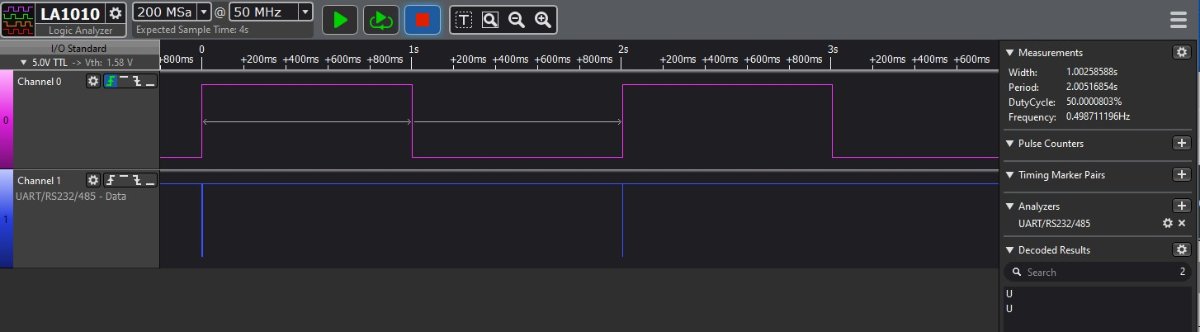

This morning I tried the ESP8266 component with an UNO-R3 which uses a 328P microcontroller.
Same as before, a loop containing a one-second flash and outputting "U" on Tx port.
No issues at all.
So we know that the 328P can work with the ESP8266 component. Hope this helps.

I'm not sure I understand what you mean. These signals are obtained from the Tx pin of the microcontroller (and the pin I designated for flash test).
The microcontroller uses pins D0 and D1 to communicate via it's UART. When you add in a UART component in FC then the component as part of initialisation takes control of these pins.
I did not use the UART component I instead used the ESP8266 component. As this component uses the same Tx and Rx pins as the UART would, it similarly takes control of pins D0 and D1. So now the esp8266 component is using these pins to communicate, not the UART component.
The connections from the microcontroller to the actual esp8266 module use the Tx and Rx pins of the microcontroller and these connect directly to the corresponding Rx / Tx pins of the module.
Nothing else should be in the circuit between them, just direct connections.
Micro -- ESP8266
Tx -- Rx
Rx -- Tx
Gnd -- Gnd

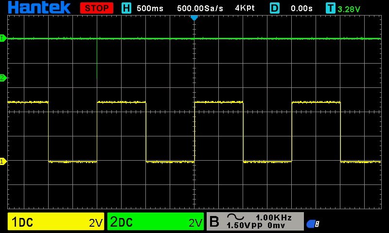

Good evening! You just can't imagine what just happened!!! Imagine it was possible to run the flash led test on the atmega8 controller. The voltage diagrams are correct and the LED is flashing. The program is almost the same: the controller is connected to the esp8266 module, but I decided to check the crazy version that came to my mind-I just initialized the rs232 module in this program. He is not involved in the program cycle yet, you can continue further! I suggest you enjoy the elegance of stress graphs.
- yellow is the flashing of the LED, green is the sending of the letter U_1.jpg (59.7 KiB) Viewed 79361 times
- yellow is the flashing of the LED, green is the sending of the letter U.jpg (60.28 KiB) Viewed 79361 times

Whatever it is you did, keep doing it...
Exactly as you should have. I can only guess that there may be an issue in initialising the esp8266 on the ATMEGA8. A test to confirm would now be to remove the UART and see what happens.
Anyway, you now have working options
Good stuff
