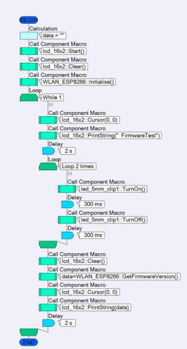

Good evening! Again, nothing worked out, the message with the firmware version does not arrive. After this command, the program seems to hang. I decided to check if this is the case. I put the LED in the program in the old place where everything worked out. From the beginning, I set a flash test after receiving the firmware version-it did not blink in the program! then I put a flash test after showing the message "firmware test" on the lcd screen, where the LED was flashing in the program and in reality. The ESP-01 module was connected at that time.

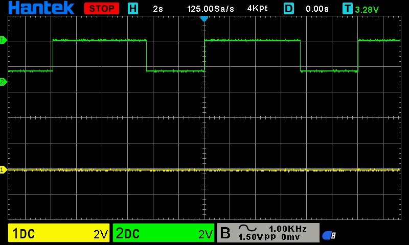

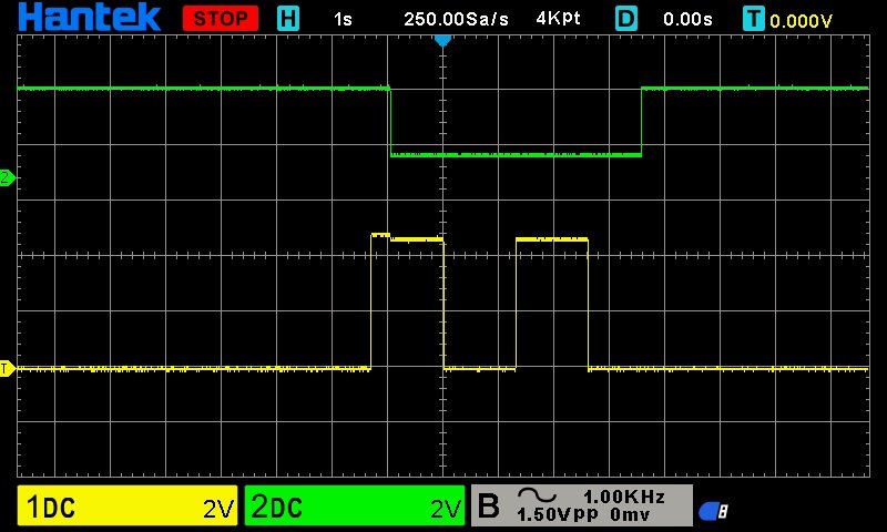

gilanetugila
- Posts: 268
- Joined: Thu Jul 30, 2020 2:01 pm
- Has thanked: 7 times
- Been thanked: 1 time
Re: Download the program for the device via the Internet.
Good evening! 1) When I loaded the program for sending the letter "U" with the LED flashing, the graph turned out to be normal, unchanged (this is if the esp-01 module is physically disabled), if the esp-01 module is physically enabled, then there is also a signal in the form of a meander.
2) I have an initialization of the lcd 1602 display in my program, only it is called "start".ъ
3)I do not have the "send string" module in my program, there is only "CetFirmeWareVersion".
4) the program has the necessary components to display the received data.
5)the transfer rate is 115200 for the ESP-01 module, on the uart module, which is not used in any way, the speed is 9600.
- Atmega8_ESP-01_uart_FirmwareTest_flash_test.JPG (39.28 KiB) Viewed 80023 times
- yellow is the LED, green is sending the letter U when the ESP-01 module is turned on.jpg (66.05 KiB) Viewed 80023 times
- yellow is the LED, green is sending the letter U when the ESP-01 module is disabled.jpg (58.39 KiB) Viewed 80023 times
- Posts: 786
- Has thanked: 187 times
- Been thanked: 205 times
Clearly the UART is doing something as without it you can't get the ESP component to work. I can't explain that.
You scope traces are a bit confusing. In the chart you show that the LED flash is 300mS but the trace shows 1S with the Tx showing a whopping 8S high / 4S low.
Can you send me a rough schematic showing what is connected to where? Perhaps a picture too?
Going back to your chart that works when sending the "U", change baud to 115200 and see what happens. You should still get a "U".

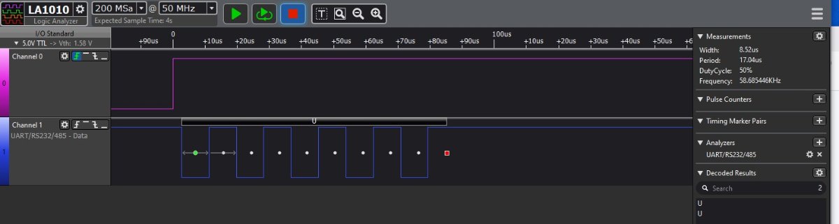

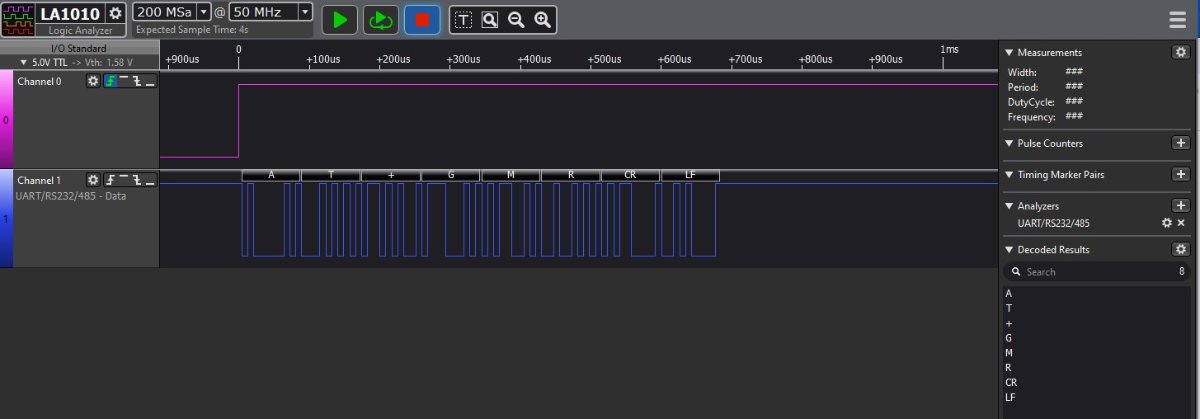

- Posts: 786
Using an UNO R3 (uses a 328P chip) I connected up at 115200 baud. No issue.
Zoom in
I then changed the flowchart to instead of sending a "U" it issued the GetFirmware command (AT+GMR CR LF). No issue there. However do note that as I did not have an esp8266 module connected, the flowchart "hangs" awaiting a response from it.
Zoom
Zoom in
Zoom

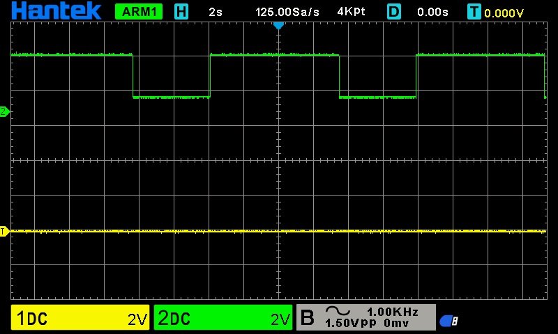

gilanetugila
- Posts: 268
Good afternoon! In all the latest graphs, I try to have the yellow signal of the oscilloscope from the LED, and the green signal comes from the voltage divider, which is connected to the Tx pin of the controller. Now I will try to send a command from the controller to the esp-01 module that you wrote about. But I think it should look different: "AT+GMR\r\n" where the icons "\r\n" mean the end of the command.
Your graphics are beautiful, it would be nice if there was also a decryption of the signals to understand what he is drawing there.
- Posts: 786
When composing and sending a string
\r = Carriage Return (CR)
\n = New Line or Line Feed (LF)
These will be included in what the component sends out.
Your traces show pulses in excess of 4S (low) and 7S (high) so something is clearly wrong.
You mentioned earlier that you had a 328P chip. Perhaps try that as something is very wrong if you need the ESP component AND the UART component to get anything meaningful. This should not be the case.
Also, remember in my tests I am not actually connected to the esp8266, I'm only connected to the chip pins.

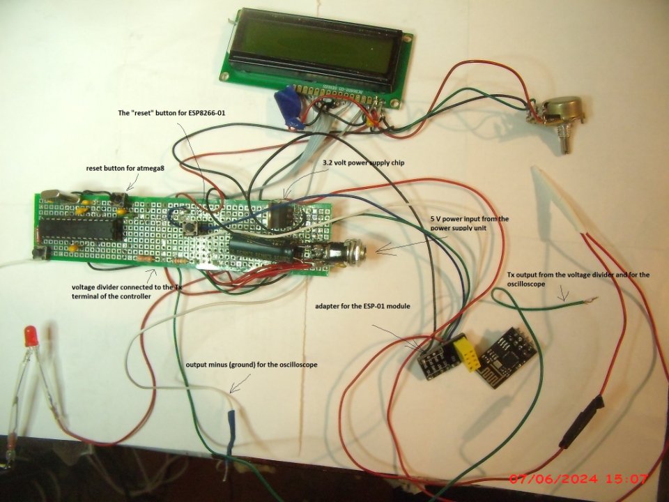

Good afternoon! The attached figures show a general connection diagram without details.
- GEDC2943.JPG (117.12 KiB) Viewed 79976 times
- connecting LCD1602 and LED.JPG (63.56 KiB) Viewed 79976 times

Looking at your schematic, I think the esp "adapter" will be a cause of issues as that has other components on it too.
Only use that when you are connecting the esp8266 to your PC as you did in earlier posts. Don't have it connected at all to your esp8266 when your chip is trying to communicate with the esp8266. It will most likely mess up the communications.
I see you have used a socket for your chip. That's good for many reasons. It means you could very easily swap for the 328P to run some tests.
As Martin mentions, control characters won't display on your LCD.

First diagram is just microcontroller to esp8266 module
Test-1
In this setup you can run your terminal program on your PC (ensure baud is correct) and monitor what is being sent to the esp8266.
Test-2
Same as above but we monitor what the eso8266 is sending to the microcontroller.
Hope this helps.

Good evening! I have now conducted the same experiment, but with the atmega328p controller. Surprisingly, so far nothing has had to be soldered or added, thanks to my mentor
! But the results are just as bad.: 1) does not show the firmware version 2) the LEDs are flashing, they are yellow in the picture.3) rectangular pulses from the Tx output instead of those from the Chipfire, they are indicated in green. 4) The ESP8266-01 module is connected. I will be able to check your versions on Sunday after 1 p.m.
For Martin: so if you just send some word (you had it "Hello\r\n"), then the controller does not freeze and the LED flashes alternately and this message is sent?
- Atmega328p_ESP-01_uart_FirmwareTest_flash_test.fcfx
- (15.94 KiB) Downloaded 28116 times

Now you are using the 328P remove the UART component and all references to it, just leaving the esp component.
Connect your scope to the 328P chip, leave the esp completely disconnected and run the flash test / sendstring "U" test.

I can confirm that the MCU does write the appropriate data to the esp8266 using the component..
So initialise it writes
AT+CIPMUX=0
I then wrote in a loop
AT+GMR using the ESP8266::SendString macro.
But - I tested with the FTDI convertor.
I used hardware channel at 115200 (on 8MHz Atmega8 as before)
I totally failed to get my esp-01 board to work (it spat out a version string followed by 'invalid' at power on)
I tried a d1 mini and that spat out pages of memory dump before the WDT kicked in.
Will have to look back at Iain's info on re-flashing the firmware to the AT compatible mode.
