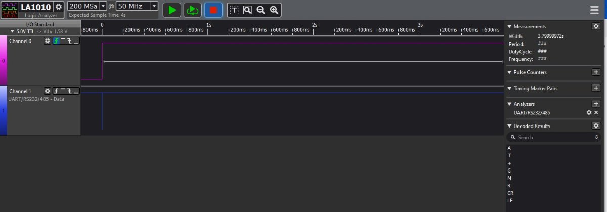

Good afternoon! In all the latest graphs, I try to have the yellow signal of the oscilloscope from the LED, and the green signal comes from the voltage divider, which is connected to the Tx pin of the controller. Now I will try to send a command from the controller to the esp-01 module that you wrote about. But I think it should look different: "AT+GMR\r\n" where the icons "\r\n" mean the end of the command.
Your graphics are beautiful, it would be nice if there was also a decryption of the signals to understand what he is drawing there.

Your traces show pulses in excess of 4S (low) and 7S (high) so something is clearly wrong.
You mentioned earlier that you had a 328P chip. Perhaps try that as something is very wrong if you need the ESP component AND the UART component to get anything meaningful. This should not be the case.
Also, remember in my tests I am not actually connected to the esp8266, I'm only connected to the chip pins.

Now you are using the 328P remove the UART component and all references to it, just leaving the esp component.
Connect your scope to the 328P chip, leave the esp completely disconnected and run the flash test / sendstring "U" test.
