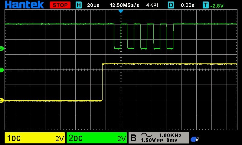

Good afternoon! I have now conducted an experiment based on your recommendation: I removed the uart module from the program, disconnected the esp-01 module from the board, the program text is LED flashing, and the letter "U" is sent inside. The program was running, the LED was blinking. In the attached drawings, the LED flashes in yellow, and the letter "U" is sent in green. But sending the letter "U" by signal looks like sending the letter "U" by the uart module-several identical pulses.
Respected "chipfryer27", you sent me the file "Test connections.pdf" so that I could check your offers on the board using atmega 8-is this offer valid? and what to do next on atmega 328p-?
- Atmega328p_flash_led_test_send_U.fcfx
- (11.49 KiB) Downloaded 14843 times
- dso_01_01_00_07_48.jpg (61.57 KiB) Viewed 50628 times
- dso_01_01_00_10_48.jpg (60.81 KiB) Viewed 50628 times

It's good news that you now have the chip working as expected, and yes, the test diagrams I sent work for all chips, not just the Mega8.
A big thanks to Martin for taking the trouble to set up and test with a Mega8 and establishing the limitations of using it.
The tests were to help establish what was going wrong, but as you now can send only using the esp component then you can just "keep them in your pocket" if you have further trouble.
Having the USB-TTL adapter connected to your PC (running Terminal at correct baud) with a "jumper wire" from it's Rx going to wherever, is a great way to monitor whatever your chip is sending or receiving.
I'd suggest you get some practise with that. Perhaps connect to your chip Tx and send the "U" and see if you can receive it in your PC, then perhaps create another test string and see if you can capture that too.
Being able to monitor as I describe is a great way to ensure things are being sent / received correctly and learn about sending and receiving data.
You should receive the following if connected to Terminal as every second another U will be added (example shows after four seconds)
UUUU
If you then change FC to send "U\r\n" instead of "U" then you would receive the following (again after fours seconds)
U
U
U
U
The difference is we now send Control Characters too, which tell the receiving program to return to the beginning of the line and move to the next line. This combination of control characters are very important as many devices will only act on the data when these are received. As Martin mentioned above these hark back to the days of "Teletype" and are still in use today as "if it ain't broke don't fix it"

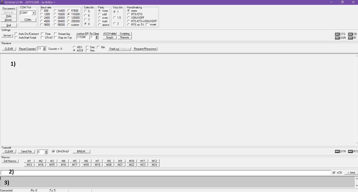

Good evening ! Today I will try to add a usb-ttl adapter to the test and read it using the terminal program. Do I need to insert an esp-01 into this module, or do I need to connect the wire from my controller to the Tx pin to the Rx pin of the usb-ttl adapter? and do I still need to connect the "-" adapter to the "-" of my board, where the controller is connected? The signal levels match or you also need to use a voltage divider. Martin wrote that he managed to get firmware data using a similar adapter, but you also did it at the very beginning of the research, and this does not prove anything that the atmega8 chip is bad, it just may be necessary, as in the experience with spi, to use registers or inserts in c. But we want to get the result using FC software. Interestingly, the modules of the FC program (uart, spi and others are the same for different controllers or are they different?!)After reading the code of what these modules consist of, it will be possible to understand whether in our case it is worth using the atmega8 controller-since the code consists of the c language and registers, but the registers for pic and avr controllers are different!

If you re-read Martin's tests, they suggest that the Mega8 is not a suitable chip to use for anything other than basic UART comms, which prohibits using the esp component. It is a bit like wanting to sail across the Atlantic but you only have very small rubber dinghy......
Flowcode is target independent, meaning you can use the same code with multiple chips (only needing minor changes to suit).
Using the 328P is the way to go, and also consider using FCv10. It really isn't worth the trouble trying to make the Mega8 work when you have the 328P. Once you learn more about using the chip with the esp8266, AT commands and protocols you may then wish to go back and experiment with the Mega8 but for now we should just stick with the 328P.
To connect you PC to your chip, simply connect the following using jumpers
Chip (328P) - USB-TTL Adapter
Ground (0v) -- Ground (0v)
Tx -- Rx
Remember to have the same bauds
Tx -- Rx

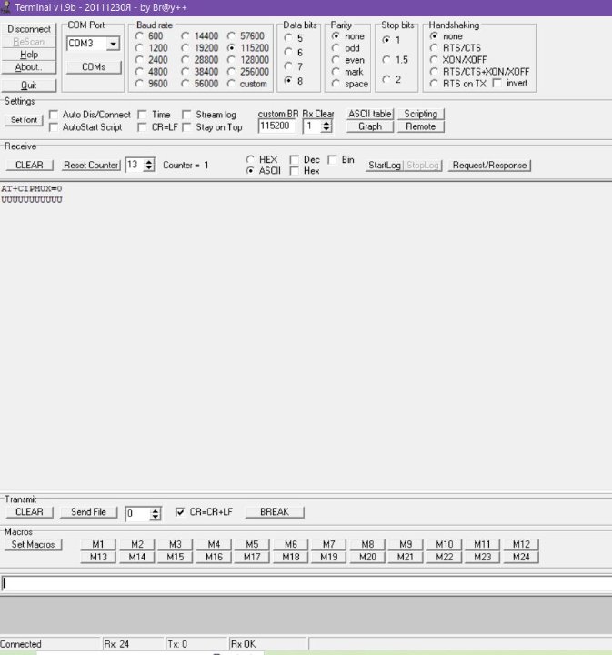

Good evening! Now I tried to read the parcels of the letter "U" from the controller using a usb-ttl adapter and the terminal program-nothing happened, the signals go on the oscilloscope, and the terminal program window is empty. I checked it several times -I connected the esp-01 board to the adapter, checked the firmware version, the port determines correctly, writes the firmware version. And the letters "U" cannot be seen in the terminal window.
- Atmega328p_send_U.fcfx
- (10.25 KiB) Downloaded 14839 times

In the long term, it would be better for you if you had a USB-TTL adapter similar to this
https://www.amazon.co.uk/PL2303-Convert ... 06&sr=8-10
The one you have is designed to accommodate an esp module. I can only guess the connections with it and it may not work as I suspect. If I remember correctly though you "proved" the adapter by looping the Tx pin to the Rx pin and sending out some data from your PC, so it should work.
Refer back to getting the looped adapter working, then connect the adapter Rx to the Tx of your chip. Don't connect anything else yet as we need to take things a step at a time.
Did you remember to set the correct port and click on "connect"? Wouldn't be the first time I forgot....

Good evening! I connected my board and the Tx controller pin on it to the Rx adapter pin and connected the minus of the board and the minus(ground) of the adapter. I checked the connection with a tester, the connections are working. After I turned on the terminal program in which area (they are numbered) Should I write and send it? If I write something and send it to area(2), then I will receive a response in area(3), but this also works when nothing is connected.
- windows terminal.JPG (63.21 KiB) Viewed 50536 times
- Posts: 786
- Has thanked: 187 times
- Been thanked: 205 times
Re: Download the program for the device via the Internet.
I would double check you are actually on Com1. Clicking the arrow beside will give you all options.
Once you are sure you have selected the correct Com, click on Connect.
Then whatever you type in Area 3 should appear in Area 1.
If you type in area 2 it won't be sent until you click the "send" button to the right of the area. Then it will appear in area 1

Good evening! Imagine -it turned out without any installation of drivers and programs. I sent the letter "U" from the controller, but the LED was flashing along the way. This was displayed on the terminal window. But it is necessary to remove excess from the forum anyway and I will be a little distracted by other tasks-unfortunately, the time and price window of opportunity to get the necessary part is not great. But not for long, from 2 weeks to 2 months. I'll write to you in person later, if you don't mind.
