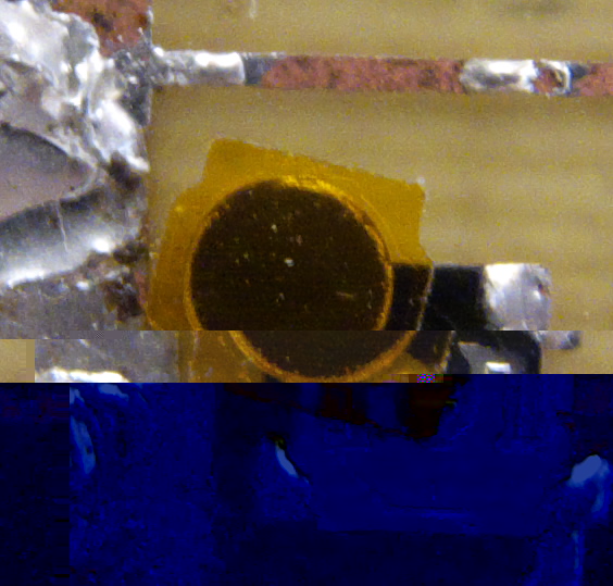

Hi to all.
Just burned my camping light out.
I use some of these very flat tactile switches without a button, just bare foil, or whatever you can call it.
The metal part jumped off onto the voltage regulator and made a short. (it looks like you can not use them push them directly with your finger.)
I have two boards, one with the switches, and the pic. From there is a three core cable going to the Board with the LED's and current regulators.
On the PWM line going to the Cat4104 regulator I have a resistor and a 5.1volt zener diode for protection. Also on the board with the LED's it has its own voltage regulator for the supply to the Cat4104 current regulator.
That the voltage regulator on the board of the switches burned out I can understand.
But it also did quite a bit of damage to the board with the LED's
78L05 regulator is burned out and at least one of the current regulators.
So I just wonder what additional protection I should make.

Ahhaa.. :(
Can you please post a schematic of the system to understand clearly..so that we can suggest you for more protection.
To avoid shortening I think it would be good if you could post couple of pictures of component orientation in zip...to help us visualize the condition and try to help you.

Hi Enamul.
The shortening is just because the membrane from a tactile switch jumped off unto the regulator. So we can not blame the circuit for it. The question on my mind is why it did damage to the LED board.
See schematics:
I just added a picture of the broken tactile switch.
It looks like this type is not suitable for being pushed directly by hand.
Tactile switch3.jpg (183.05 KiB) Viewed 22299 times
The yellow part jumped on the voltage regulator.
