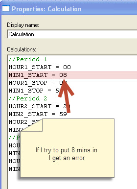

Hi Enamul,
I don't know why it does this but if I try and put 08 mins in the periods I get an error, is that causing anything ?
thanks

Re: 24 Hour Heating Timer for RTC MIAC
Post by Enamul »
You can ignore the problem by just putting "8" rather putting "08". I have noticed this issue too. I have to ask Jonny why is that happening.

Ahhh right
that explains it Enamul, you have done away with the canbus as that is only needed to communicate with the MIAC.....
thanks
Acestu

Hi Enamul,
Yes it is all working now thanks and I have tested the time periods etc... :D
