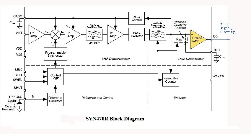

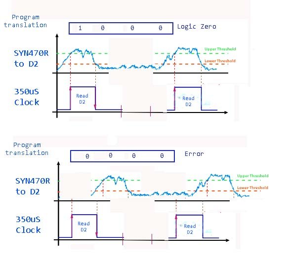

I have check the rxb12 433mHz receiver (again).
Looks like the SYN470R chip Automatic Gain Controller output level should be pulled down or up before receiving the ttl data.
I tried both ways. If D2 by setup = 0, no input at all.
If D2 by setup = HIGH, it works (with RCSwitch library).
Some people solder the low pass RC filter, etc, but as I understood only Schmidt trigger clean up noise effectively.
From the manual:
During quiet periods (no signal) the data output (DO pin) transitions randomly with noise. Most
decoders can discriminate between this random noise and actual data but for some system it does
present a problem.
There are three possible approaches to reducing this output noise:
1) Analog squelch to raise the demodulator threshold
2) Digital squelch to disable the output when data is not present
3) Output filter to filter the (high frequency) noise glitches on the data output pin.
The simplest solution is add analog squelch by introducing a small offset, or squelch voltage, on
the CTH pin so that noise does not trigger the internal comparator.
Usually 20mV to 30mV is sufficient, and may be achieved by connecting a several-megohm resistor from the CTH pin to
either VSS or VDD, depending on the desired offset polarity. Since the SYN470R has receiver AGC
noise at the internal comparator input is always the same, set by the AGC. The squelch offset
requirement does not change as the local noise strength changes from installation to installation.
Introducing squelch will reduce sensitivity and also reduce range. Only introduce an amount of
offset sufficient to quiet the output. Typical squelch resistor values range from 6.8MΩ to 10MΩ.
My rxb12 receiver has Dout connected to CTH pin (both pins are connected), so I have no way to use this CTH pin to deal with noise.
I tried to use a button (in software) connected to D2.
By using button function ReadState I could stop constant reading of d2 noisy input, but only one program handles the signal with noise, it is Arduino library RCSwitch. As this library is based on other Arduino libraries and as RCSwitch uses some not available if FC8 functions, I didn't spend too much time with it.
Will try to solder a Schmidt trigger (somehow) to PCB next week.

present a problem.
- block_diagram_1.jpg (72.3 KiB) Viewed 162175 times

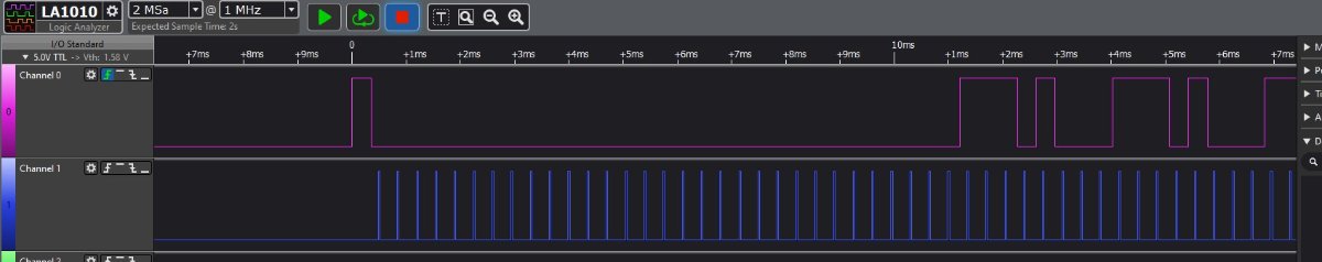

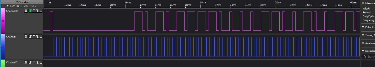

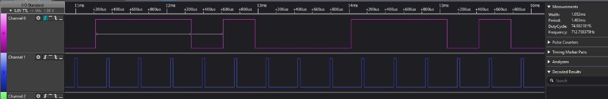

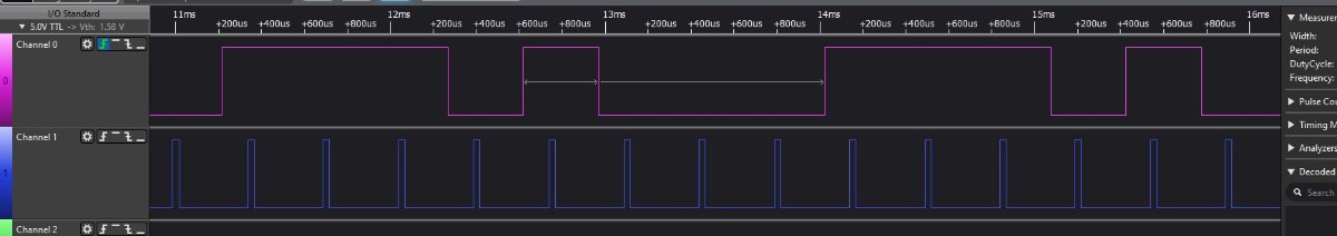

As mentioned earlier, an alternative may be to sample.
The shots below illustrate the concept and instead of actually sampling I have just toggled a pin high/low to illustrate where sampling could take place. Of course chip speed would be a major factor in actually doing this (I was using a PIC @8MHz) but I'm sure you get the idea.
I used the generator of last week and this is shown as CH0. It is connected to an IOC pin.
When triggered the ISR disables IOC and enables a Timer Interrupt of 350uS. This ISR toggles Ch1 (but could be sampling). Clearly very simplistic, but does illustrate nicely.
Datastream
Preamble close up
"One" close up
"Zero" close up
If you were suffering from random noise, say going high unexpectedly, then it would need to occur at the exact time of sample to be of any effect. We sample / toggle once in every 350uS which is a time period for transmission, and therefore 4 x samples captures either a 1 or 0. Processing later would identify which (including preamble / valid data etc).
Sorry to be brief, and hope this may help.
Datastream
Preamble close up
"One" close up
"Zero" close up
viktor_au
- Posts: 367
- Location: South Australia
- Has thanked: 45 times
- Been thanked: 63 times
Re: HC-12 433 mHz module + Ard + Kerui PIR
As I understood correctly:
- if state of D2 pin changed
- disable IOC (D2)
- start 350uS timer
- enable IOC
- wait for pin D2 change
- disable IOC
- measure the duration
Is it correct?
- disable IOC (D2)
- start 350uS timer
- enable IOC
- disable IOC
Is it correct?

Sampling
Please correct me, but I understand the sampling way as receiving TTL data by using 350uS clock. If clock runs the tick every 350mS the program should count raising/falling edges of coming TTL data, organise them into one bit, distinguish logic zero from logic one and save data to buffer.

Sampling

"Please correct me, but I understand the sampling way as receiving TTL data by using 350uS clock. If clock runs the tick every 350uS the program should count raising/falling edges of coming TTL data, organise them into one bit, distinguish logic zero from logic one and save data to buffer."
In sampling we aren't trying to detect a rising / falling edge, instead we just need to know that at the time of sampling is the signal high or low? If you look at the traces earlier, we sample within a time slot not at the edge. If say a one (High, High, High, Low) then at any point in each of the four time slots we should either return a High or a Low. This is the value we store for processing. Say we sampled in the middle of the time period:-
<-- 350uS --> <-- 350uS --> <-- 350uS --> <-- 350uS -->
< -- High -- > < -- High -- > < -- High -- > < -- Low -- >
Sampling in the middle of each slot would return 1-1-1-0
If each sample was stored in an array we could then have as say Address[1,1,1,0,1,1,1,0,1,0,0,0,1,1,1,0.........etc]
One we have received the entire message we can process and it would be easy to turn the captured data into bits (1-1-1-0 = 1 / 1-0-0-0 = 0). Ignoring the repeated message part for just now, the Preamble+Address+Data is 128 time slots = 128 samples. Each "bit" is four time slots in length so after processing we would be left with an 8-bit Preamble value, a 20-bit Address value and a 4-bit Data.
All processing takes place after capture, but it could start to process between samples if the processor was fast enough.
As Martin mentioned, it's more likely you will have a random high glitch (but could be low) and this would need to occur exactly when we sample to be noticed.

The comparator is part of SYN470R chip.
Re: High, Low, Error?
Synchronisation
The ideal synchronisation between the clock signal (read D2 timing) and the incoming to D2 TTL data is when the program can output logic Zero or One.
Not very ideal situation
D2 is not synchronised and distorted TTL signal is not square ended, but top rounded.
Error would be normal.
Error handling
It should be a mechanism or Error detection. If Errors detected program should go back to Idle state.
As you wrote: . Instead of h,l,l,l,l......etc you returned h,h,l,h,l...... would you reject this message entirely?
Preamble 350uS start pulse
I can guess, but the first 340uS preamble pulse would be lost easy in the noisy rounded ttl signal. We should let program to go to Error state, wait 350*32 + 24 bit ((4*350)*24) or wait 11200+(1400*24 +33600)=44800uS or 44-46mS.
After we try to find the 1st 350uS pulse again, if not, go to Error (wait 45mS) and try again.
As transmission repeats the code many times, we finally can find the Preamble and only after that save the data packet.
- Clock350+Pulse_Error.jpg (60.66 KiB) Viewed 162079 times

Sorry to be brief. I've just had a glance at the SYN470R datasheet and see that you can control many aspects including squelch and I also see the it has a Wake pin to signal the presence of a signal.
I thought perhaps the wake up pin could be useful but it activates if RF is present for 128 clock cycles. Assuming you are using a 6.7458MHz crystal then that would equate to 1/(6745800/256) x 128 = 4.86mS. As you only have a 0.35mS "high" it would be useless.
Have you tried adjusting squelch, mode and other parameters etc and if so does it make much of a difference? I assume your circuit is based around the example but adjusted for 433MHz.
I think you need to concentrate on this circuit just now before moving to code.

I think the packet repeated unchanged: Preamble+Address+Data.
SYN470R, 433MHz module
There are different modules with SYN470R chip.
Mine is the cheapest one and the outputs of data and squelch are connected or squelch is deactivated.
Re: need to concentrate on this circuit just now before moving to code
You are absolutely right, chipfryer. However many questions still do exist. Like - why when I use the same rxb12 board with SYN470R chip I have no problems and it works in Arduino IDE (with RCSWitch library) and doesnt work in FC8 program.
That is why I try to figure out what is the key point.
Is it that I try to catch the preamble High?
What if the preamble high already lost?
Should I wait for the frame/packet N3 or N4 to get synchronisation done and only after move to work with data part of this packet?
What is in the RCSwitch library that I don't have in FC8 code?
Let us have a look.

I was thinking...
What if I first check the lengh of the whole packet?
Say, I check the length/duration of packet N1, N2, N3.
Are they the same in milliseconds?
If they are:
try to catch the high pulses only.
If we have 4 pulses per bit, 8 bits in preamble and 24 bits in data, and if one pulse can have only one high (short or long doesnt matter now), we should count one high for preamble and 24 highs for data part. Total we should count 25*4 high's or 24*4 highs if preamble high is lost.
