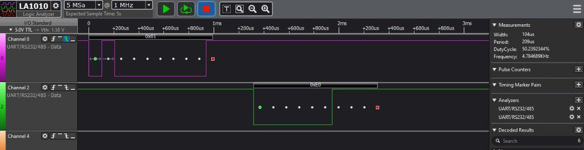

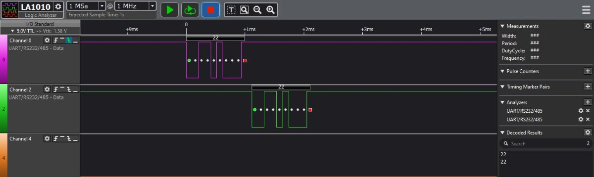

My screenshots are from a logic analyser connected to hardware.
I'll look at the Rx when I get a chance.

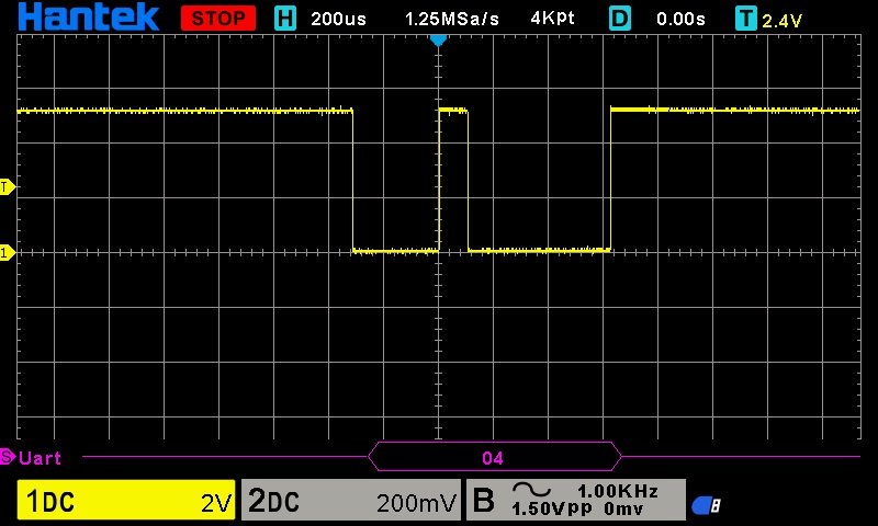

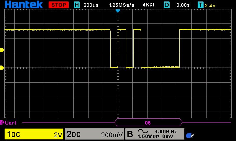

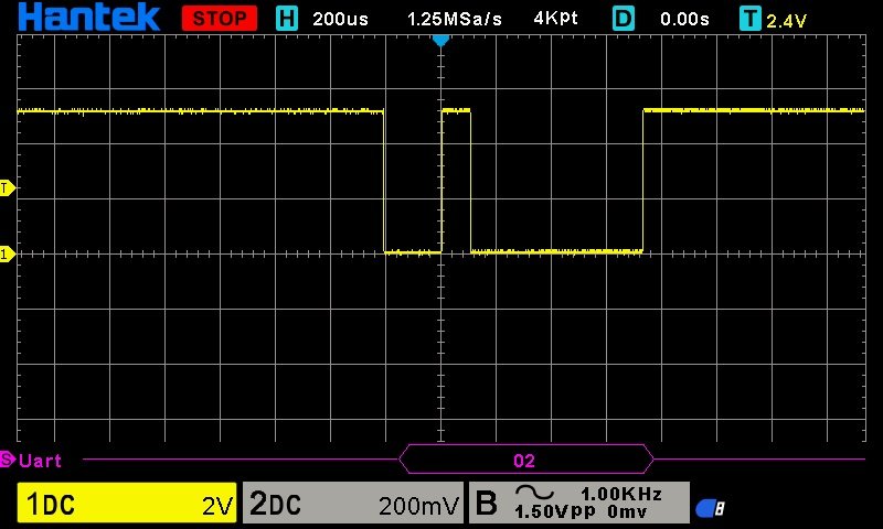

Good evening! I have now turned on the signal decoding function on the oscilloscope. I sent numbers from 1 to 7, there were errors in numbers 2,4,6. But the oscilloscope confirmed that the numbers are being sent normally, there is an error in reading on the receiving controller. I'll continue the rest tomorrow. I made all the drawings in one file, but when sending the quality is greatly lost and nothing is visible. Therefore, I will only send files of numbers that had errors when receiving them. But this time I made a selection from 7 numbers sent.
- send 6 error.jpg (53.96 KiB) Viewed 42805 times
- send 4 error.jpg (54.51 KiB) Viewed 42805 times
- send 2 error.jpg (54.14 KiB) Viewed 42805 times

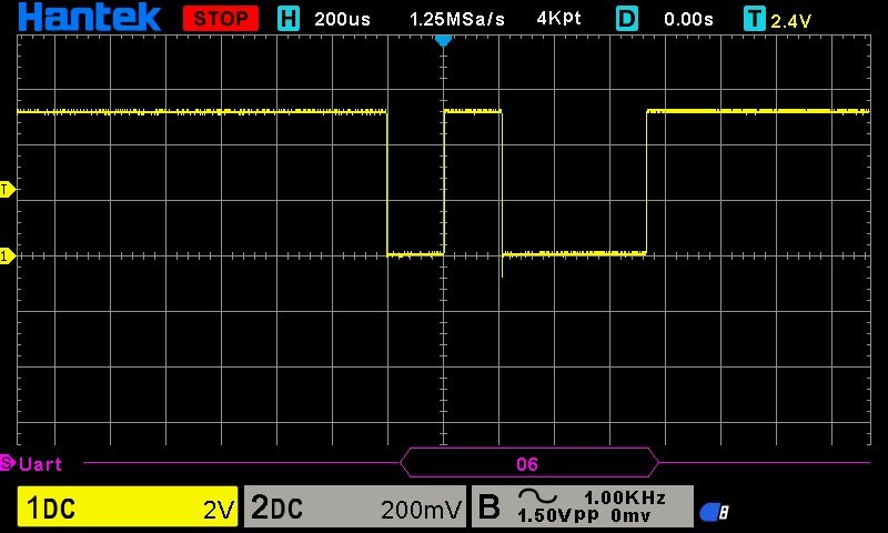

Your send chart increments a counter until it reaches 25 then resets. I had no issue at all in sending these values as proved by both an analyser on the Rx pin and a USB-TTL Serial gadget reading the same values as the analyser.
The / my issue seems related to the Receiver but not sure why yet. Unlikely to be transmission related though.

Good morning! I just looked at the screenshots I sent you this morning and compared them with other drawings where the reception was normal. For some reason, this time, not even numbers were taken correctly, but even numbers incorrectly. I have in my uart settings that it will send 8 bits. The duration of sending odd numbers is the same as even numbers, only the odd ones have a positive impulse at the end and they are shifted relative to the blue triangle at the top of the picture. And it turns out an error in determining the sent number - the uart module misunderstands this additional pulse with the definition of parity-odd. In theory, if the signal for all numbers is 8 bits, then the duration of sending even and odd signals should be the same and start in one place and end in another place. And mine start and end in different places. I am sending screenshots of odd signals (which were determined correctly by the uart bus receiver) so that you can verify this.
- send 5 no error.jpg (55.08 KiB) Viewed 42798 times
- send 3 no error.jpg (54.55 KiB) Viewed 42798 times
- send 1 no error.jpg (53.98 KiB) Viewed 42798 times

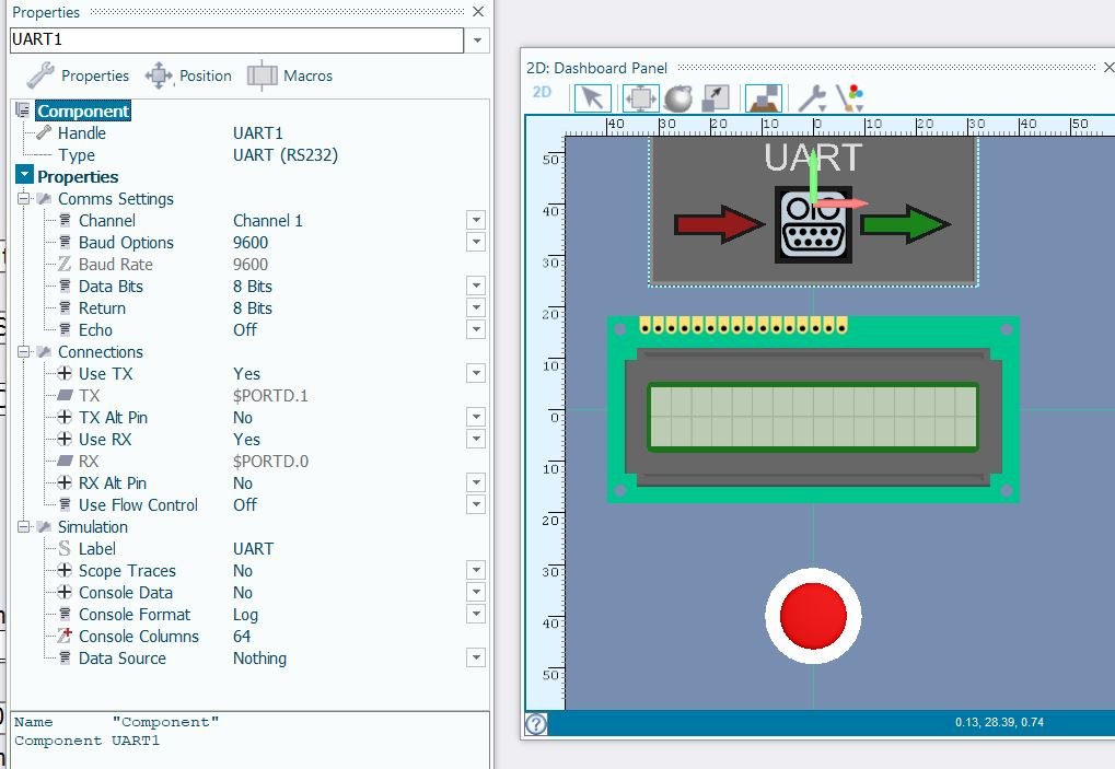

Good morning! I am sending the settings of the uarn module. Maybe there's something wrong with it?
- settings of the uarn module.JPG (96.32 KiB) Viewed 42798 times

Settings are the same for me.
If you look back at my analyser traces you can see a series of "dots" in the trace. A green dot representing "start" bit followed by eight "data" bits then a red "stop" bit for my 8-1-N signal. The dots are added by the analyser to indicate sampling points for the bits and if timings are all OK they should be sampling in the middle of the bits.
RS232 is asynchronous therefore if clocks are "out" and drifting the sample points will over time move from the middle and can lead to transmission errors. However in saying that as each new transmission received in effect "resets" the receiver, i.e. moves the sample point back to where it believes the mid point is, you would need to send a long string of data before drift had any noticeable effect (or severely out clocks).

As mentioned I connected an analyser to the Tx pin (which is also Rx pin of other chip) and recorded everything being sent correctly. However I did notice that on ocassion I got an incorrect value displayed on the receiver.
Today I echo'd the incoming value first by enabling "echo" in UART settings and then by simply retransmitting what was received. The results were not good. I traced the issue to a bad ground connection linking the two boards which in effect had the Rx pin floating. Once resolved the receiver accurately reflects what is being sent.
I can now transmit and correctly receive the value.
In this trace you can see the bit width of 104uS for Tx indicating all good there but the "echo" shows a random received value.
Fixed
So, as mentioned before I don't really see any FC reason your charts are having issues. I read earlier that you will now be transmitting float values so you will need a couple of extra steps to turn your values into Strings prior to sending, then at the receive convert back. When I get time I can give an example.
Fixed

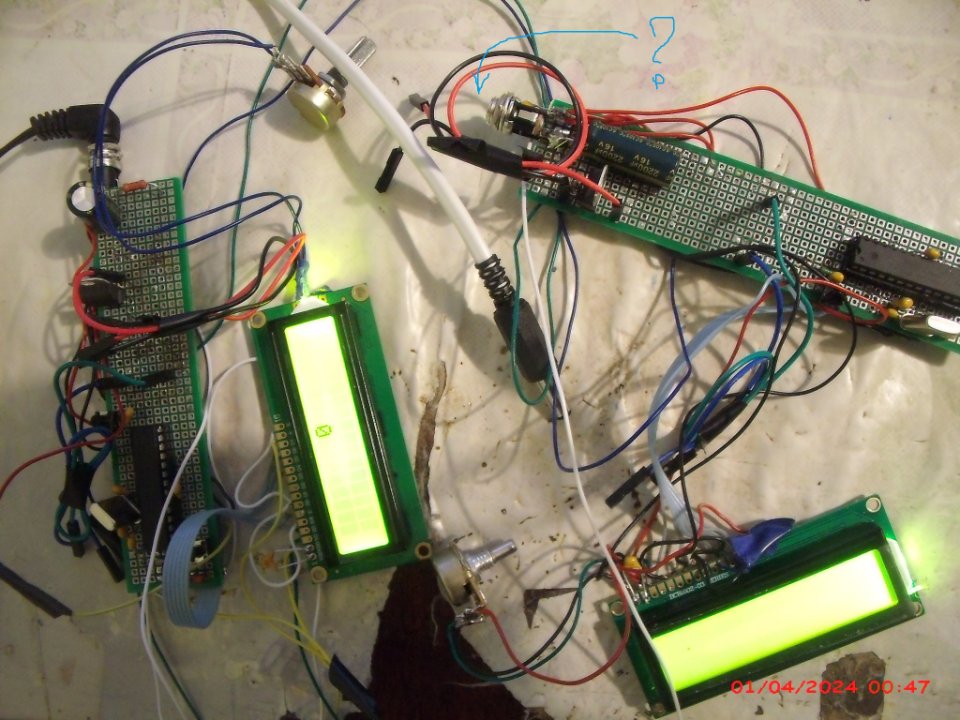

Good evening! You are a great technical wizard! Thanks a lot for the tip with the common land-everything worked almost as it should. Well, the most important thing is that all the numbers came correctly! Well, the effect appeared-it consists in the fact that after connecting the power supply cons of the boards, I have not yet connected the power to the data reception board, but the indicator display is already glowing on it. And if you connect power to the receiving board, then the indicator screen will not light up on the sending board.
It is already possible to walk around villages and towns and show technical tricks...Thanks for the link with the error probability calculator. I didn't even know that there was one, but I thought everything was limited to information from the description. Tomorrow I'll try to start without quartz, suddenly it will work just as well.
- 1.jpg (146.4 KiB) Viewed 42755 times

A small input from me seeing your hardware, try to fabricate a PCB if possible as general purpose PCB need inspection many times, most of the time problems are solved if the PCB is done well.
For coding/programming you will always get help on the forum, Chipfryer is one of them, he is very keen to help.

Totally agree with you regarding a proper PCB vs the "rat's nest" once we know the circuit works. Not everyone has access to such though but free software such as KiCad really helps with layout etc. ProtoBoard / VeroBoard is OK if not too complicated but of course the initial development can be really messy (we have ALL been there and got the t-shirt
Your boards always look very professional though.

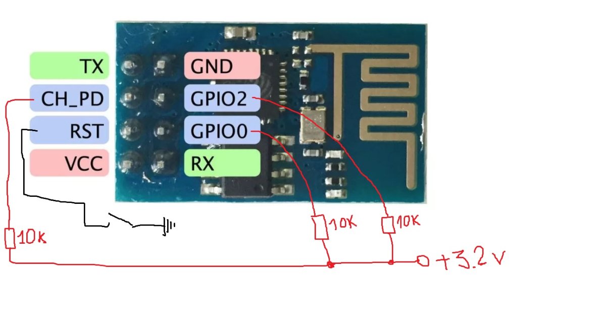

Good afternoon! I have looked at several articles on these modules. Often everything is sharpened under arduino and there is such a complicated discussion that I look at it as a Chinese letter...Well, I realized that in order to check the operation of the esp8266 modules, you need to connect them to a 3.3 volt power supply, I have it! further, if they are connected correctly, certain LEDs should light up, either blue or green or both together. I can see that too. But then they say that you can see that a new wi-fi device will appear in the phone. I don't have such a device. Then we are talking about the fact that initially at the factory the esp 8266 module is configured for frequencies 57600 or 115 200 to work on the uart bus. And then you need to use some kind of program and some kind of device to configure the esp 8266 module. The question is, is this all relevant for arduino or in the flowcode program, you can configure this module by downloading the program from the controller to the esp8266 module. If you have the opportunity, can you explain.
And at the same time, a link to materials on this topic and is it possible to do without any additional devices, or then it will be like walking and searching for a black cat in a dark room?
- Posts: 786
- Has thanked: 187 times
- Been thanked: 205 times
Re: Download the program for the device via the Internet.
Initially it can be a little confusing.
First things first, when dealing with any UART it is extremely helpful to have a USB-TTL Serial converter such as this
https://www.amazon.co.uk/Fasizi-convert ... C98&sr=8-9
The above link is just an example but they really are your best friend when dealing with UART/RS232 and I would go so far as to say essential.
Next up you need a terminal program and there are many free versions such as "PuTTY" or "Terminal by Br@dy".
With the above two items you can "see" what is happening to / from your modules and they make faultfinding / developing so easy.
You don't need a mobile phone, any PC or any device really that has WiFi can be used to check if the module is transmitting. However many modules come with outdated firmware or are incorrectly setup especially if sourced from the cheaper vendors. To update firmware to latest (highly recommended) then you will need the items I described above as you will need to interact directly with the modules. A bit of breadboard comes in very handy too.
All modules I've used operate at 3.3v but are 5v tolerant so you can connect Tx/Rx pins directly to most microcontrollers. If they are a "module" then they will most likely have a 3.3v regulator onboard allowing 5v to power too, but check on that.
Depending on what you read, the default Baud rate (for the RS232 interface) could be 9600 / 38400 / 57600 / 115200 and the only way to tell is to try. Using the above components connect your USB-TTL Serial converter to the ESP8266 and open a terminal program set at 8-1-N. Trying each Baud rate in turn "Connect" and send "AT". If the module replies with "OK" you know you are connected and therefore are well on the way to getting things done. To update the firmware you need a PC and a USB-TTL device. I documented the process in another post and will look it out.
Whilst it is possible to configure the ESP8266 using a microcontroller, it is much, much easier to check settings etc and get them into a known state first by using a PC.
PS
If you follow the link to this post, and further links within, you should find useful info.
https://www.flowcode.co.uk/mmforums/view ... 26#p107726

gilanetugila
- Posts: 268
- Joined: Thu Jul 30, 2020 2:01 pm
- Has thanked: 7 times
- Been thanked: 1 time
Good afternoon! Thanks for the tip and advice, I just started checking yesterday.
with the help of a tester and a piece of paperclip, I found that one seemed to be whole, but no voltage was coming through it. Then I decided to check how the tips of the connecting wires feel in other wires, they were hanging out there. I found information on the web that this may cause problems during testing and startup. I decided that it would be better to have a ration. He began to solder the wires. Here you report that you cannot do without the usb-ttl module, you will have to solder and try the module. I have seen such pads with 8 slots.I hope they won't be hanging out there. Thanks for the explanation. I also found information on some sites that free conclusions should be tightened after 10k to plus. Connect the reset output to the minus via the button. I will attach the drawing, please take a look so that it is correct there. But as I understood it all only after setting up using the usb- ttl module.
- esp-01.JPG (72.53 KiB) Viewed 42410 times
