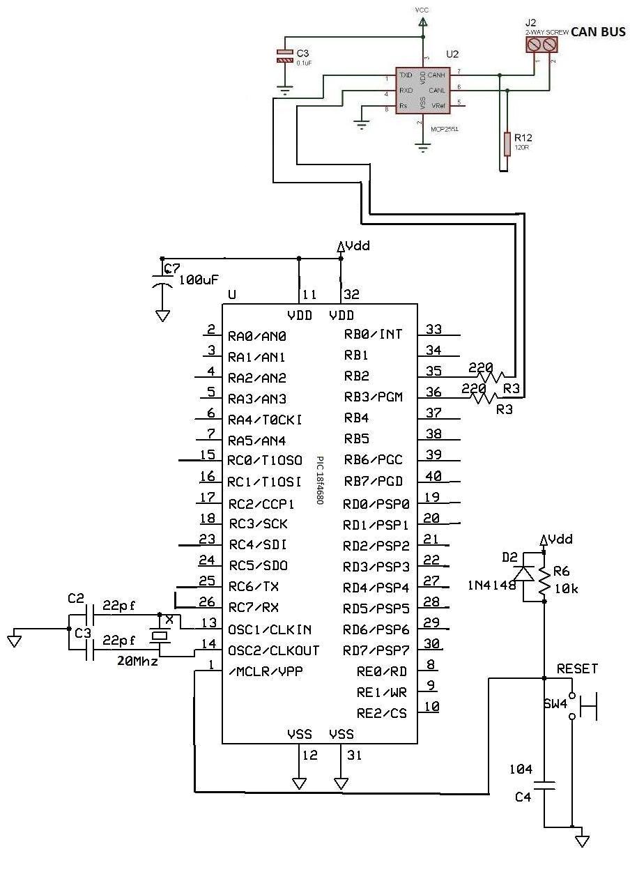

You have to connect the MCP2551 IC for both the PIC..according to the attached schematic. Then you have to connect terminal 1 of CAN bus with terminal 1 and terminal 2 with 2.

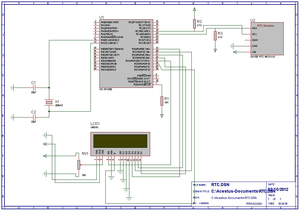

This is a diagram I did of the RTC Module Interface that I did once I got things working, it might be helpful for others...
thanks
Acestu
thanks
Acestu

Here is a the schematic I have from forum...
We are going to use internal CAN of PIC18f4580 which don't use chip select. This is for external CAN and so we are simply ignoring that. We need two connection RB2 and RB3 for CAN connection and those are fixed for this chip.What I meant was: In the Flowcode programs that you uploaded the little graphic can bus says that "Chip Select is connected to port C6 " but on your schematic C6 is not connected to anything.

Sorry Stuart..I have posted the picture with schematic to give you an idea..but you don't need LM35Dz for the RTC project..But it's a nice temperature sensor which might be useful in other project. You can simply put wiper (center of pot) in ADC pin to get a variable ADC value. If you don't have 1N4148, no problem for testing..you can use that in final product.
LCD in the diagram shown in PORTC but I have told I guess earlier to connect it in PORTD for both node..Because you can't use PORTC for LCD later on as PORTC will be used for RTC module. So, this schematic is not according to program I have posted but to give you an idea of your CAN connection..
Collector node is Master and Display node is slave. you can connect LCD for both and connect POT in Master and can see the change of ADC value in slave.

Could you tell me what size the crystals are please , I can't read the schematic it's a bit small...
thank you
Acestu
thank you
Acestu

I have changed the code for 2*16 LCD...20MHz crystal

I am a bit confused, on your schematic you have the crystal on pins 9 and 10, but my datasheet for the 18f4580 says that the osc1 and osc2 pins are 13 and 14
thanks
Acestu
thanks
Acestu

Sorry all these because of editing...my schematic that I post just above the one you are following. you can see xtal should be in 13 & 14..
