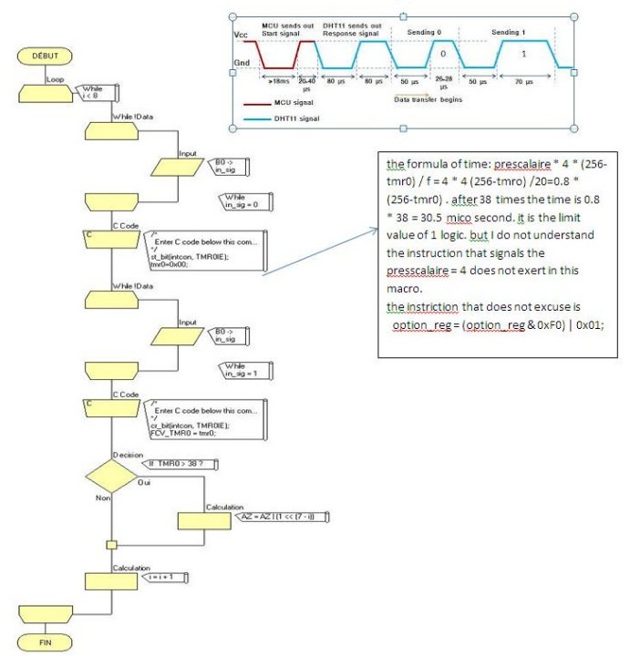

Please have a little help.I have question
(20.0 MHz, the TMR0 increments by 1 in every 0.8 μs (prescaler 1:4)).
without a prescaler =4 in the instruction
st_bit(intcon, TMR0IE);
tmr0=0x00;
tmr0=0x00;

Re: Measurement of temperature and relative humidity using DHT11
What has this got to do with Re: Measurement of temperature and relative humidity using DHT11.benchhida wrote:Please have a little help.I have question
tmr0=0x00;
Not sure what you are asking?
Please do not make public your personal email address.
I do not understand there is not in the program an instriction which defines the prescaler 1/4
thank you
st_bit (intcon, TMR0IE);
thank you
