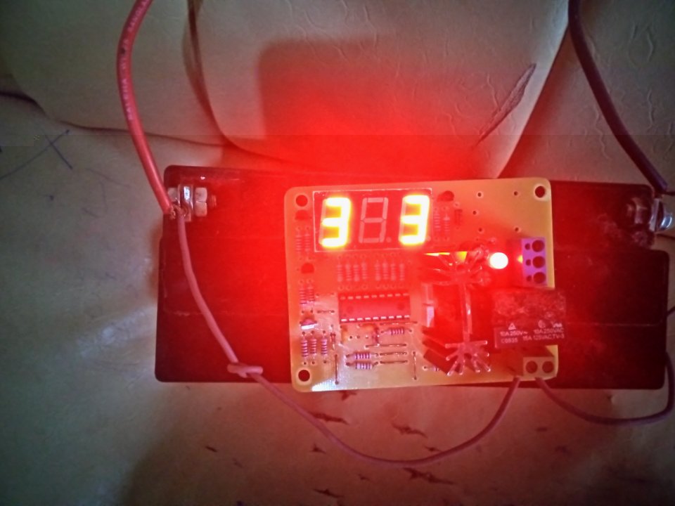

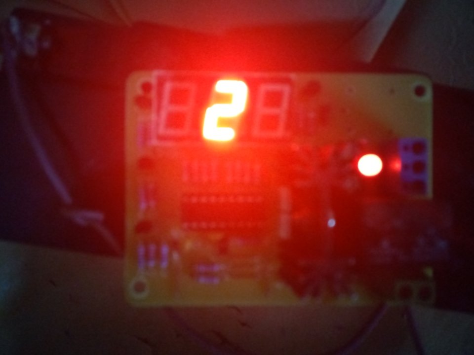

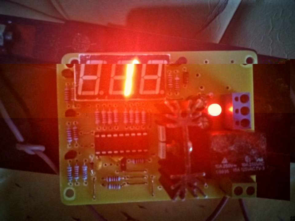

Martin you are not going to believe what am seeing when i was doing the one sec test.Check out all the attachments, in the code i decided to display a 0 and a 1 on Digit0 only in an interval of one sec to work as on and off but to my surprise on the real boad two Digits were lit that is Digit1 and Digit2 yet in code i only enable Digit0 to give me the 0 and 1 in one sec interval WHAT IN THE WORLD IS THIS???

I Can't Spot issues with with your hardware after following tracks of your PCB.
There are a few things to try.
1. Place an additional calculation box with
Voltage = 1.23
in the position shown on the image:
(11.76 KiB) Downloaded 491 times
Let me know what value is displayed.
2. Disable timer 0 so displayed is not activated.
In main, just activate one 7seg at a time with say a delay of 5 seconds.
Set Digit and Value options to the same number.
So you want:
Loop while 1:
7seg0 with a number 0, Delay 5 secs, 7seg1 with a number 1, Delay 5 secs & 7seg2 with a number 2, Delay 5 secs.
Check C & E voltage of all transistors with each of the 7segs activated. Make sure C E of the activated 7seg is less than 0.5V
& the C E of other transistors is near supply volts.
With no power on the board:
3.Check the board for shorts concentration on from MCU pins 1, 6, & 7. & on transistor if did not behave like suggested above.
Just need to use some fault finding skills, changing the flowchart to enable tests.
That is the fun part!

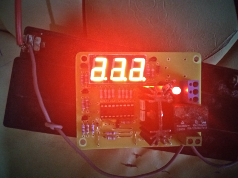

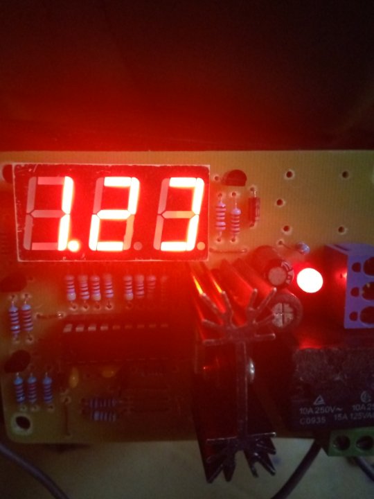

After forcing the output voltage to be 1.23v as you requested i got a funny display as you can see below.
Posts: 9521
Has thanked: 2585 times
Been thanked: 3815 times
Re: Dc voltmeter 0-55v
Looks like could be a hardware issue.
Whats the part number for your display and can you upload the schematic?

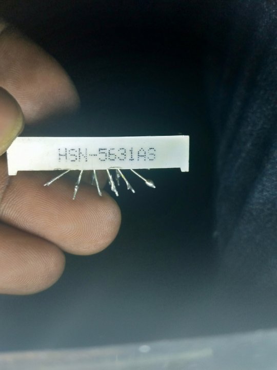

Yes it must be hardware or chip haven't done all the test am going to do test number two now.The 7seg part number is as it appears on the image below it's a common cathode i got from China but i followed all it's letters and commons and they were matching the standards before i put it on my pcb.I don't have the schematic coz when am doing simple pcb like this one i just draw the pcb right away.

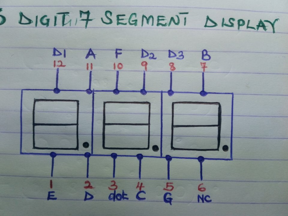

While I was building my pcb this is how I noted it's pins as in the image below this is in my note book.

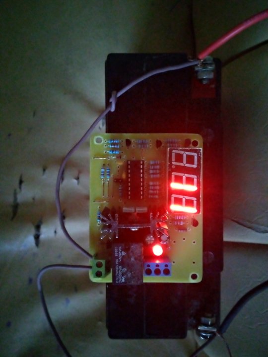

Does it display 1, 2 then 3 on just one 7seg?
Derrihj
Posts: 348
Joined: Mon Jul 09, 2018 12:43 pm
Has thanked: 67 times
Been thanked: 33 times

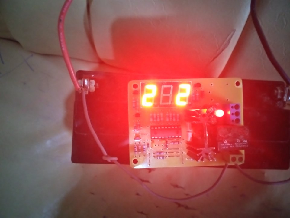

Post by Derrihj »

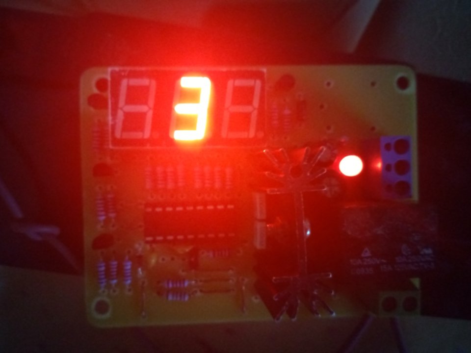

Ok your Test 3 was flashing solid clear 123 at an interval of one second on seg0 and seg2 check the attachment
Posts: 9521
Oh course, transistor inversion of 180 deg.
This should now work middle one only?
If it does, then there is an issue with The 7seg component within flwocode.
If that is the case, I will modify your flowchart to make it work.
Edit: Not a bug with the quad 7seg component- see my post below
Test 4.fcfx
(10.57 KiB) Downloaded 225 times

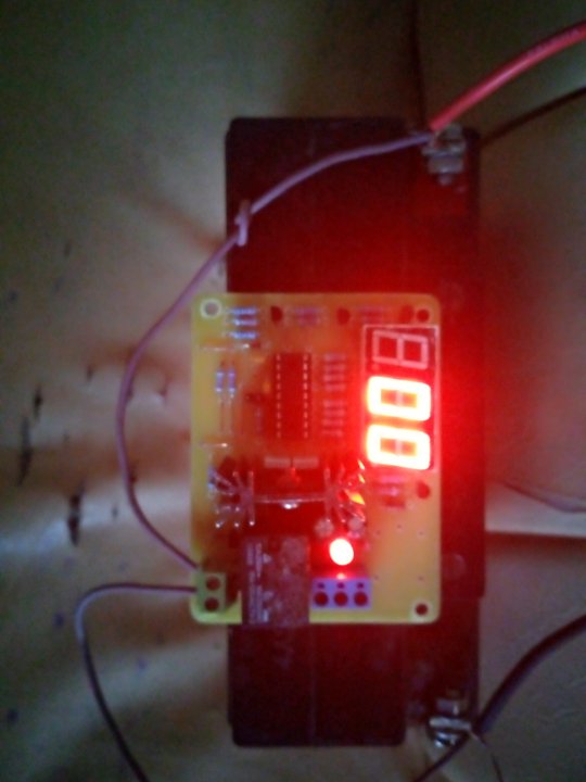

Unless you removed the
Voltage = 1.23
calculation icon, the display should be showing that.
The image looks like 12.2
Derrihj
Posts: 348
Post by Derrihj »
I first tested with voltage = 1.22 the i removed that calculation as i was most interested in the ADC so yes that is 12.2v as for my batery it all worked well am now testing Test5b.

Am done with Test5b it also works but the 3 on seg3 is half way lit it looks like a bracket ].
Posts: 9521
If you go to the TmrMultiplex Call funtion macro.
look for Switch branch for number 3.
It currently shows
port A  = 66
Port B = 80
If you change it so
Port B = 112
, it should then work.
