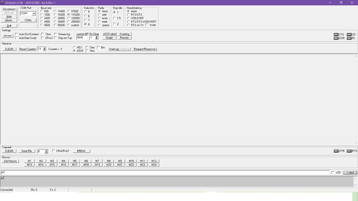

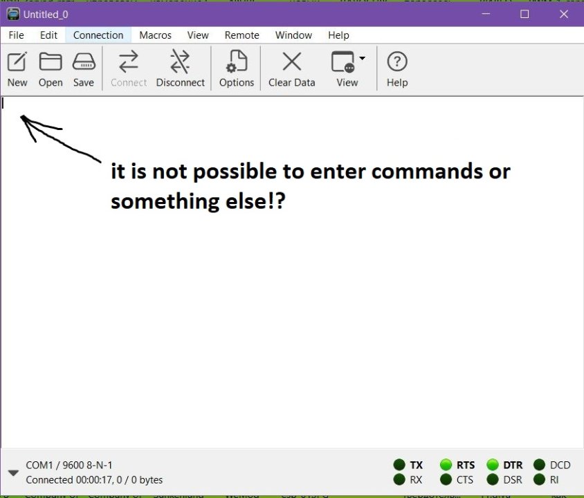

Good evening! Installed the program CoolTerm.exe ? there seems to be a window from where you can send a command to the esp 8266-01 module and check its performance: like sent the "AT" command, and received "OK". I installed the driver, connected the usb-ttl adapter, inserted the esp 8266-01 module into it, the blue LED blinked, the red LED lit up, made a connection in the program, but for some reason they are not entered (and are not inserted) in the windowteams.
the program window.jpg (51.65 KiB) Viewed 39050 times

I'm not familiar with that program but did find a helpful page here
https://learn.sparkfun.com/tutorials/te ... -mac-linux
To check if an adapter is working, connect the Tx pin to the Rx pin. Anything sent will then be returned to you. Once you get that confirmed you can move on to connecting to the module.
Offhand I can't remember the default speed, but I think it was 115200 Baud, not 9600 so try different speeds.

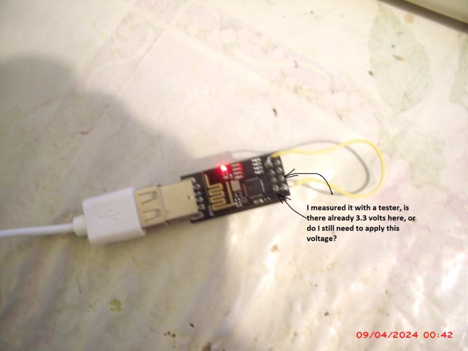

Can you send me a picture of only your esp8266 module, and another of only your USB-TTL serial adapter?

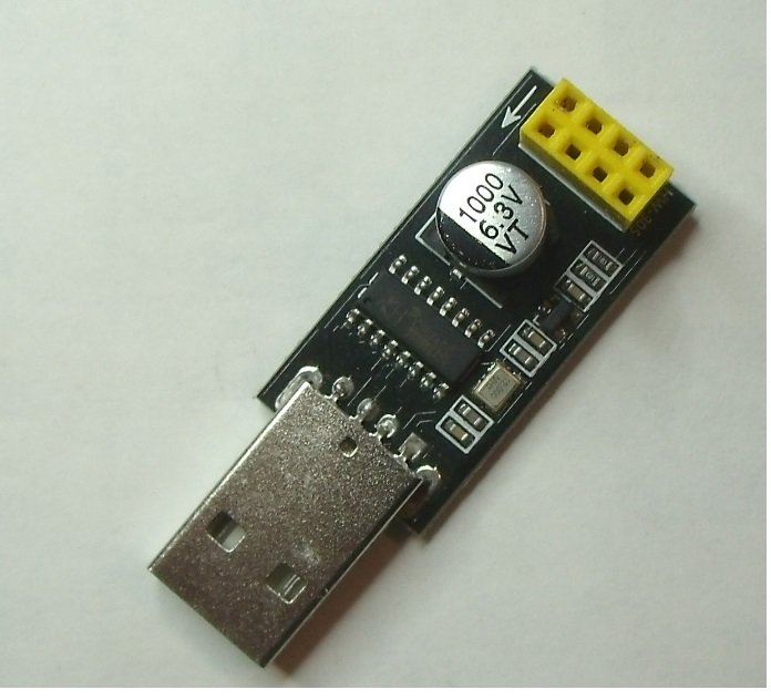

The reason I'm asking for the above pictures is that I'm a bit unsure of your USB / ESP8266 devices. It looks like you may have a "piggy back" USB device that connects to your PC and allows the ESP to just plug in, specifically designed for use with the ESP.
If so, then you would need to first test the USB device without the ESP inserted, with a wire jumper between the Tx and Rx pins of the header that the ESP plugs into.
Pictures of each will make things clear.

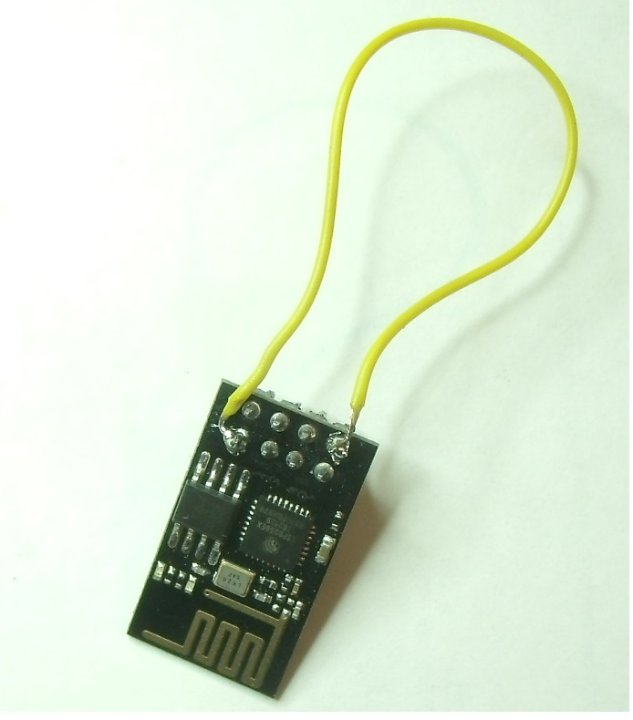

Good afternoon! Yes, you're right, when I bought the usb-ttl adapter, they said that it was just right to work with the esp8266 -01 module. And I'm going to check it now, as you said, by connecting the Tx and Rx terminals with a jumper. Only I have been using such a terminal program for a very long time and I may not send data correctly
USB-TTL adapter for working with the ESP module.JPG (60.88 KiB) Viewed 39011 times
esp8266-01 side view.jpg (22.02 KiB) Viewed 39011 times

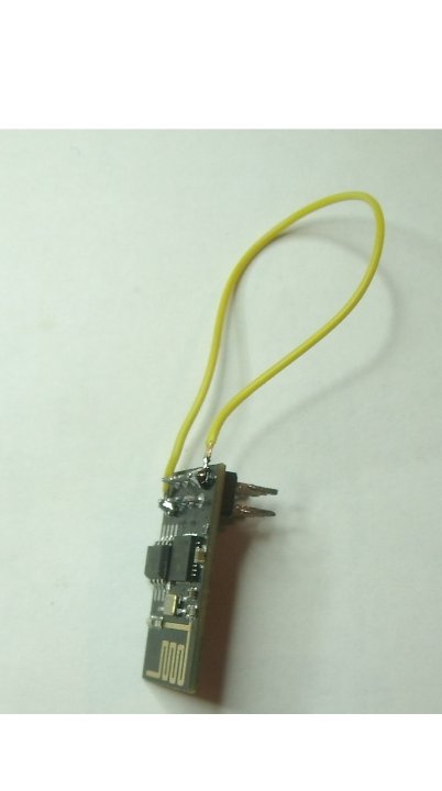

I think Iain meant to connect the Tx and Rx pins on the UART-TTL adapter rather than on the esp8266?

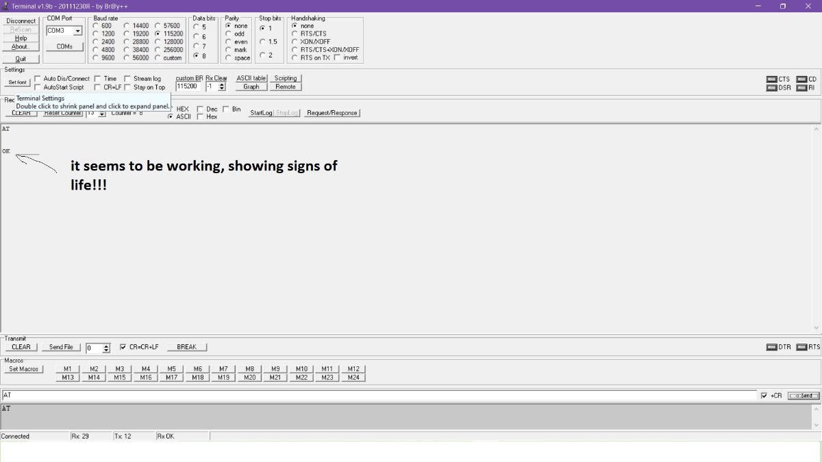

Good afternoon! I just checked the operation of the usb-ttl adapter. Now I saw how it should work, I previously connected the Rx and Tx terminals with a wire. I tried sending at two speeds - at 115200 baud and then switched to 9600 baud.
The USB-TTL adapter is in working condition.jpg (63.16 KiB) Viewed 39006 times

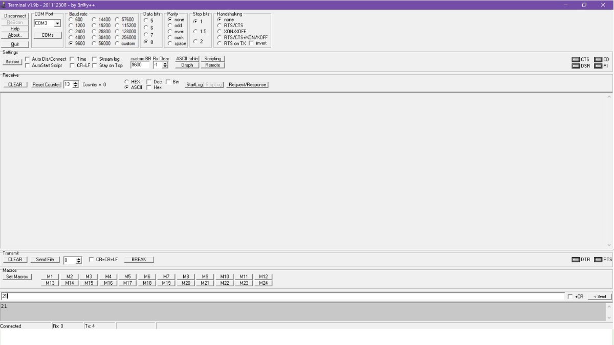

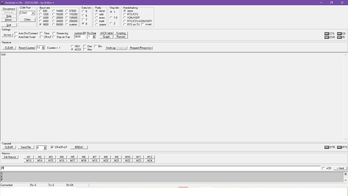

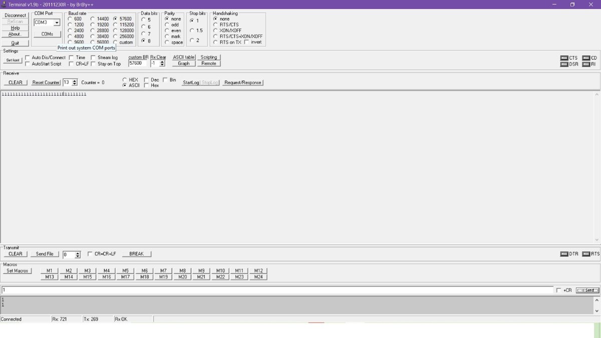

Good afternoon! Now I decided to check two esp8266-01 modules.Before checking, I connected the terminals of the RX and Tx module with a wire. The essence of the check was that on one module I sent the number 1 at different speeds, and on the other the number 2. It turned out not a very beautiful picture. That module, where it sent the number 1, often had errors in the entire speed range, except for the speed of 57600 baud. And on the other module, I sent the number 2, also in the entire speed range, and there were no errors anywhere. So we can conclude that the first module is suitable for operation at a certain speed. But maybe flashing it will fix it, I hope so. I would like to know where to go next.
send 2 , 1200 baud rate.jpg (62.97 KiB) Viewed 39002 times
send 1 , 57600 baud rate.jpg (64.44 KiB) Viewed 39002 times
send 1 , 9600 baud rate.jpg (63.55 KiB) Viewed 39002 times
Posts: 786
Joined: Fri Jun 06, 2014 3:53 pm
Has thanked: 187 times
Been thanked: 205 times
Re: Download the program for the device via the Internet.
Post by chipfryer27 »
Good you are seeing something, but not what's expected and I think it's as Martin suggested.

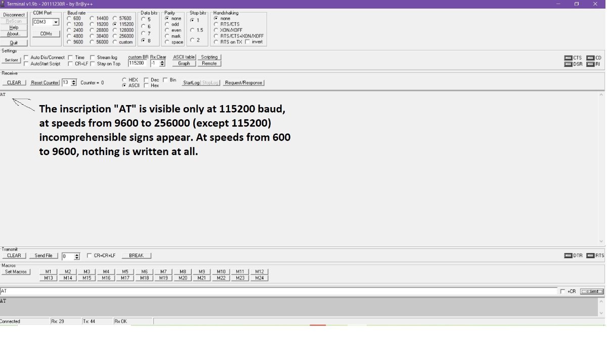

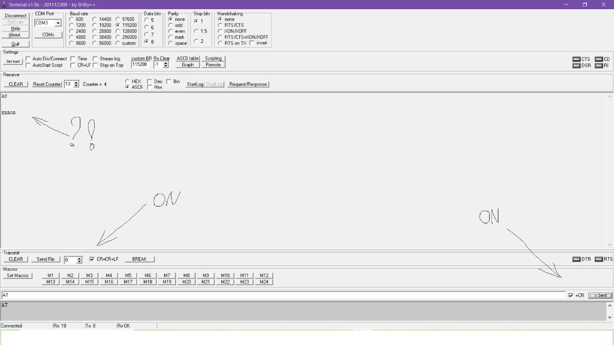

Good evening! I checked both modules at different speeds and sent the AT command. It came either AT , or nothing, or some kind of squiggle. "OK" did not come.
57600 -error.jpg (62.98 KiB) Viewed 38962 times
115200 -error.jpg (62.56 KiB) Viewed 38962 times

I will connect up a module of mine and let you know what settings I have, but it seems something isn't correct with your modules / setup.
From what I see in your screenshots it looks like you have the Tx and Rx pins connected as you are seeing "returns" when you send "AT", however as you only see "AT" being returned at one speed, it looks like the USB device is somehow fixed at that speed. The squiggles you mention are typically seen when speeds are incorrect (Terminal set at x-baud but device set at y-baud.

Good afternoon! I am sending you screenshots after 1 test.

Good afternoon! I am sending you screenshots after 2 test.
Post by gilanetugila »
Good afternoon! I am sending you screenshots after 3 test.

Good afternoon! It seems to me that there is some other firmware that does not respond to the "AT" command and most likely you will need to delete the program from the esp 8266 module and download a new one.

Tests 1 and 2 are perfect, your adapter is good.
Your esp seems set at a default speed of 115200 so we will use that.
In your screenshot (test 3) I see that in Terminal you haven't checked the tick boxes for CR=CR+LF (in the settings just above receive window) nor +CR (just left of send button).
Can you tick these and try again at 115200?

Good evening! The first time an error message came, and the second and subsequent times it came "AT and OK", I tried at other speeds -some incomprehensible signs come.
test3 it seems to be working, showing signs of life.jpg (71.4 KiB) Viewed 38787 times
test3 ticked the boxes(CR=CR+LF and +CR).jpg (68.92 KiB) Viewed 38787 times
