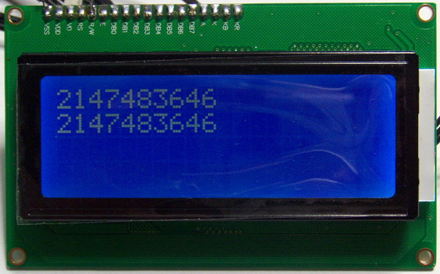

Thank you for your answers this very question. How to split a large number of bytes? Added to my experiment.
2. Storing and retrieving 3byte long variables.fcf
(10.5 KiB) Downloaded 403 times

Here are the 4-byte program.
Tested with Pic18F252.
Data_Out3 Data_Out4 and variable type integer, byte variable error is the result.
Storing and retrieving 4byte long variables V1_1.fcf
