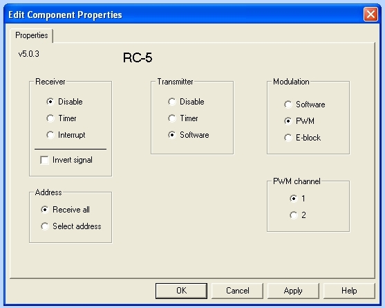

Here the error messages
Here the RC5 properties window and my settings. It should be noted that RC5 compo is compiled and working correctly on FCv4.
Remote Control Handset MINI_v5.c(908:2): error: unknown identifier 'RC5_1_MX_RC5_PWM_C2CON'
Remote Control Handset MINI_v5.c(908:2): error: invalid operand 'RC5_1_MX_RC5_PWM_C2CON'
- RC5properties.jpg (79.24 KiB) Viewed 3680 times
Best Regards FOTIS ANAGNOSTOU

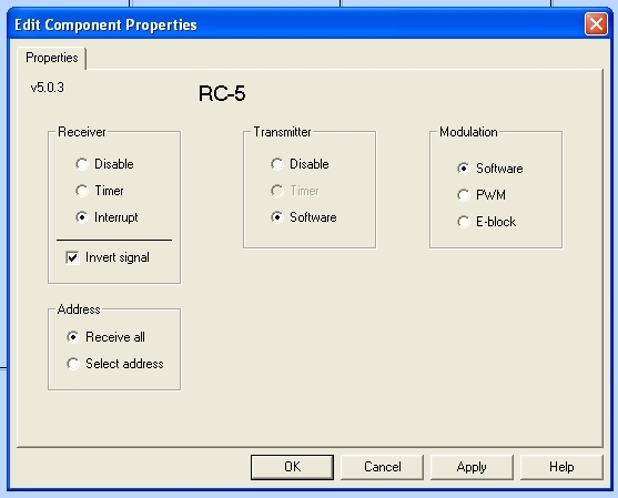

Re: P16F1827 PORTB Interrupt (IOC)
I finally managed to solve the compiling problem on FCv5. It is some odd, but... works!
The only thing that needed, is the activation of... whole the RC5 component. I mean both Receiver and Transmitter. Then the code is compilled on P16F1827 correctly and the project works perfectly on actual hardware. In the attached picture is shown the RC5 compo properties configuration. The only drawback is the loss of RB.0 and RB.1 ports, though no so much worry. For the given project - and for a feature upgrade to a bigger one - all RA.X ports remain available.
I will post the actual project in a new thread, i firstly have to draw the PCB.
- Remote_mini.jpg (79.35 KiB) Viewed 3647 times
